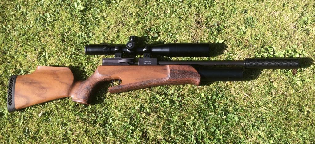

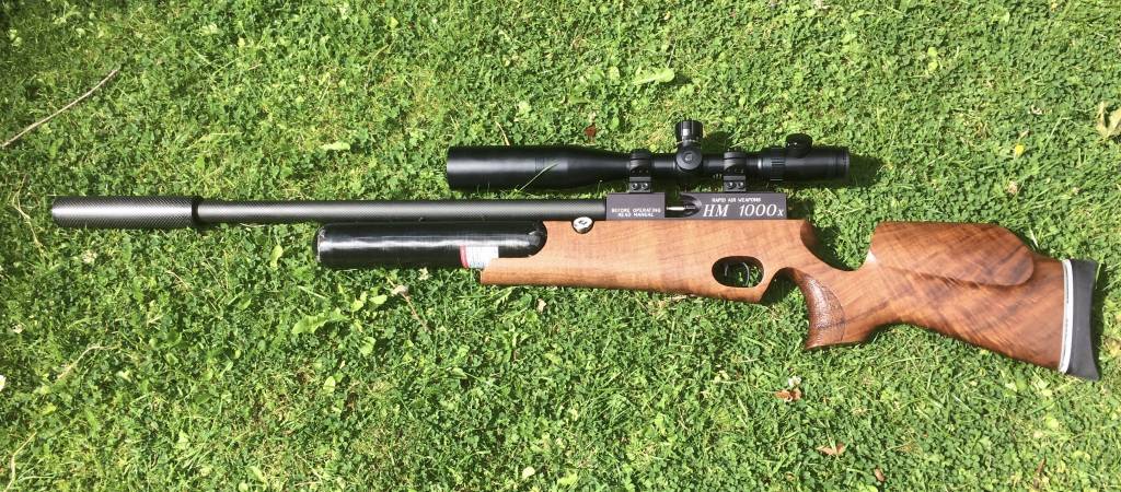

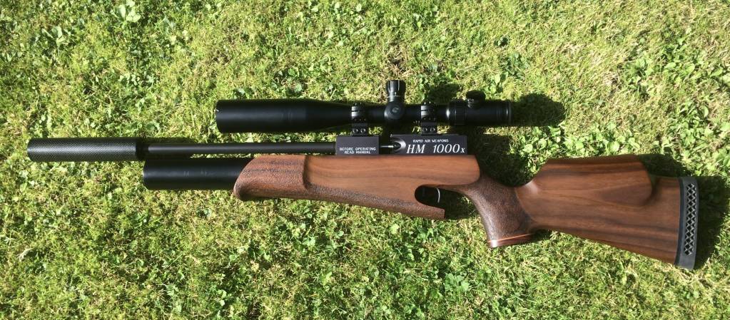

I have been a theoben rapid fan for years but I have had my eye on a RAW for some time now, a few months ago I managed to lay my hands on a nice RAW HM1000x in .25 calibre.
I only shoot sub 12fpe so I have no need for a .25 so swapped out the barrel for a .22 fx stx liner that I modified to fit the RAW, then I fitted a carbon 2 stage shroud, Very quiet, very accurate but despite loosing a fair amount of weight it was still hefty.
t
By chance I managed to acquire a nice theoben MFR stock that I slightly altered to fit the RAW action. Not wanting to cut the stock for a qf a s guage, (i know that some will think I am crazy) I swapped out the RAW reg for a theoben MFR reg, MFR 280cc bottle, (yes shot count is less but still in the hundreds and filling a MRF bottle is no chore) then made some modifications to the internals including better valve, lighter hammer and an SSG device,.While I was at it I fitted a .20 Lother Walther barrel and a custom carbon mod.
My RAW was good before but sooo much better now, smoother, quieter, lighter, shorter, more comfortable and stupidly accurate....I really, really like this gun.

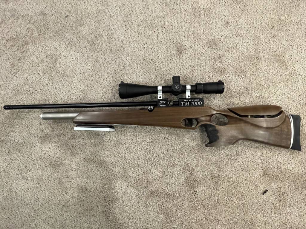

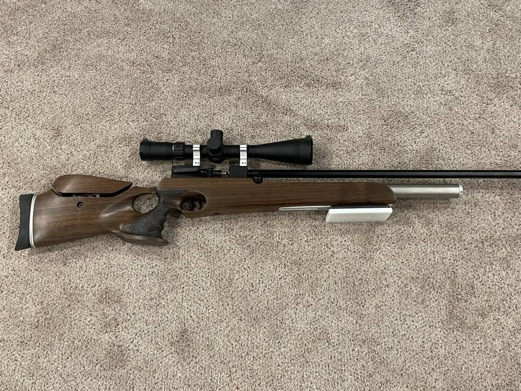

Thought I would let everyone know that I just received my new TM-1000 on the 23rd. And it was built by Martin personally in TN. and shipped by Sandra! This gun was ordered through AirForce with communications between Rachel and Martin personally.
It’s a beautiful Walnut thumb hole target/Ft stock (will take pics once scope is mounted and thru the holidays) Anxious to shoot it!
I know a lot of members are concerned about quality and performance. I can assure you Martin is still the man behind the gun!

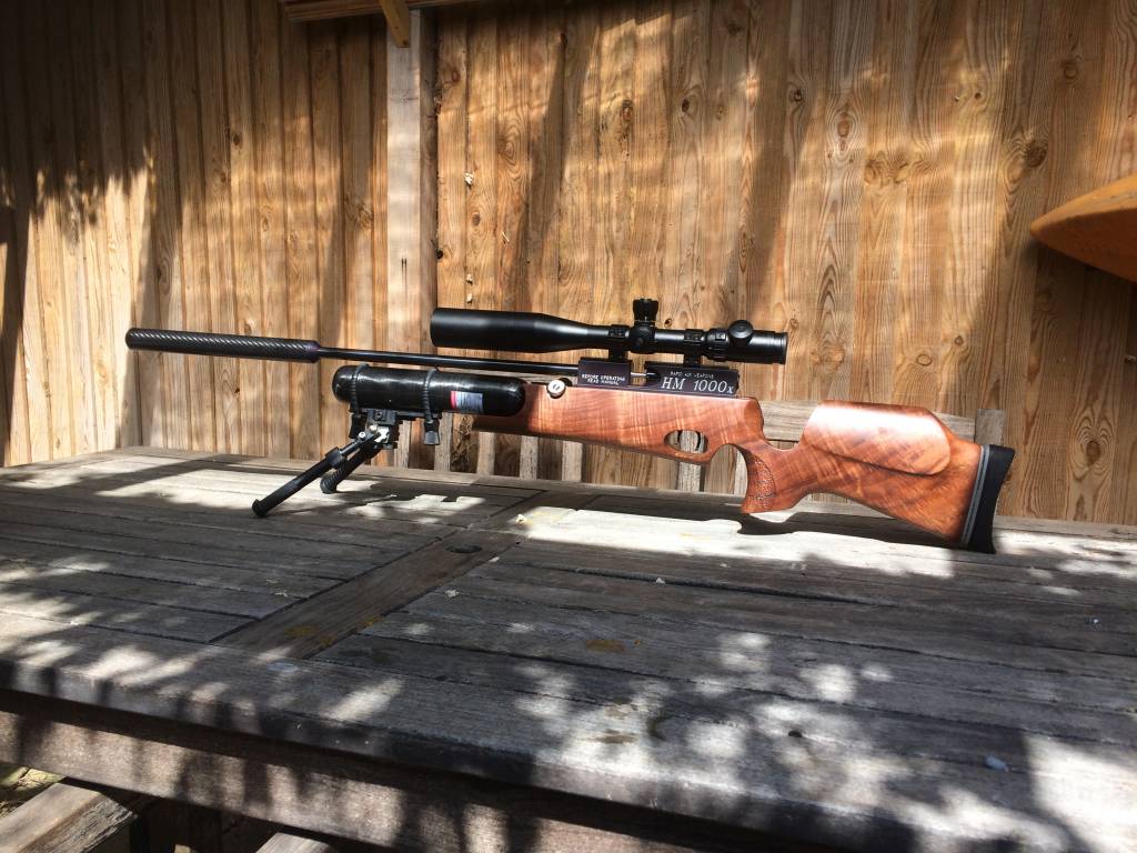

That's great to hear, Nomojo! I've recently 're-invested' in my HM1000X by buying an Alkin compressor, and upgrading the optics from my Hawke Sidewinder FFP to an Athlon Cronus (still haven't mounted it yet). I thought this thread had been deleted or something, LOL. Glad to see everyone's still here...
I should add: I'm pondering adding a custom .20 cal HM1000 in the future similar to the other one in this thread, so I'm glad to hear that Martin is still involved in making the 'custom jobs' when the need arises...
