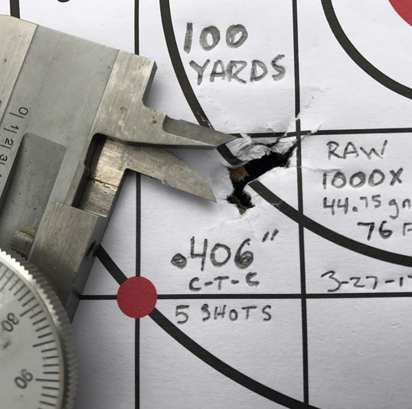

I'm one step closer towards my goal for high power tuning. I added some preload tension to the spring and have it up to 951fps with 34gr MKI's (68FPE). I bought a bunch of the 34.7gr NSAs to test out. They seem a little tight inside my barrel, and they're coming out at 935fps. I should be able to squeeze more out of it, I'm still a ways below 160bar right now.
The 33gr VKs might shoot a little better with the added power. They're coming out around 945fps on the high side, so there some room to tune for them. They didn't seem to have enough umph behind them when I tested last weekend with 880-905fps.

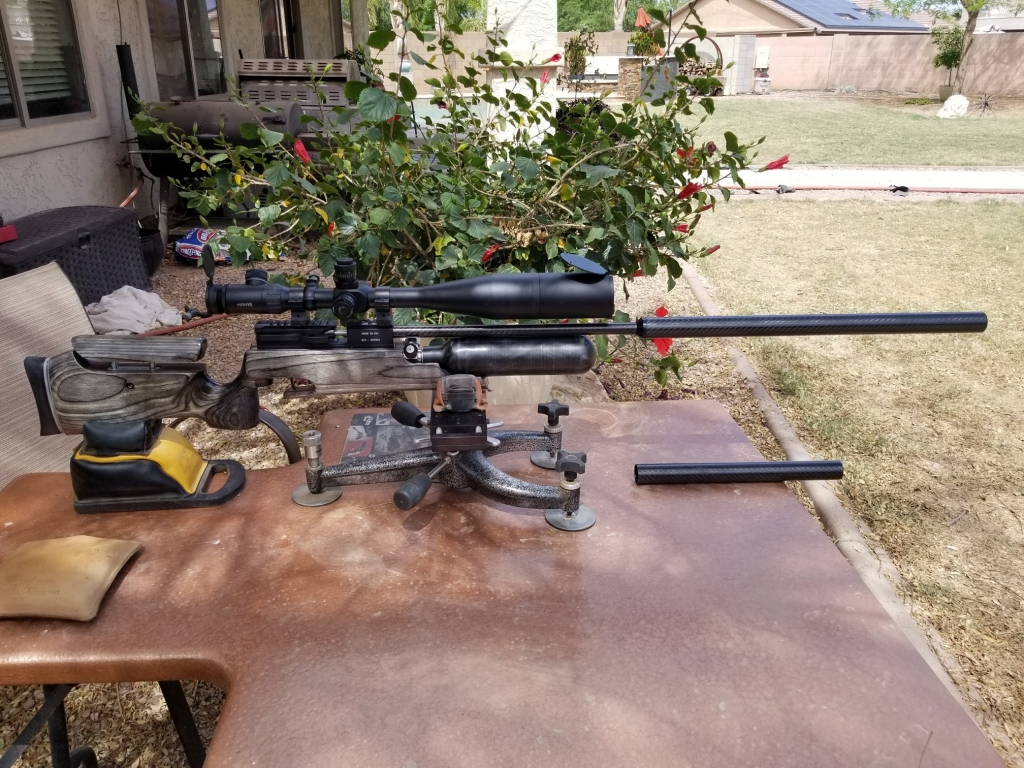

Hi Eric,
The .30 is an accurate gun for sure.

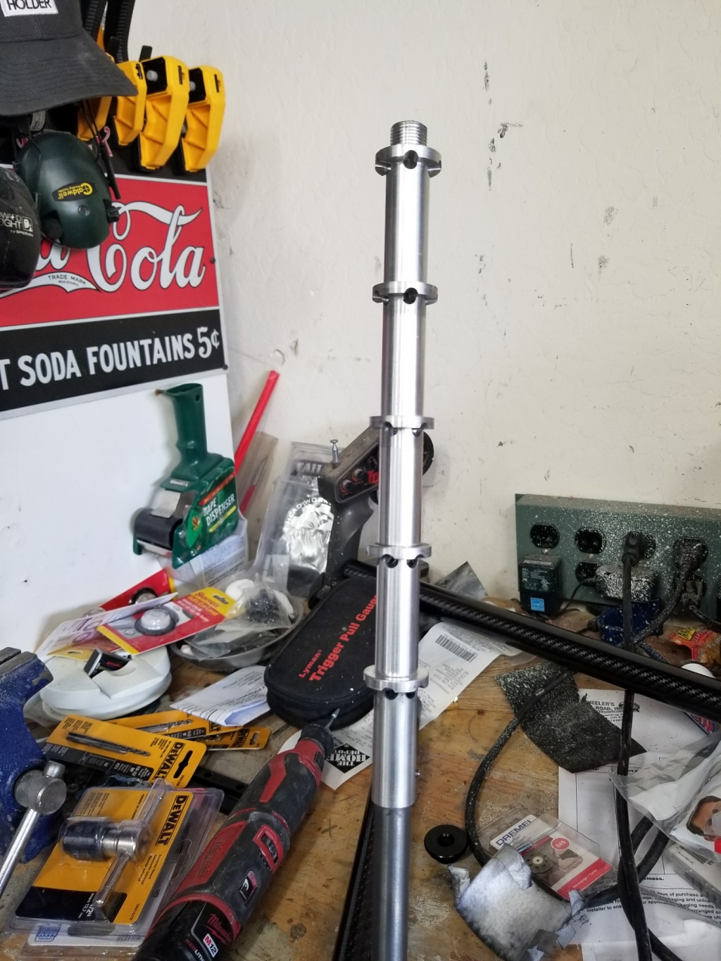

The stock Moderator leaves something to be desired. It does not have enough volume to do an effective job. I know Donny FL was working on some stuff for the RAW's but I don't know if he has done anything with the .30. Now my solution was posted quite a while ago. I found the manufacturer of the carbon fiber sleeve that RAW uses and bought some longer carbon tube then I talked to Martin and he said no problem that he would sell me more baffles. So I increased the size from a 2 chamber to a 5 chamber design. The results it is almost dead quiet pellets hitting soft targets are much louder than the rifle, the bad is it added 6" to the length of an already long rifle.
The stock tube is the one laying on the bench under the rifle.
If I remember correctly the stock .30 gets around 35 shots on a tank, I get more than that but mine has been tuned.
As far as the .25 cal swap several guys on here have done it and I believe SPAW is offering it as a package, keep in mind in addition to the barrel you have to change the pellet probe as well due to the change in size.

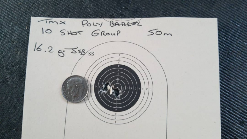

Hi guys,
I'm please to share with you that I've become an owner of this beauty, and it is a joy to shoot.
TM 1000 177 with polygon barrel.
It is set up for hunter field target at about 18.5 FPE Shooting JSP monsters really well, but also shooting Nielsen 15.5 grains slugs amazingly.
It came with rowan trigger blade, and this is what I have question on: After I hit second stage on the trigger, it travels about 1mm more before it goes off. I've tried adjusting it by taking out second stage screw one turn. Adjustment does the job well on action out of the stock, but when put back into the stock it won't fire.
Did anyone experience this? Can someone share trigger diagram elapse?
Thanks you, Vasyl.

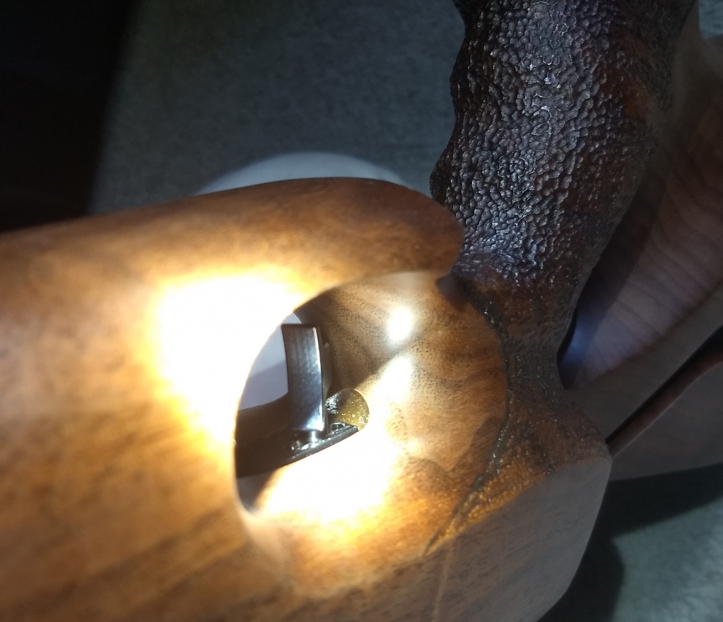

Being the RAW uses a modular trigger block and can be adjusted w/o the stock being there, if it cocked and fired while just a bare action in your hand ... it will fire in the stock.
* UNLESS the trigger blade itself is contacting wood and not be allowed to go far enough rearward to release sear.
In that case you need to reduce the 1st stage travel so the 2nd stage / break happens with less blade travel ( Rear most screw on the blade )
