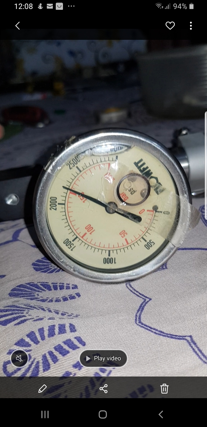

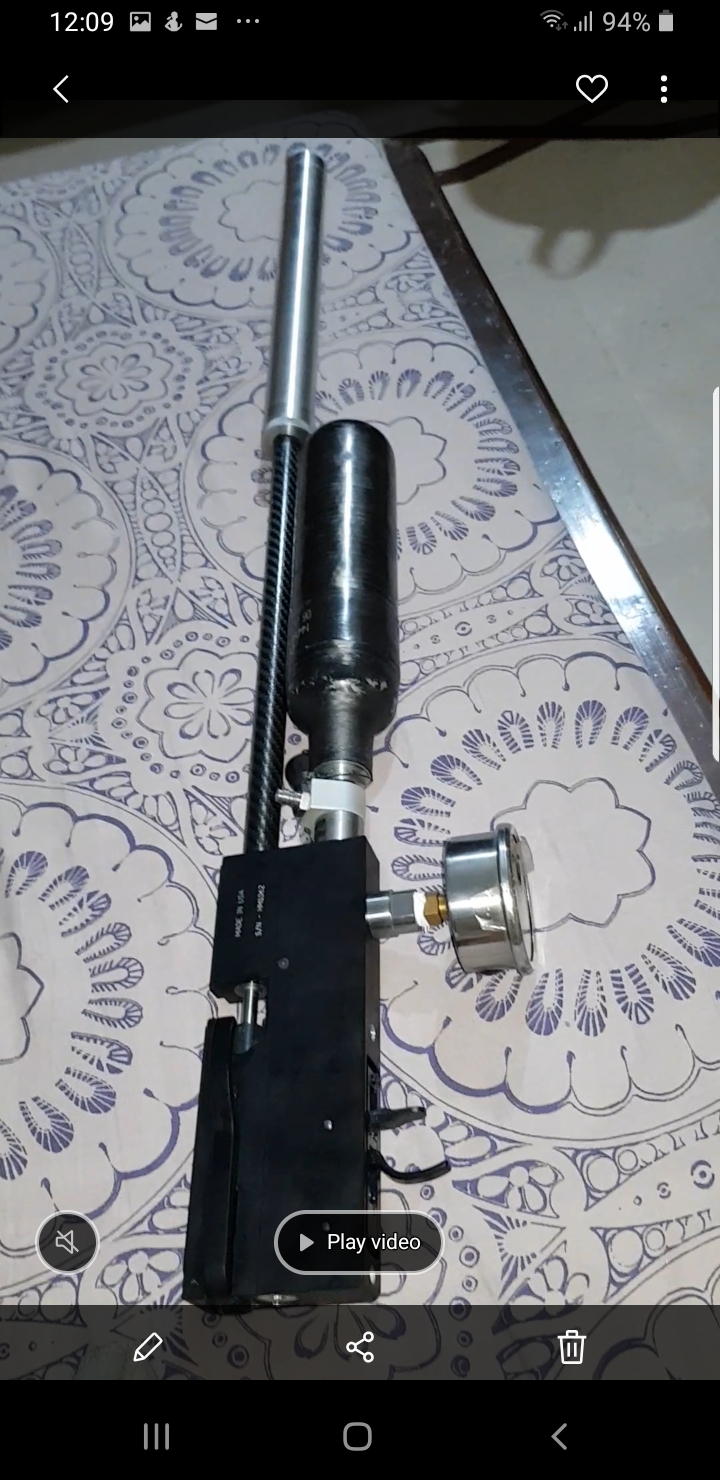

Nice sharing.
You can also know the exact reg pressure by using a good guage as I have showed in my above post.
I post the pic again.

Yeah I was planning on using the drop-in Theoben Rapid tester that I got Monday, but since my reg threaded piece is apparently one from an incompatible.357 I'm working on plan B to tap into the test port. I'm an engineer and do not like to guess at data points. I'll be good to go next week 😎

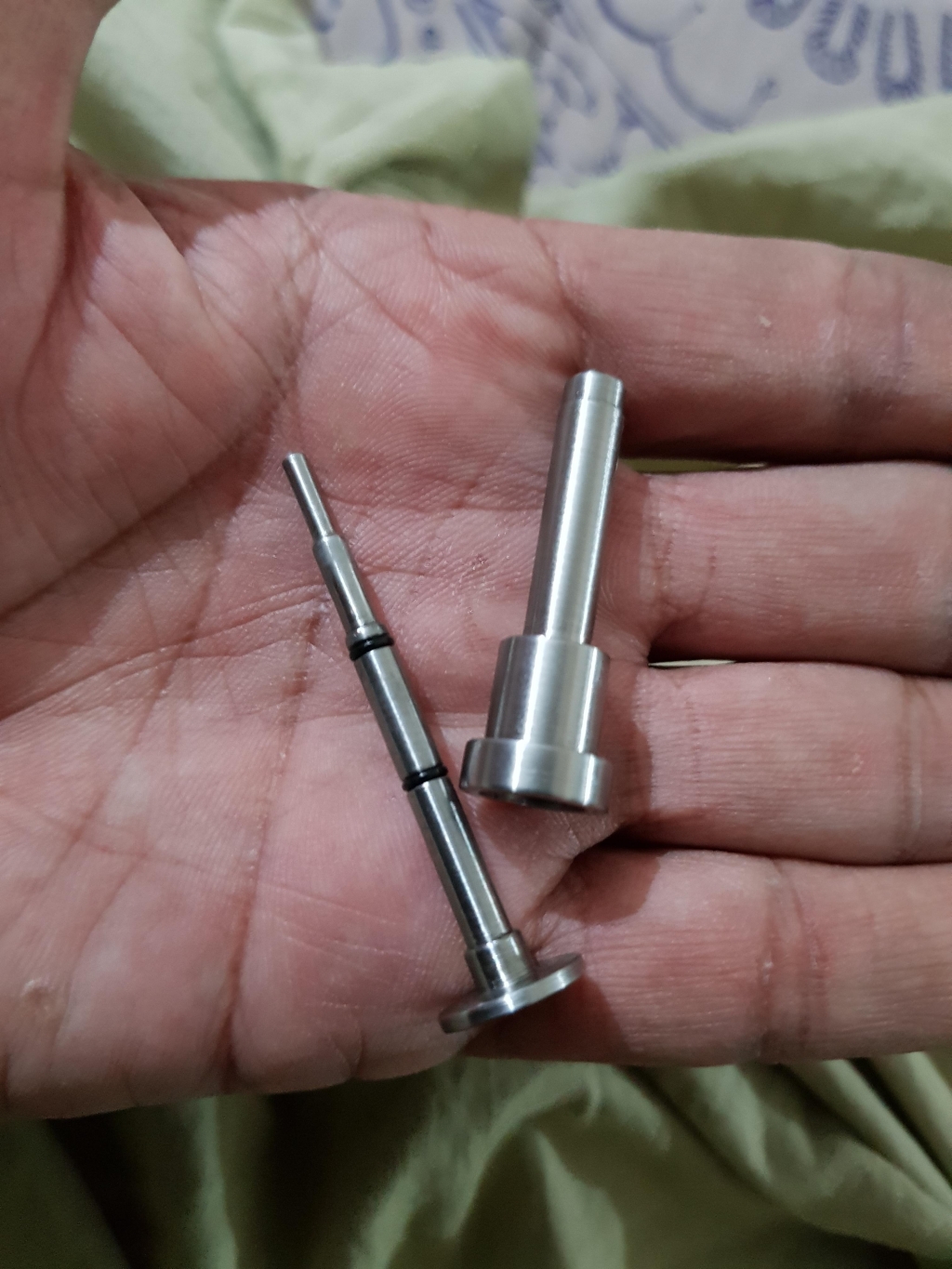

In .25 34 grain pellets fps have jumped up by 22. At same settings where 34 grain was going at 900 fps now it goes at 922 fps.
In .22 18 grain jumped so high that I backed out the hammer spring as much as I could do and still get 955 fps with a spread of 3 fps in 10 shots.
It seems that O rings inside the breach and on the pin of the probe has done wonderful job

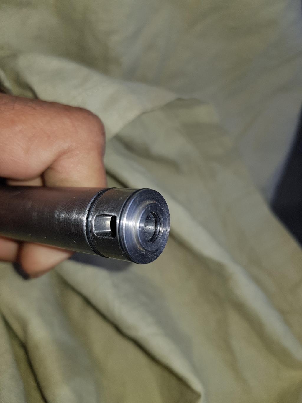

mtnGhost,
Check your pellet probe pivot to make sure the allen head is fully seated down.
I had an issue a while back where my .22 was getting louder and the velocity was off, so in my checking I found the pivot bolt for the
pellet probe had worked back and the pellet probe was leaking as a result.
2 minutes later with a little turning of the allen wrench and all was silent, and I had to back off the hammer adjustment to lower the velocity to within
rules.
It may not be that but it is a simple check.

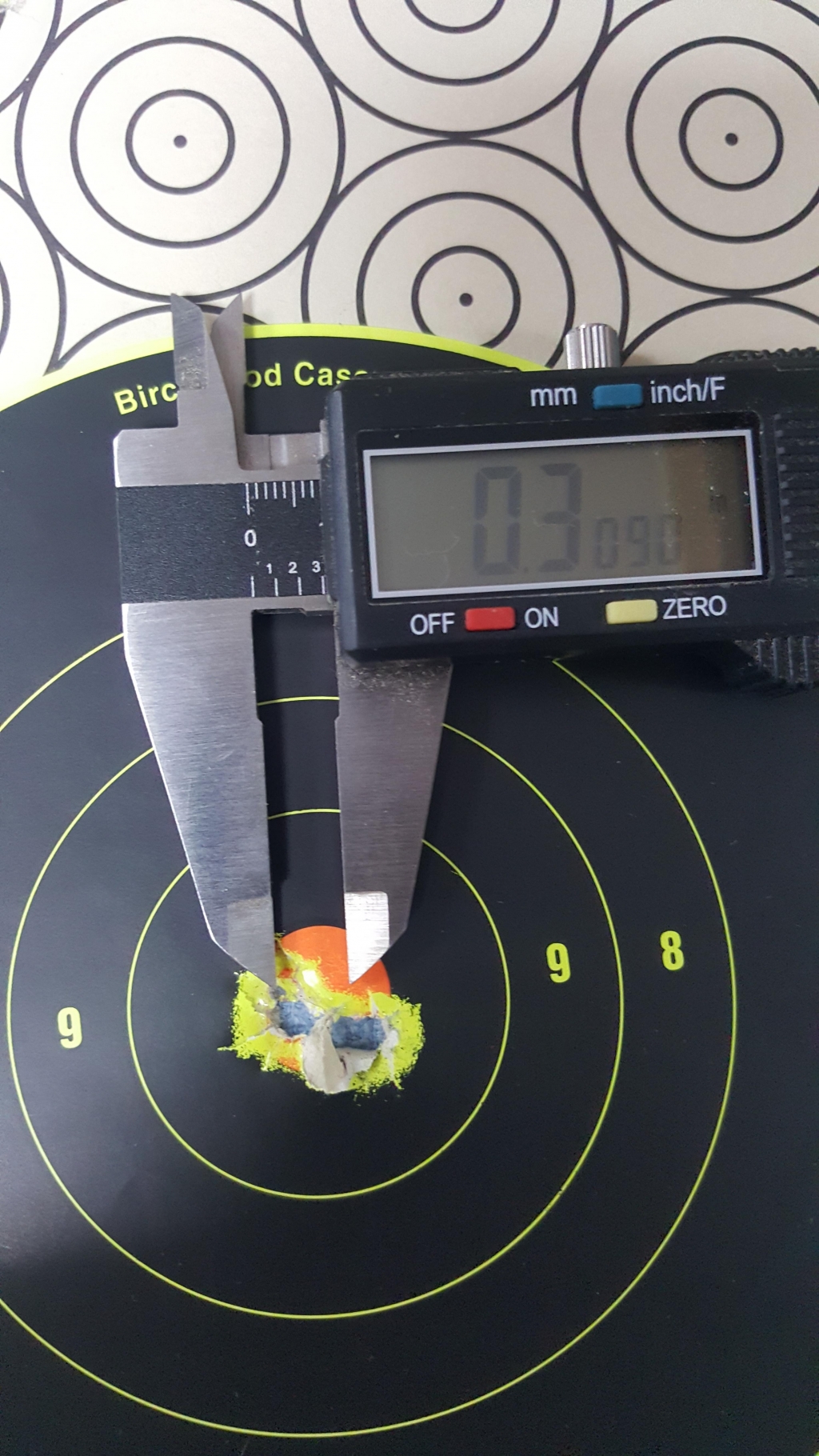

I put my raw30 in a br stock and shot 44's at 100 yds into .3 I posted in another thread in here Ken tuned and sent to me. it shoots really well. I feel it can compete with just about anything. I just need practise.photo is a 5 shot group no wind
Nice shooting! I don't know if I envy the group more or the fact that you had no wind!
Riteclick,
Nice shooting! I hope to shoot a group as nice as that. My Mark Buckanan tuned RAW poly .22 has shot a .05" at 25 meters but I have yet to shoot a 100 yard that nice.
Yeah I agree the RAW .30 is an extremely accurate rifle well beyond most others.
