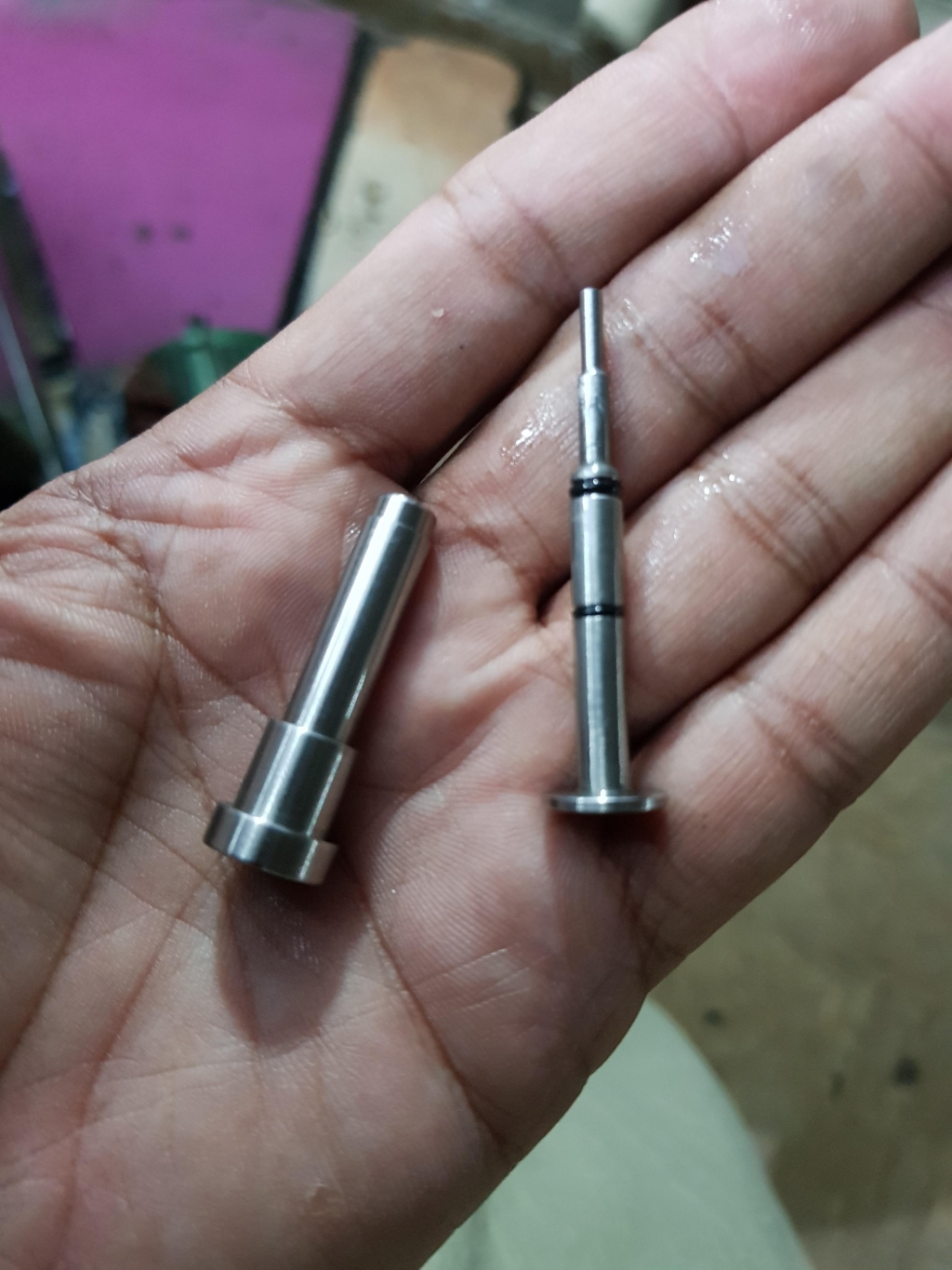

Is there only difference in the width of slot of .357 and .25 or there is also a difference in volume of regulated chamber between the two?
Another trick one can use is that of sacrificing some the regulators "Screw In" distance and place a set back spacer w/end o-rings over the male threads.
This pulls some of the regulator out of the plenum space increasing usable volume.
* I have seen this done by Alan Z (AZ ) on the original Theobens quite a few times. ... so just an FYI on this practice.

Thanks sir,
But my main objective is more consistent regulator that could handle higher pressure on high pressure side.
Getting more regulated chamber is just a bonus.
X models chamber is already good enough.
OK ... Now I'm not sure what RAW is using on the regulator seats in recent years ? ... On my personal FT gun a TM-1000 had removed and updated the reg seat from the supplied delrin/ acetal material to PEEK. Doing so the regulators set point tightened up and suffers no fatigue over time as well can handle higher pressure bearing upon it.
O-rings within the reg are now ALL Urethane 70 duro cast which also help with fatigue, tho do take a set faster requiring more R&R intervals.
What one needs to understand is HOW HIGH PRESSURE changes the shape of an o-ring within the gland/groove it occupies. They Do Not stay round getting crushed against the opposing side of the pressure. Static applications are one thing, but a regulators Dynamic motion of the spool gets a whole lot tougher to deal with as pressure increase !!
There is no free lunch here either .... Cause & effect still come into play sadly.
Scott S

Indeed some of us do Re-engineering portions of our guns with RAW being no exception. While from the outside my personal TM-1000 looks stock enough tho many exterior add on's, but get inside and it is by actual parts in play something far different. While OEM trigger group & regulator are there, parts & pieces changed there as well.
Firing system from the Hammer, Spring and valve / poppet itself along with transfer path mods are all Custom One-off parts creating a completely different feel and shot cycle over the stock components.
Can you make a better RAW ? ..... ABSOLUTELY !! no doubt in my mind & actual results with said modified RAW that backs it up.
