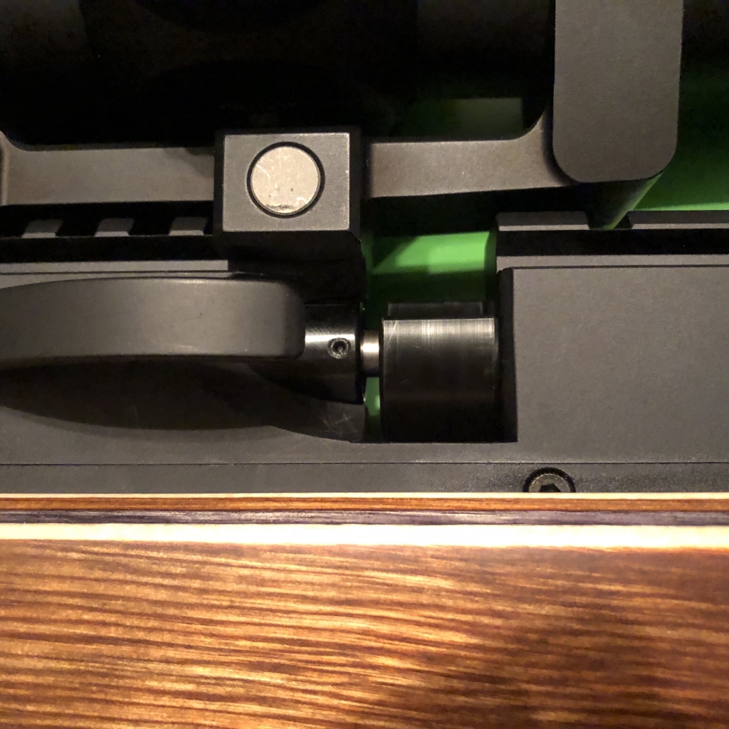

There is a section of the barrel that protrudes from the block on all of mine about 1/16" to 3/32". My single shot tray fits snug on all as well.
Photo's may help if you can.
Craig

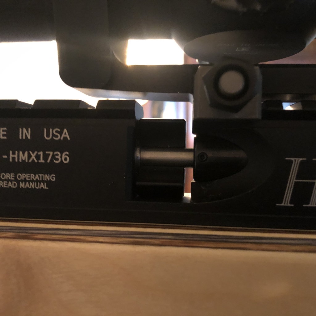

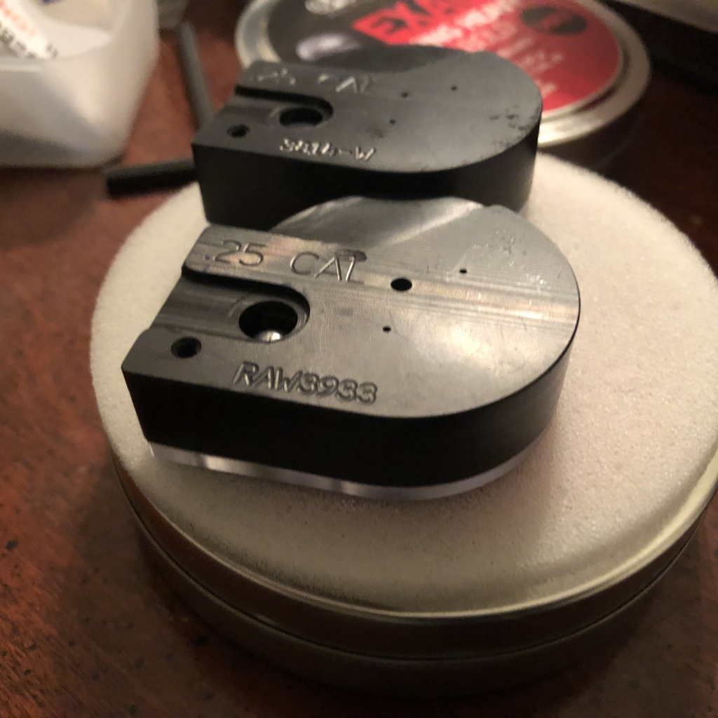

The first thing that I noticed with the RAW trays, they're round and are a PITA to snug with the end of the breach. Once seated, it doesn't take very much for them to pop out unfortunately. The only thing keeping them in there is light friction..
1554952882_19597795405caeb2b2c52462.81959762_A5CD5CE9-A051-4B89-857F-8F24529BE07B.jpeg
1554952883_17567817415caeb2b39d7020.50114887_CAC8CC77-5508-4C86-BCF6-F3190DB9D356.jpeg
I cant quite figure out why they're rounded, the width is the same as the magazines - so I assume they're the correct part for my rifle.
The trays are rounded so you can adjust the pitch to best suit the angle you desire when hand loading. So far I have had good luck with both of mine staying put.
John
I figured that out late last night while I was practicing with getting a feel for loading and the trigger stages. Every 3rd or 4th time I reload the single shot tray, it falls out. I might have to wedge something between the tray and the action to keep it from falling out until I can find a 3D printed mag that stays put better. Hand loading doesn't seem to be very ergonomic for me with this setup, and I wouldn't want to damage every other pellet because that just wouldn't be fun! :)

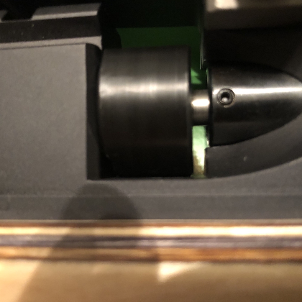

Note the very bottom of the tray, Mine has no gap like your has. Mine fits snug. the gap at the bottom of yours may be the cause of your problems.

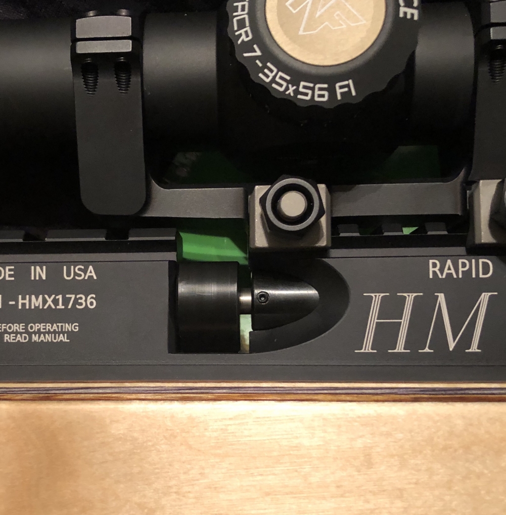

Hmm.. it looks like your gap is different than mine! Yours is under and mine is to the rear. Here's another photo with more light behind it ..
1555027840_14459164475cafd780a019d4.42966353_1DE92498-2692-4C72-898E-E3313447DE99.jpeg
What caliber is that rifle Craig?
As far as pellet deformation, I didn't notice any tipping during the probe insertion. I do plan to shoot a bunch of MKII JSBs, but D-RIG's slugs are what I want to shoot mostly. I've tried hand loading, it's a two handed operation for me - and not without damaging the ammo.
MG,
Mine is a .22 cal. that said my .25 cal and .30 cal are all the same HM1000X model. Snug front to back with no gap like your gun has.
I really feel that your tray is too short in length to properly fill the gap.
Craig

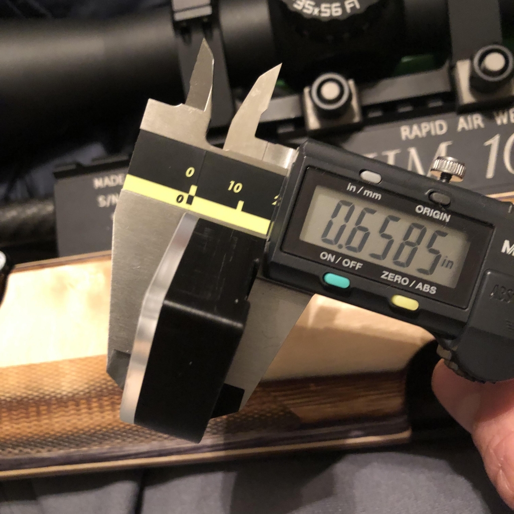

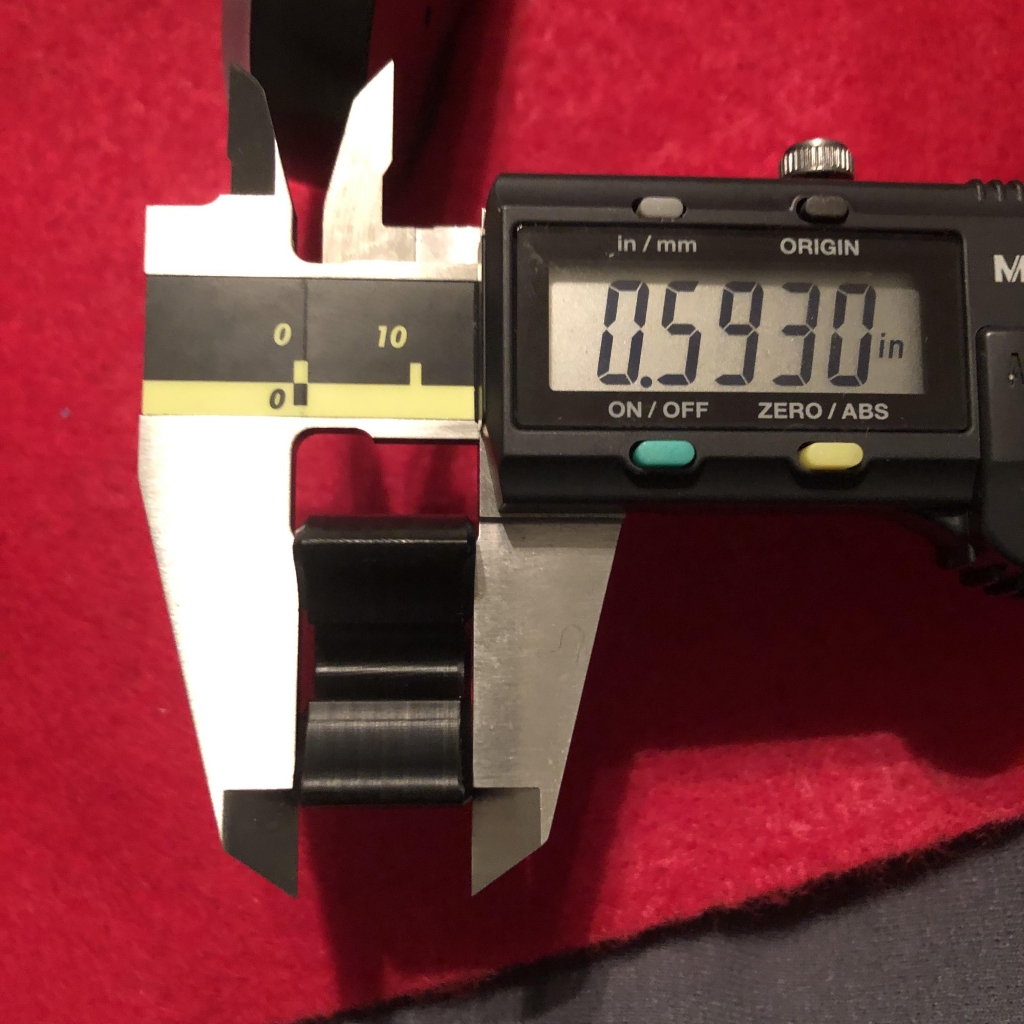

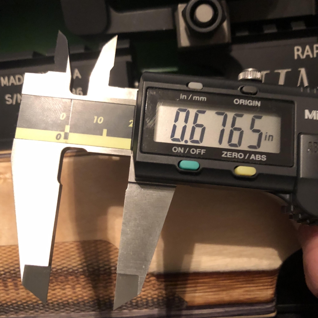

I totally agree with that assessment, but I'm beginning to think this is by design. I also have two magazines for this rifle - one that shipped with it and one that I ordered from RAW before the rifle arrived.
The magazines are only 0.003" wider than the single shot trays. The space between the breech and probe side of the action is much wider. The magazines will fall out on their own if the rifle is moved in the slightest bit while the lever is cocked back.
I wonder if this 60ft-lb version has a wider magazine feed opening in the action than others? I guess I'll be reaching out to some folks tomorrow to see if they're planning on making wider mags and trays. This is pretty fumbly.

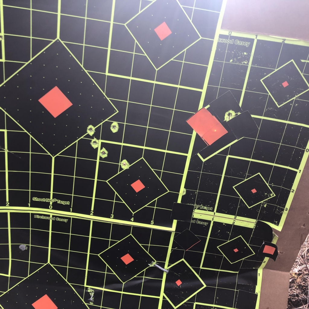

Well, despite the hiccups with the accessories - I got a little taste today of what all the rage is with these rifles. The weather here in the PNW today was abysmal - off and on rain from a big storm system that dropped down from the cold north. Wind has been blustery, gusting to 45mph in the mountains around my goto shooting area. I knew that I was going to be down in that area today, so I brought my new 60fpe behemoth with me in case the rain let up.
The rain stopped just long enough for me to setup one short range target and one out to 108y. I brought a rickety folding table with me to shoot off of. I setup the table right behind my Jeep to get out of the direct forces of the wind, and shot 10 or so heavies at the short range target since I didn't have time to bore sight my new scope on this new rifle. Once I had the general direction from the center of the reticle, I realized the sky was looking ominous and aimed at the long range target.
It took a few pellets and one refill to hit paper. I did a quick elevation and windage adjustment and saw my POI much closer to my POA. From there, I just shot until it fell of the reg (5 more shots). With the wind gusting like hell my rickety folding table wobbling in the wind, and without my rear shooting bag (just my bipod), this is what she did..
A glimpse of what was what I was dealing with at the time..

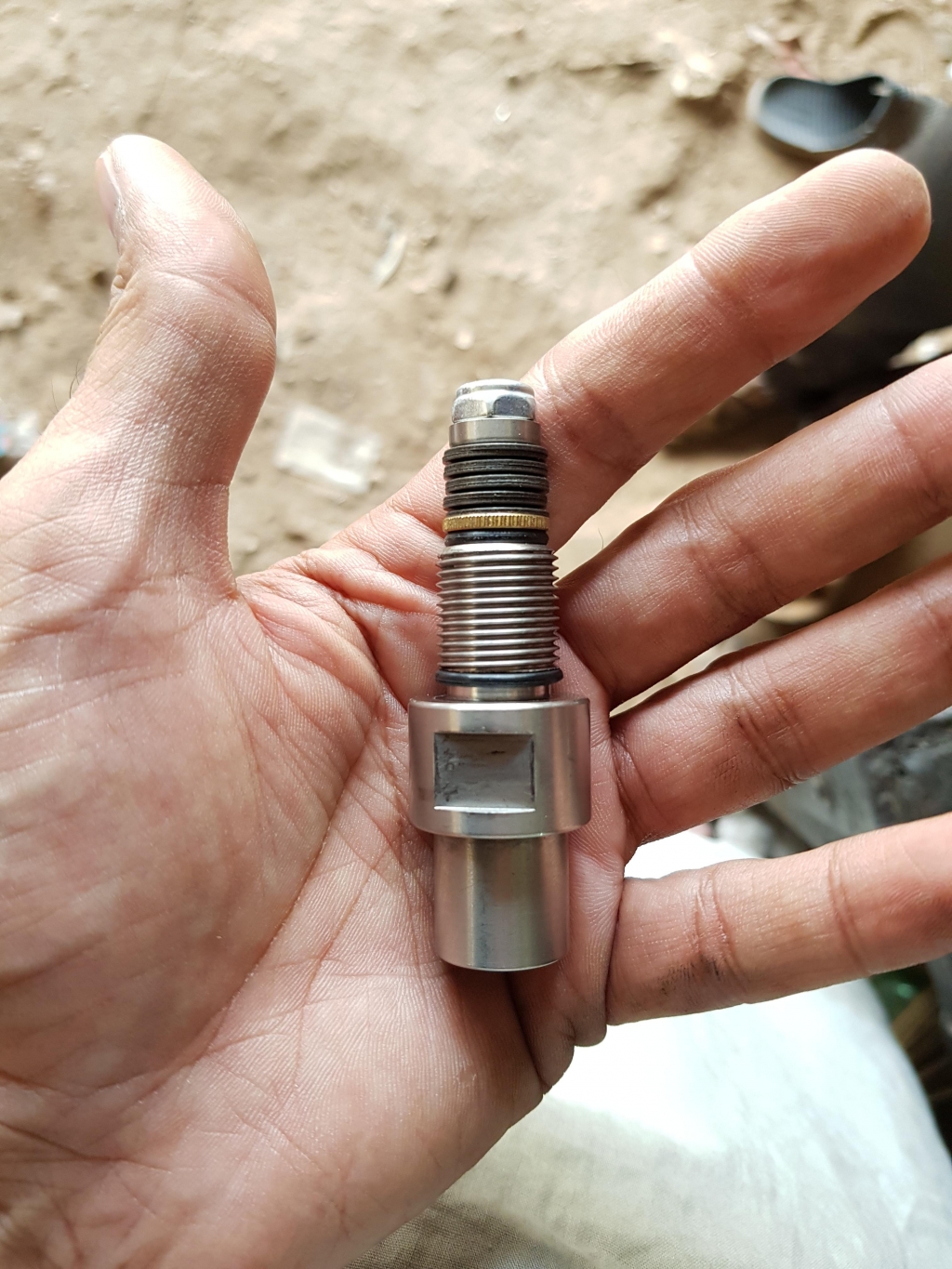

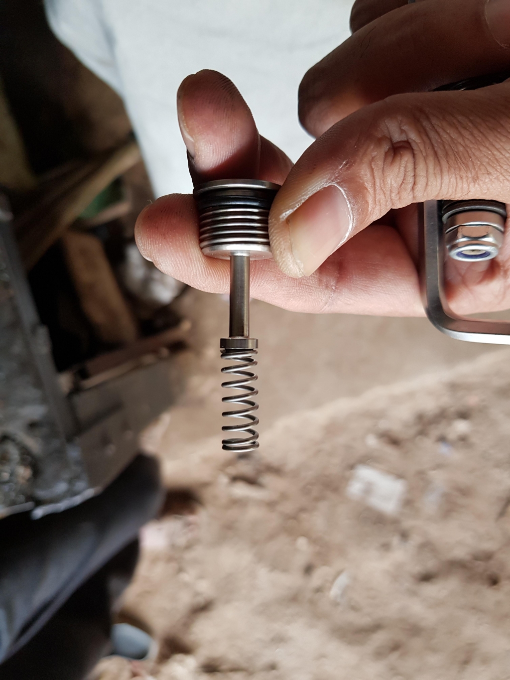

In HM1000X 60 ftlb RAW does not use valve air filter. I just examined mine.
The design without the air filter definitely improves air flow.

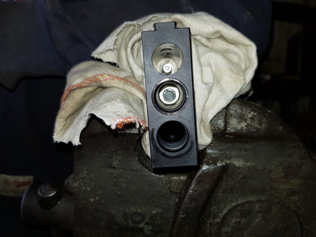

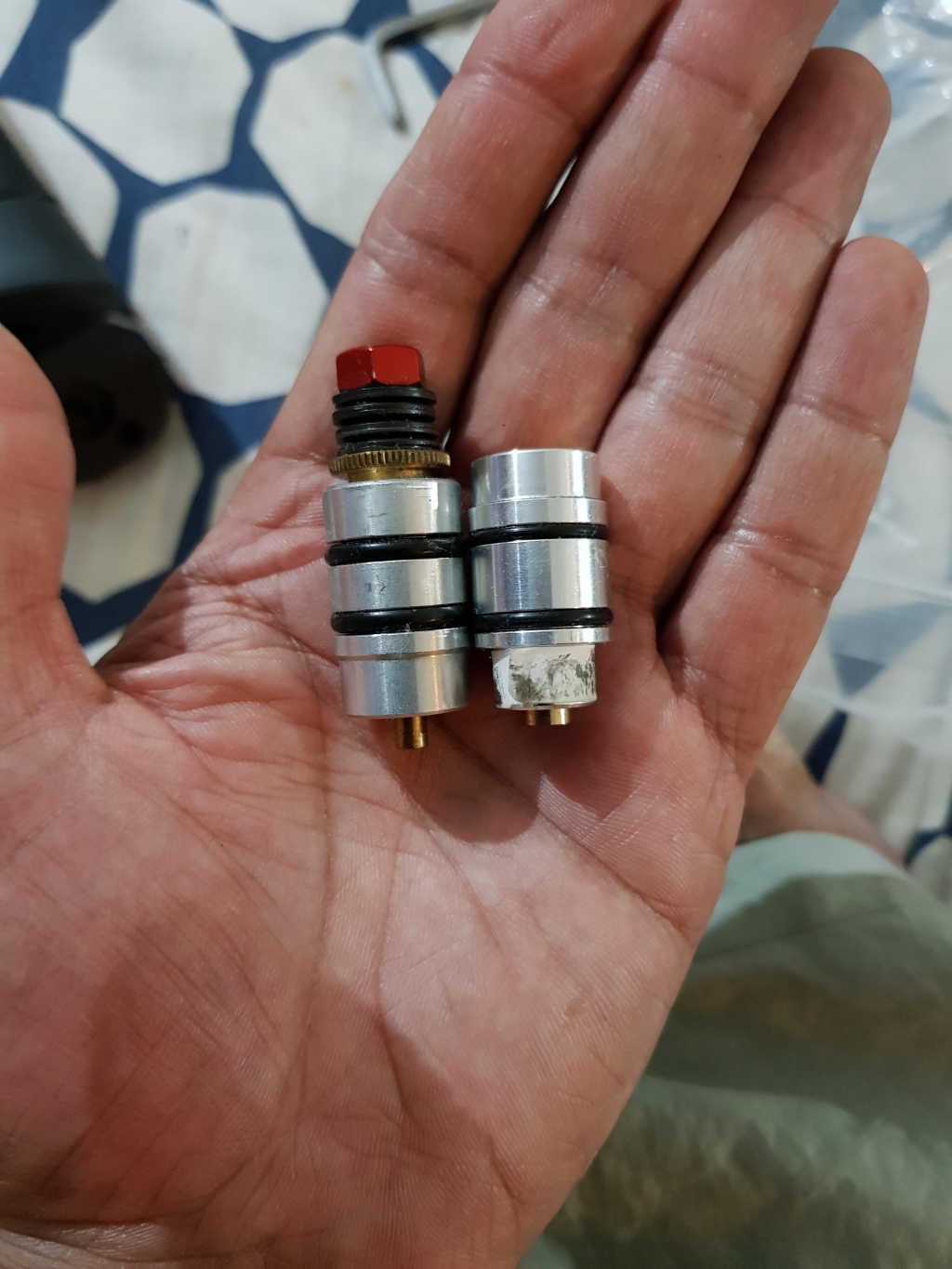

Dear
Here is the RAW regulator in my hand.
And below are FX Royle OEM and HUMa regulators.
Now you can understand that how much more space RAW regulator occupies as compared to Huma. The smaller sized regulator will increase the volume of regulated chamber and HUma is well known for their efficiency.
