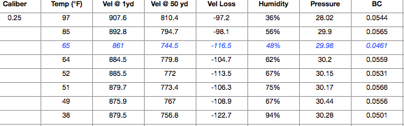

For reference, here's a chart showing the velocity change over temperature (at 1 yard) in .25 caliber to show how much it can vary:
1538889252_2939000095bb99624a90fe7.09543940_RAW .25 cal BC Variation with temps.jpg
Blue entry is the rifled barrel, all others are the polygon barrel:
1538890775_1993642065bb99c177cfca8.19983022_RAW .25 cal BC Variation with temps-cropped.jpg
1538889263_6860326275bb9962f084745.01948176_RAW .25 cal BC Variation with temps.jpg
1538890786_2278468585bb99c22b49303.31134605_RAW .25 cal BC Variation with temps-cropped.jpg

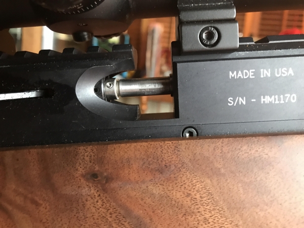

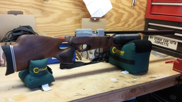

So i was out shooting the Blue Beast yesterday and what a BLUEtiful morning it was. Shooting small groups at 50 yds over and over. When i was shooting i started to notice when i cocked the side lever there was some sticking of the pellet probe when it was cycling. So i started investigating and looking at the pellet probe and noticed there is some play in it where you can wiggle it from side to side.I also noticed that you can see some threads from the pellet probe and was wondering if it is backing out some how. This is a HM model and was wondering if you guys can check to see if your guns are like that? I will post a pic of the threads of the pellet probe that are exposed,,,i grabbed and turned it trying to screw it back in but it didn't budge so perhaps this is how it should look?
It was a BLUEtiful fall morning!!!!
I think the threads you are seeing are the adjustment threads Martin uses to set the initial probe depth and can be threaded in and out to obtain the adjustment needed initially. I don't know for sure, but it looks like he may use a thread locker of some sort after making the adjustment (JB Weld or something-definitely not loctite)?
With swapping calibers between .25 cal and .30 cal, there have been times when I felt the probe 'sticking' as I was cycling the probe backward to cock the gun-is this what you are referring to? If so, what I've found was the tiny 1.5 mm hex set screw was slightly 'proud' of the black part of the probe and was scraping on the inside of the action when cycling the bolt backwards. In your photo, it's the small set screw that is just starting to enter the action in your partially cocked gun.
When I swap calibers I've learned that the set screw I referenced needs to be threaded in just enough to make it 'not proud' of the black part of the bolt body so that it doesn't hang up on the action. The screw does NOT tighten onto anything on the inside-it merely acts like a retaining ring (so to speak) to keep the silver part of the probe from ejecting forward from the black housing due to the probe spring.
Let me know if this makes sense. I can reply further later if more / better explanation is needed.
Sean
Like Sean explained, the threads you see there are to adjust the probe to barrel breech seal. I had to adjust my .25 probe a bit when I had some slight probe blow-back. As Sean also suggested, on my .25 probe there is some type of glue on the threads. After loosening the tiny set screws, I heating mine a bit and turned CC to lengthen about .020" to get the side-lever to cam correctly and the breech to seal. If your side-lever cams closed well and you don't have a breech leak, there is no need to worry with it.
The set screws on the black portion are, just as Sean explained again, retainers for the probe assembly. They need to be flush at the surface of the arrangement, no more shallow or deep than that. Basically, listen to Sean 😁
So for anyone wondering, I threw my .25 cal polygon barrel back on and left the HS tension maxed out. JSB Heavy Mk I velocities averaged 942 fps at the muzzle (equates to 66.5 fpe). Surprisingly (to me) the BC dropped considerably at this higher velocity: down to 0.0490. Accuracy was so-so at this setting. I wouldn't draw many conclusions on the accuracy because it was really windy. Also, I've heard that the higher speeds in polygon barrels result in very fast leading up in the barrel. I haven't cleaned mine in like forever, so I should probably clean it, wait for calm conditions, and then shoot bench rested to see what I really think of theh groups at those speeds.
I'm inclined to just turn it back down though to about 890-ish fps again (at 78F)...
Any interest in having me clean the barrel and shoot groups at the current speed before changing it back down in power again?
Sean
Well, I didn't get around to shooting groups hot yet because I wanted to settle a debate in another thread regarding the effects of different barrels on the external ballistics of pellets. If anyone's interested in seeing how the polygon barrel compares to the LW rifled and the FX ST barrels, here's a comparison for you to enjoy.
