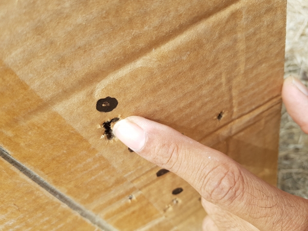

These are 16 shots at 55 yards with jsb .22 25 grain redesigned pellets at 890fps. Gun is fx royale 400 with BSA barrel.

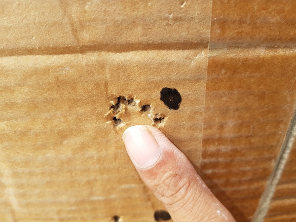

These are 9 shots at 55 yards with 18 grain jsb at 1000fps through fx royale 400 with BSA barrel.

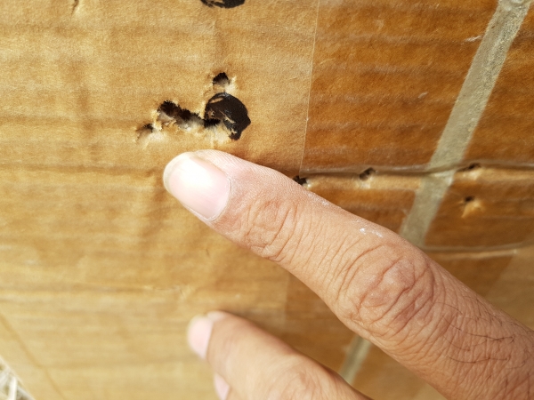

These are 8 shots from HM1000X .25 with 34 grain mk2 at 60 ftlb from Polygonal barrel. 55 yards.
It was a windy day and heavier pellets performed better.
