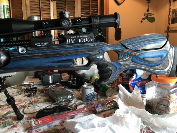

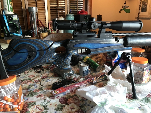

Finished clear coating the stock.
1533427571_14365881915b663f738bfb40.56495195_817F491C-C155-415F-AF28-EC4F076724A8.jpeg
1533427572_19150693505b663f74c61ee8.58760444_9C227410-0CC9-404A-955A-B522137465EE.jpeg
Looks great Jim! I really like how that turned out... What an AWESOME color!

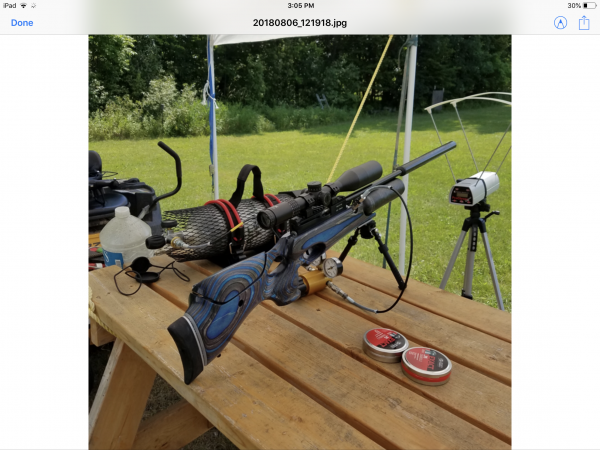

It sure is nice not having to worry if it’s going to get marked up now, should of clear coated it when I go it. I zeroed in at 50 yards with JSB 81.02s and had no issues out to 100 yards after I figured out my hold over but I’m going to rezero it at 75 yards, I also shot a couple 100gr slugs from MrHollowpoint that Pat gave me(thanks Pat) and at my 50 yard zero they hit about 2 - 2.5 inches low but were right on target.

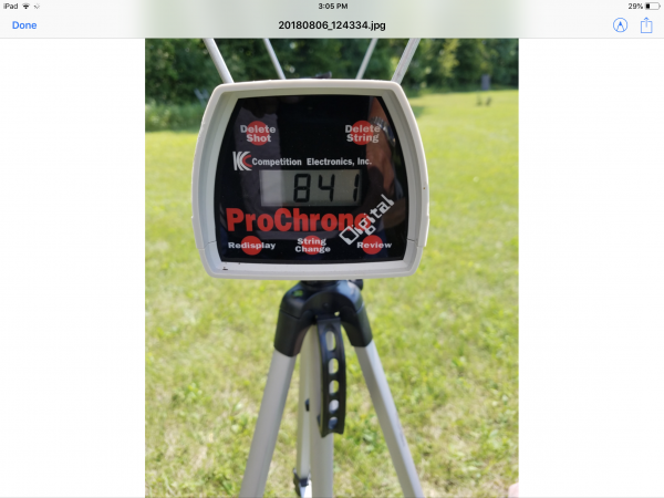

Teatherd at 3200 psi so I was about 400 psi below 250 bar and I was getting 839-840-840-841-841-835-841 but I might of shot a bit fast being I was shooting at AR plates at different distances so it was fire and cock fire and cock with no real fill time, next time I go out I’ll slow down and let there be about 10-15 seconds between shots and see if fps becomes more consistent. I might try it at full 250 just to see what FPS it will do topped.
