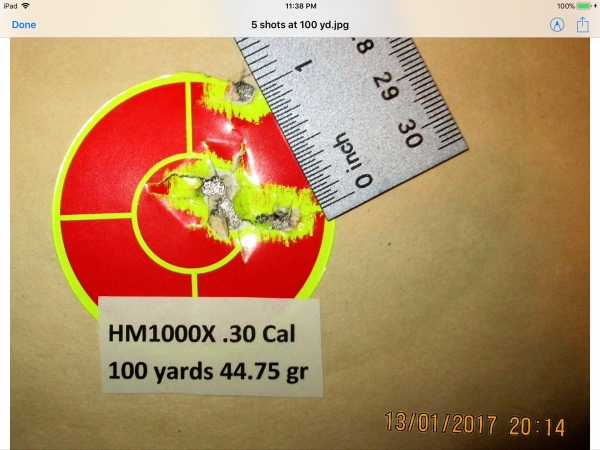

Never owned a Daystate but if you like to tinker go with the Crown if you want to just shoot and be able to just change power go with the Royale 500, I like my 500 but wanted something a bit shorter so I went and Traded my 500 .25 cal for a Wildcat .25. There all nice Airguns and on a side note here is a target pic of my new to me RAW HMx .30 at 100 yards with one flyer.
I own a RAW .30 and as others have said it is incredibly accurate, easily a match for any other airgun out there. MOA is fairly routine, and sub-MOA a real possibility if conditions are good. That said, RAW guns are BIG! And HEAVY! It would not be my choice for a field gun, plinking, etc.
BTW, if you are looking at the 60 FPE .25 RAW then you are looking at the new high-powered version that is made for shooting heavy pellets at high velocity. The standard .25 HMX shoots 25 grain pellets at normal velocity for more typical .25 energy. That gun would be the more direct comparison to the others you mentioned.
