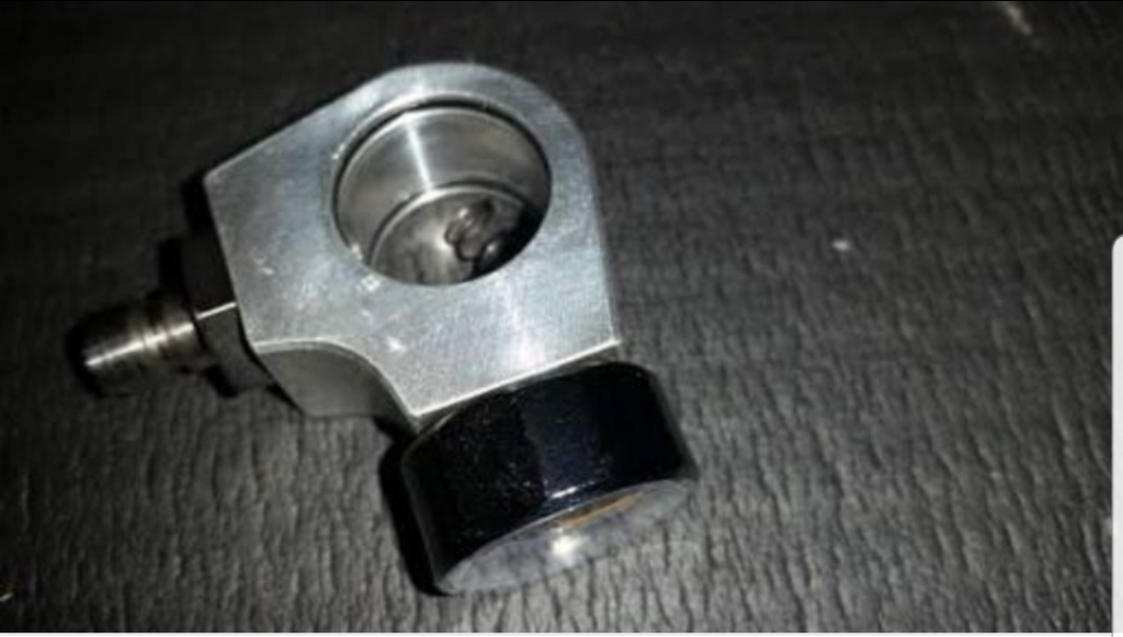

anyone knows the size of two big O rings inside the housing ? Regards, Umair Bhaur

azuaro Member Aug 12, 2015 427 53 Texas and Montana Jul 9, 2019 Add bookmark #2 Jul 9, 2019 Add bookmark #2 Hello Umair: Those two O rings are: 17.16 x 1.78 The O ring under the gauge is: 7.65 x 1.78 Best regards, AZ Upvote 0

mubhaur Member Nov 8, 2015 2,437 1 1,409 53 Karachi, Pakistan Jul 9, 2019 Add bookmark #3 Jul 9, 2019 Add bookmark #3 Hello Umair: Those two O rings are: 17.16 x 1.78 The O ring under the gauge is: 7.65 x 1.78 Best regards, AZ Click to expand... Thank you sir Upvote 0
