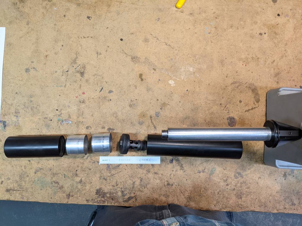

AncientSword, The new RAW HM1000LRT dose not come with the offset moderator any more. The new design is just over 2 inch in diameter and 15 inch long. For the 22 cal I was able to check the sound level of both the old offset design and new pop can design moderator with a db meter phone app and found both had the same amount loudness. Here is picture showing the new moderator apart nest to the rifle.

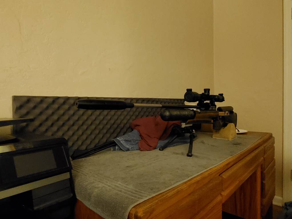

i dont think anybody understands why raw continues with these big moderators , if they would just have a threaded end of some sort , slip on with grub screws is fine , then we could choose our own moderator for our own needs , we could control the length and how loud we each would be ok with , i now have a huggett on mine, its very quiet , but what a ugly mess i still have to fix
