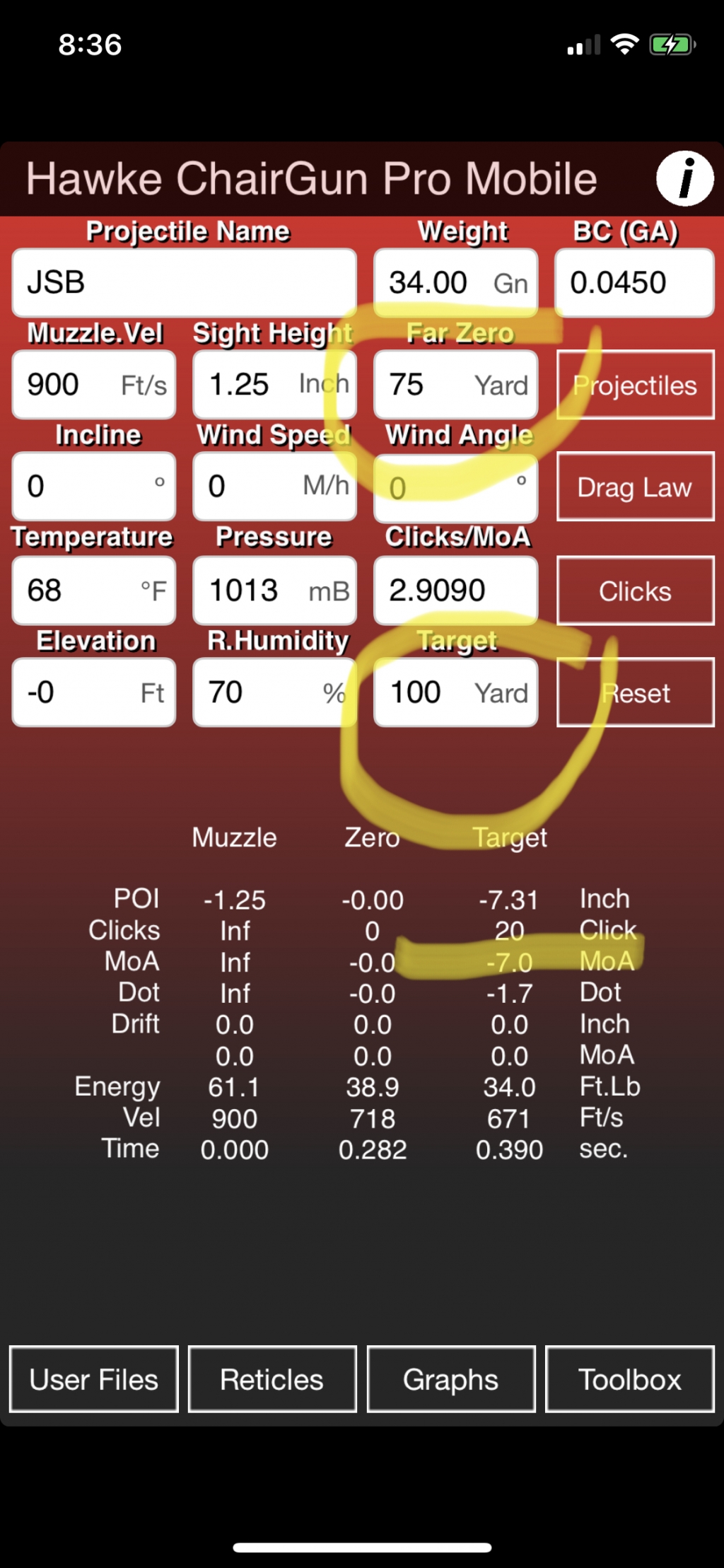

Have just got a RAW .25 Cal and sighted in for dead on with the JSB 33.95 King heavy pellet @ 75 yards but it drops 5" more inches at 100.
Has anyone got one and had to turn up the hammer spring pressure? I don't have a chronograph but it's brand new so shouldn't it be around 900 fps? I tried contacting Martin but airforce will not let anyone converse with him. So have no avenue to talk with the manufacturer, kind of annoyed with the lack of communication for a $2200 rifle

I put the numbers in ChairGun and going by your zero at 75 and the drop of 5”s at 100 it looks like your doing a little more then 900fps.

Ok just did a bit more testing and it actually is a 7" drop in that 25 yards but from your responses it looks there is nothing wrong I'm waiting for a better day with out as much wind as the lateral spread @100 is 2.5".
