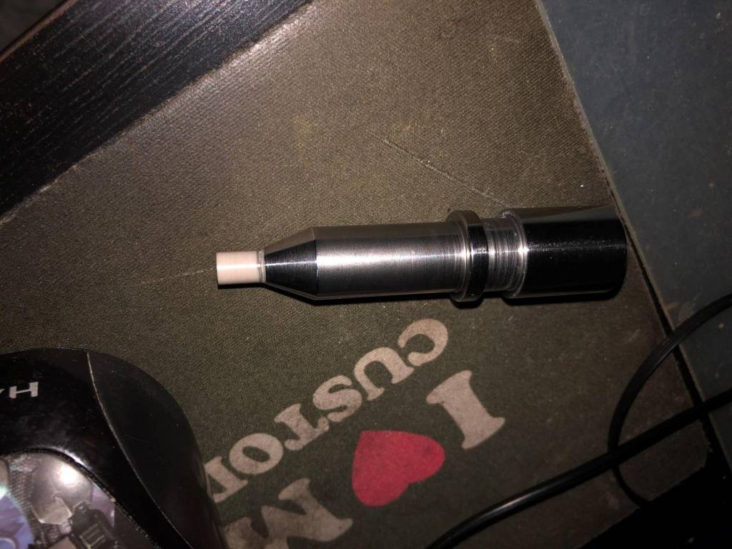

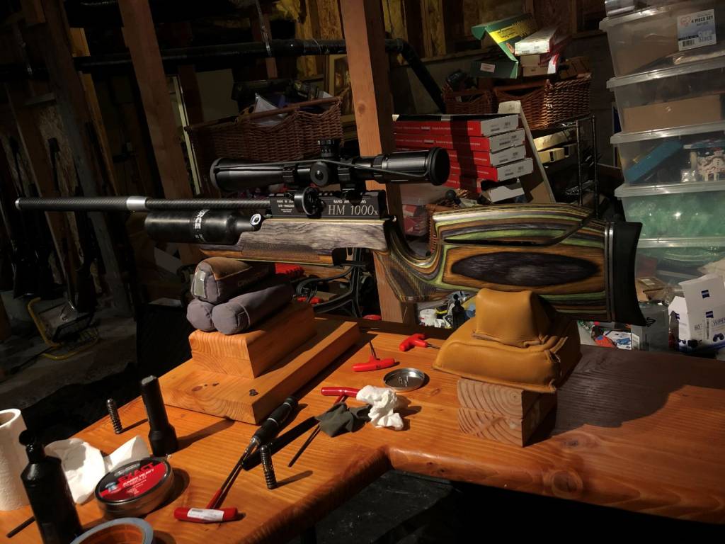

On the newest version of the HM1000x, the hammer is one piece. To install peek I will need to cut down the tip and drill out hammer about 1/2" to install peek using JB weld. S/b no biggie ... already heated tip to anneal, just need to shave off 3/8" length of 1/4" OD tip and drill/tap hammer body. Peek seems not to like being threaded with a die ... we'll see.

Why not just drill it out and add a threaded collar/sleeve?
Hey Scott since he is modding his hammer do you think it may help to suggest how to do the peek at the hammer head?
If the strike tip does NOT come out as all previous Theoben / RAW hammers did .... Only way is to make a SHOE type fitment.
Being I have NO actual action in front of me, have no clue what clearances there are within the hammer bore ahead of poppet stem for the added diameter a Shoe would include ? Also going to loose some stroke unless strikers length is reduced equaling that of what a PEEK shoe would add.

Made a Peek Tip that turns out to be what Scott had suggested. JB Welded a Peek sleeve or boot over a reduced hammer tip.

The Peek, Hammer Tip increased the consistency of hammer/valve stem strike.
This is very good news for the RAW👍.
With a little tweaking, the RAW can be made as good as before - and is LIGHTER😊.
