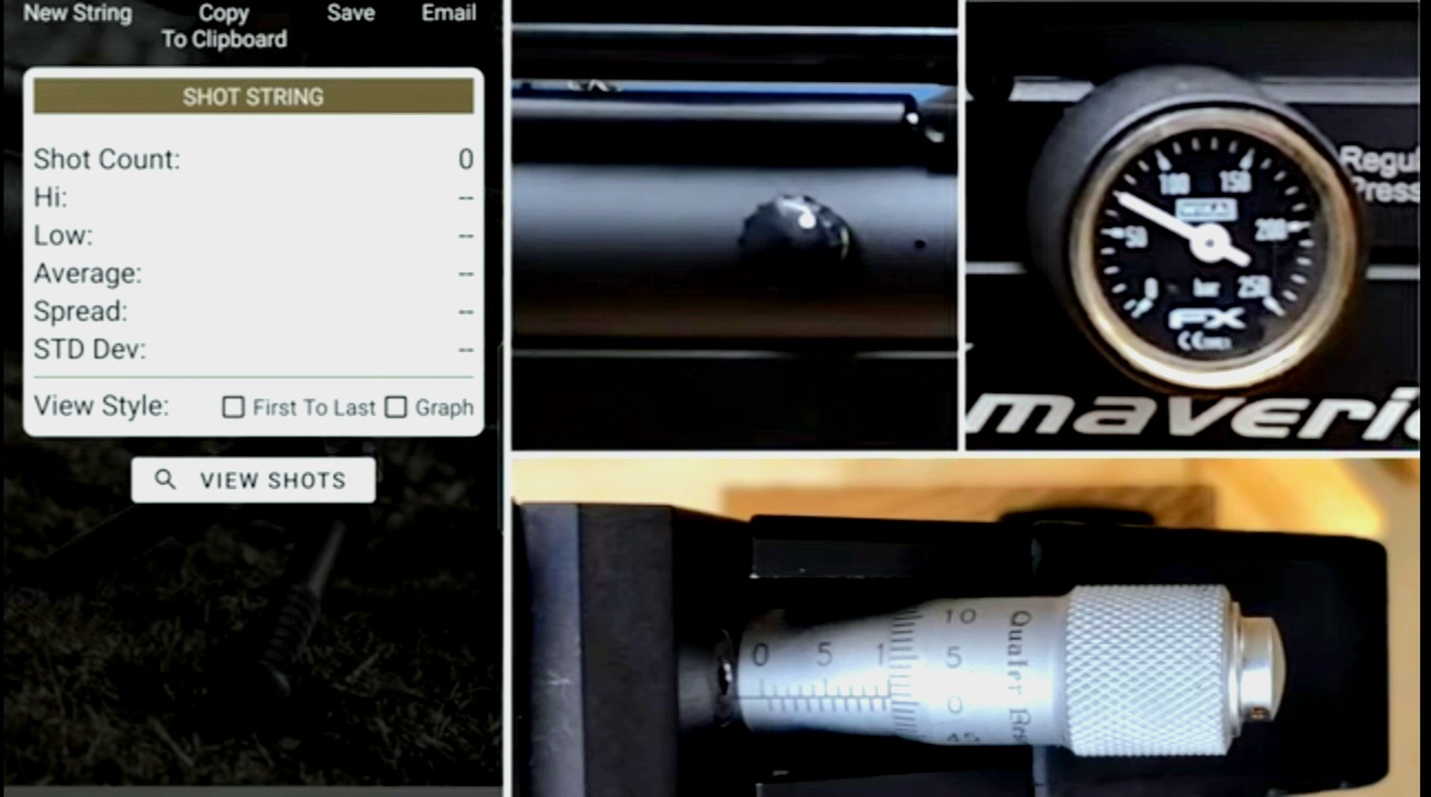

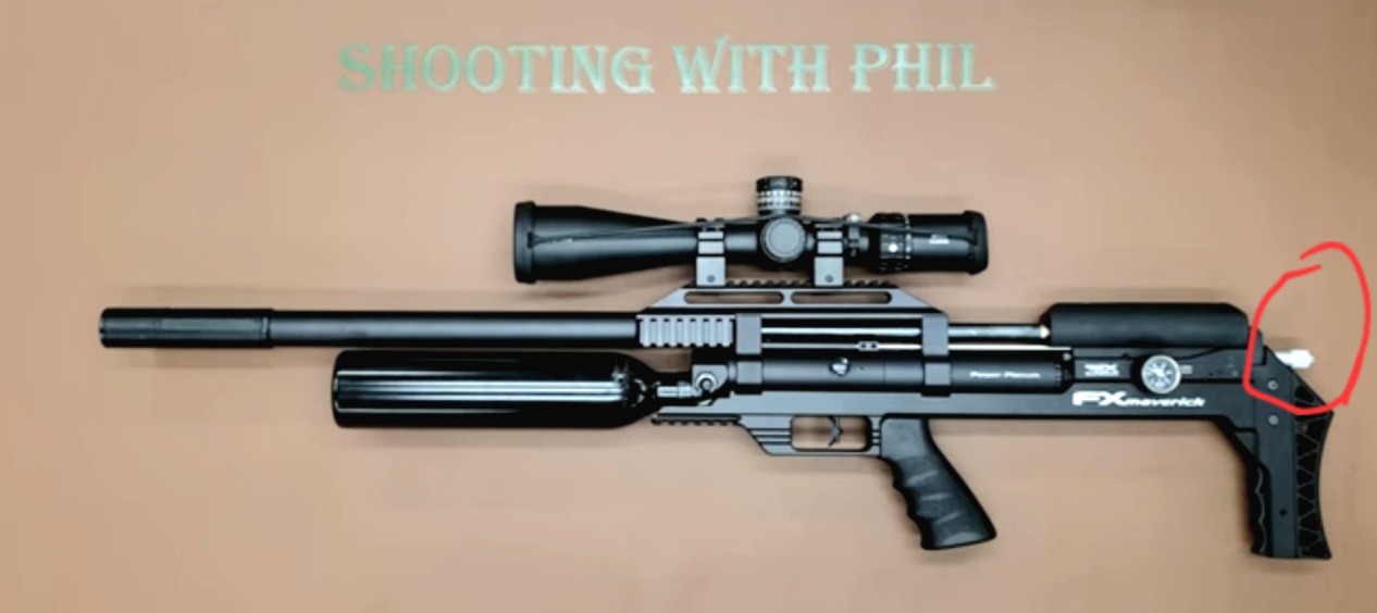

I have seen a YouTube video of "Shooting With Phil" in which he installed a micro adjuster in FX Maverick for hammer spring adjustment.
Pics below:

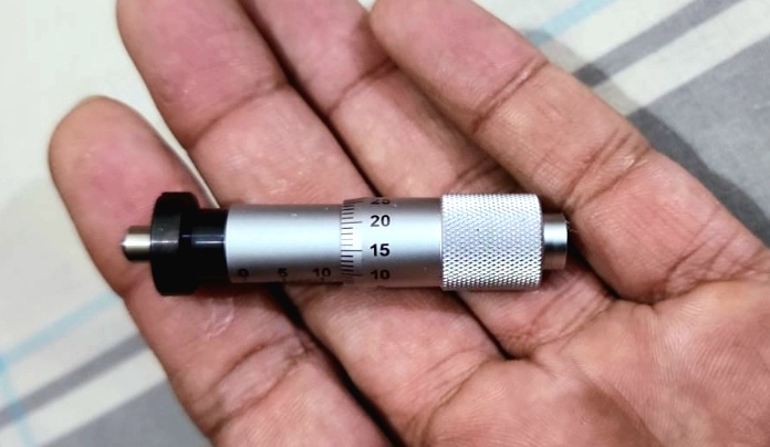

The idea looked promising to incorporate in RAW HM1000X.
I shall install this micrometer in RAW HM1000X inbuilt with anti hammer bounce device.
Micrometer has been sourced as shown below.
I hope it would be a good tool for micro adjustments in RAW HM1000X.

Don't shoot the messenger .... This idea is WAY way way overkill !!
It adds unwanted length, unwanted weight IMO.
Very BLING I'll agree with ... sometimes KISS is better :unsure:
Yeah, I think everyone appreciates the Mods Mubhaur has been able to do, but this seems pretty marginal given the work needed.
Nothing like a micrometer handle hanging out of the back of the gun ............
Was this Mod shown to be that effective?
Agreed. In my personal RAW gun I don't use it as I don't need it.
But it is obvious that through this kind of adjuster, one can more easily adjust the hammer tension very finely during an event. Or may be just before the start of an event.
I don't go into that much detail for my use but I understand that users want to use it.
It's around 125 gram device as I feel. Not much weight.
It will take time in making tge SSG operative through this micrometer.
I understand that for those who use SSG, this micrometer adjuster would be more useful as very little adjustment results in much more fps increase or decrease when we use better valve and SSG.
