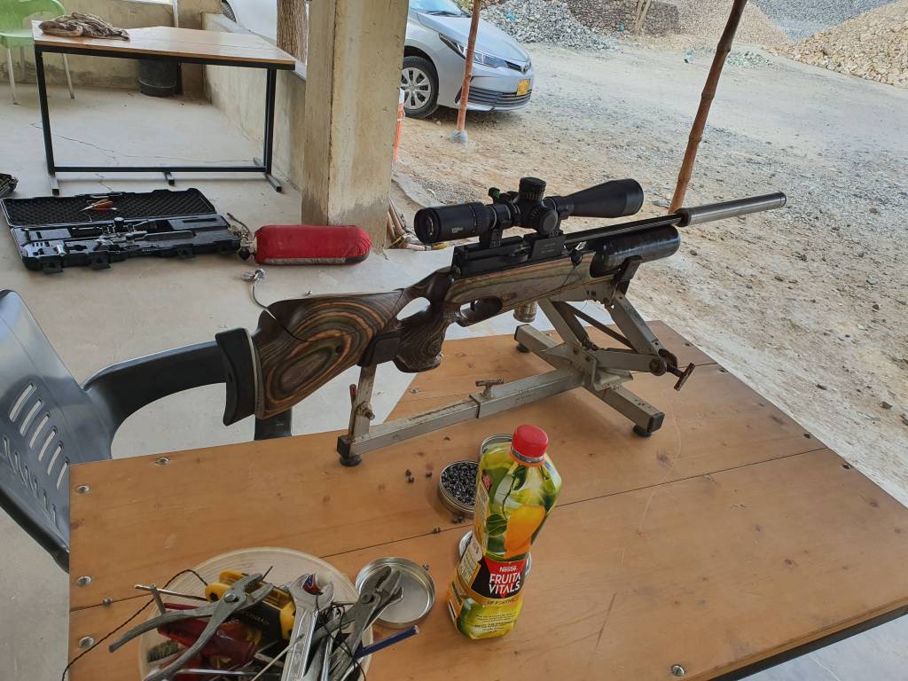

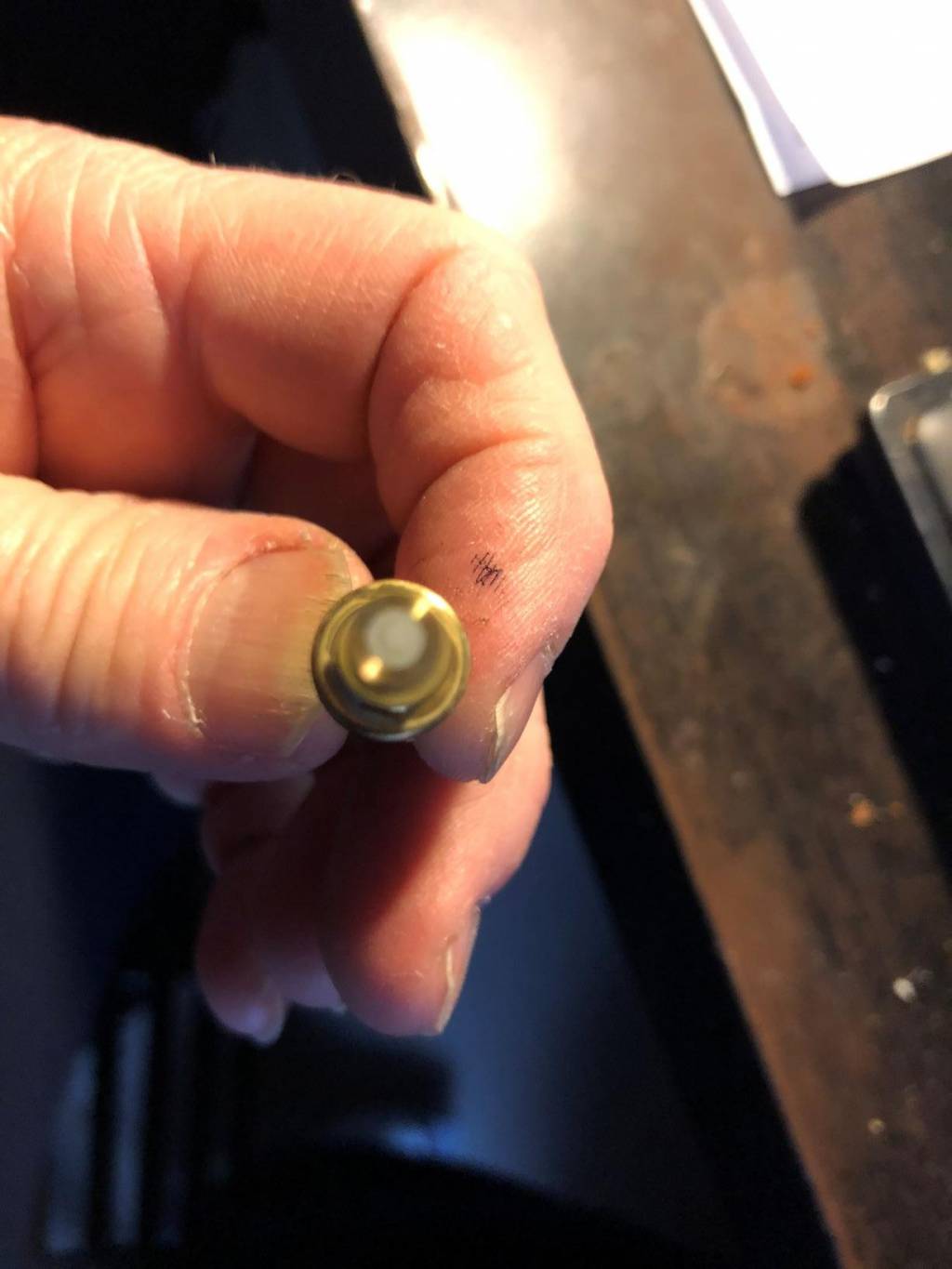

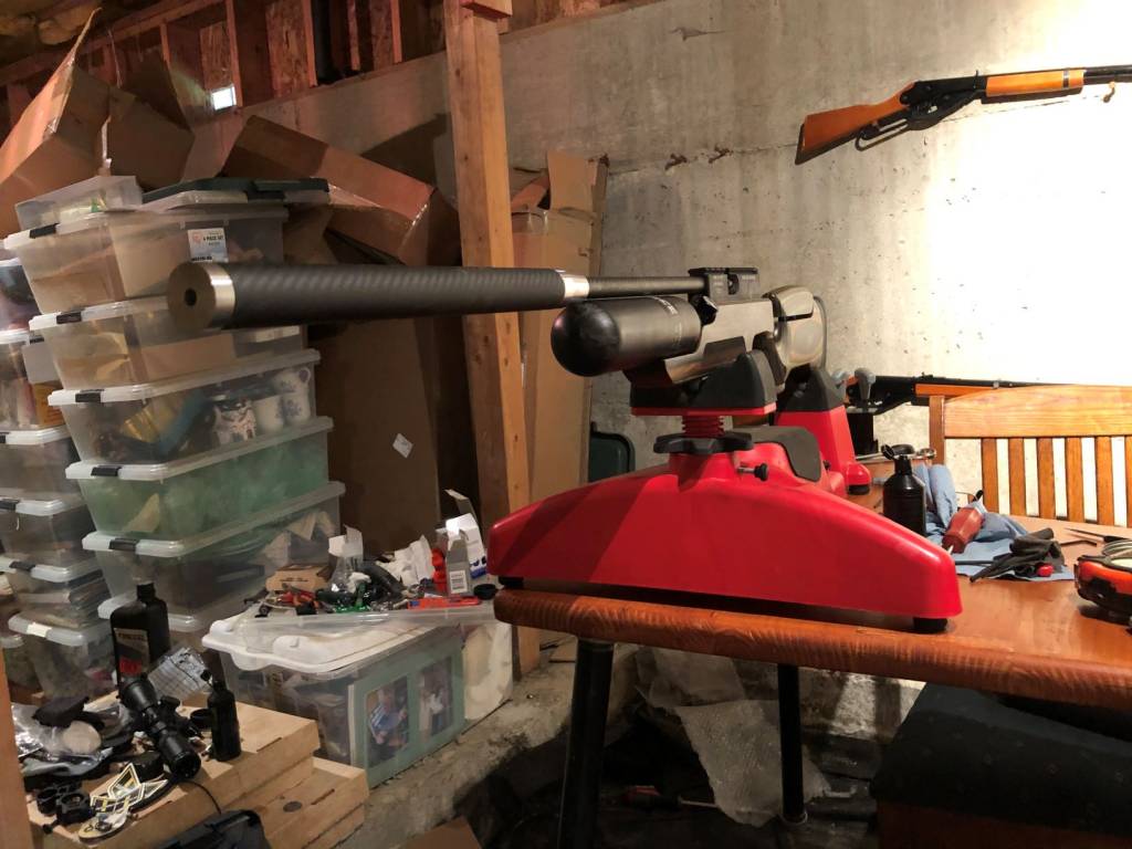

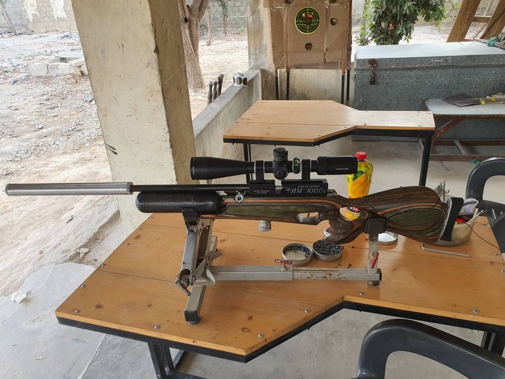

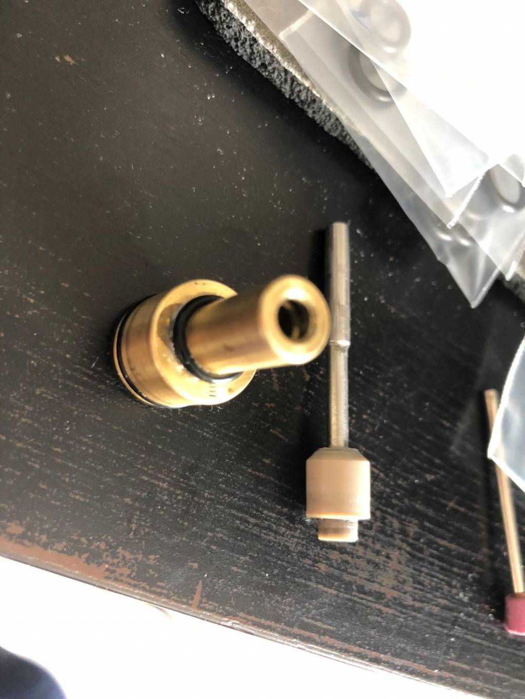

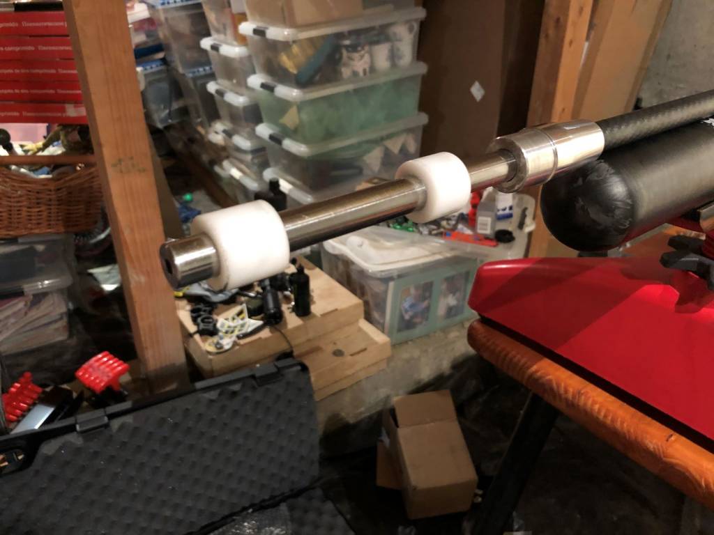

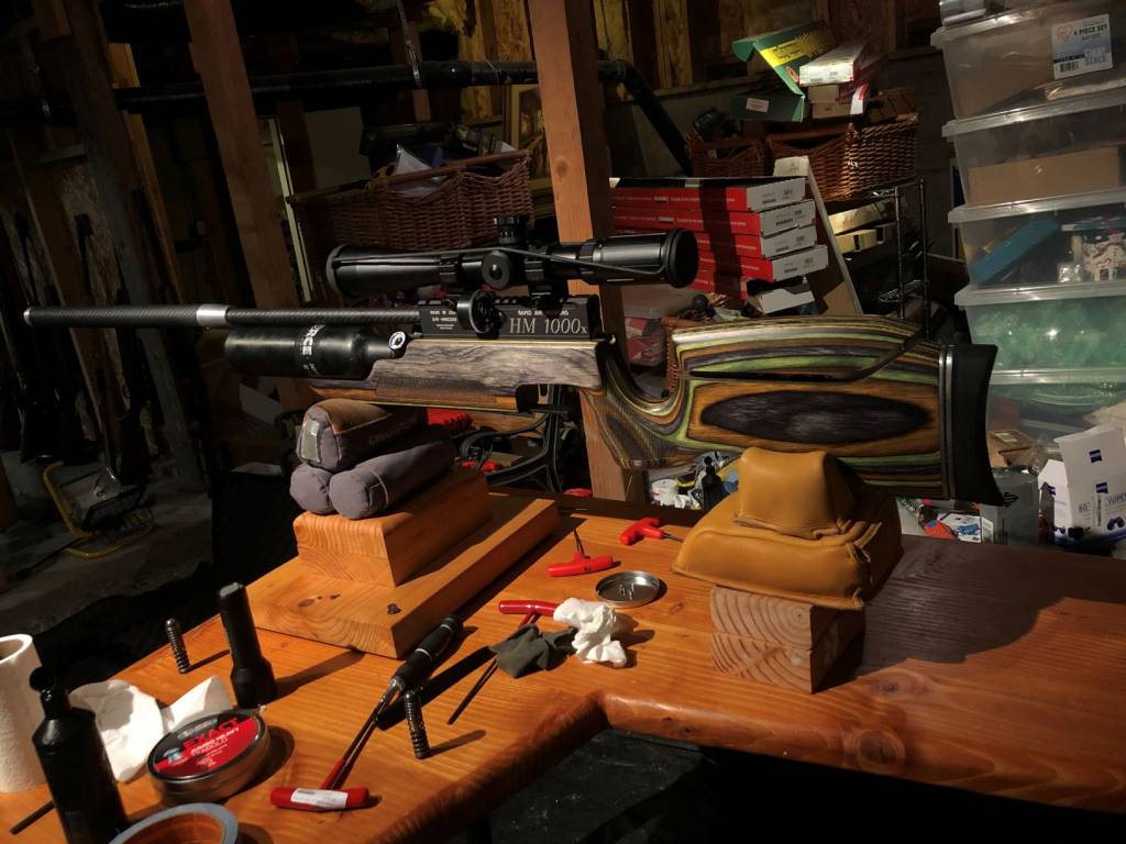

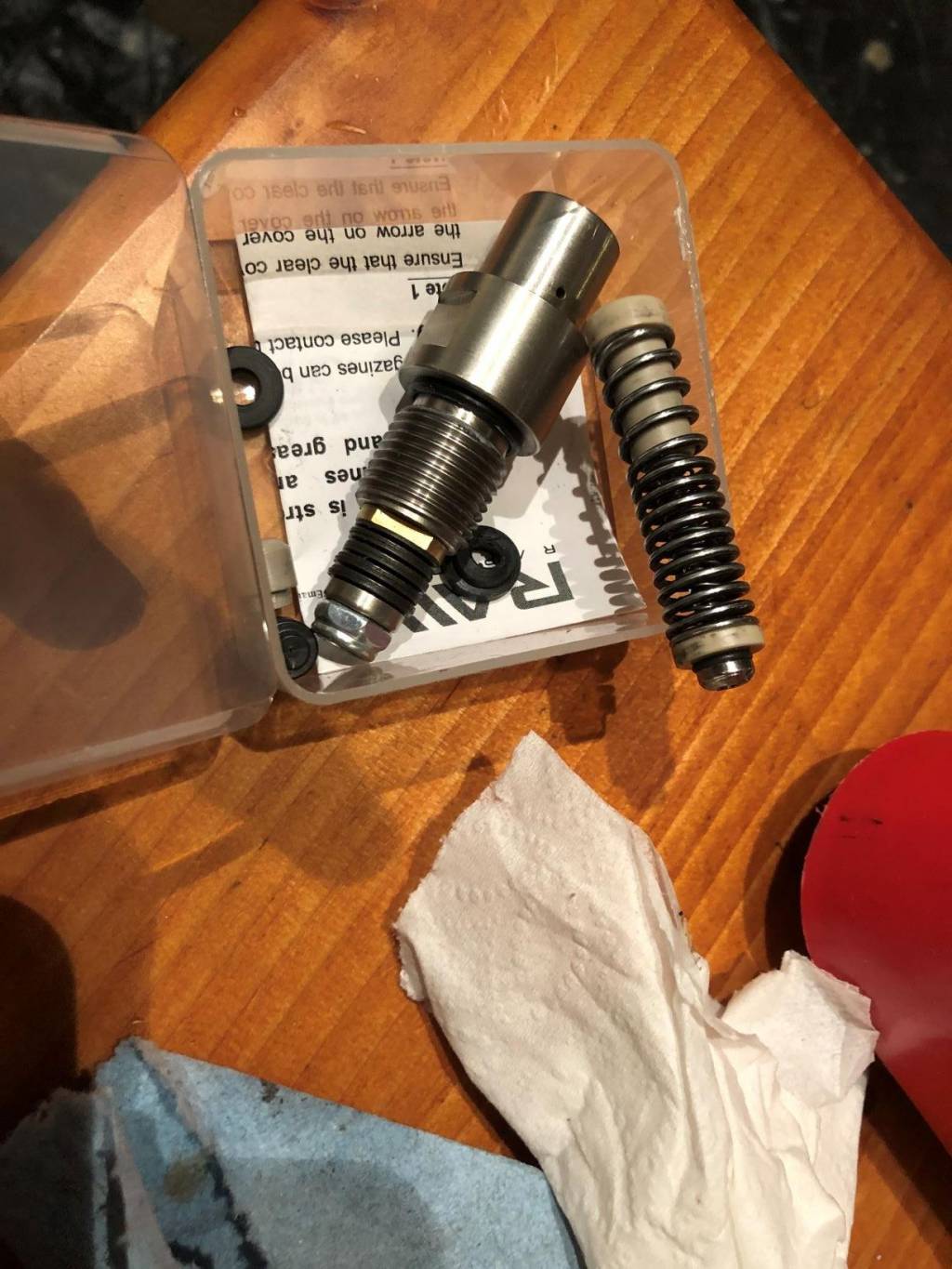

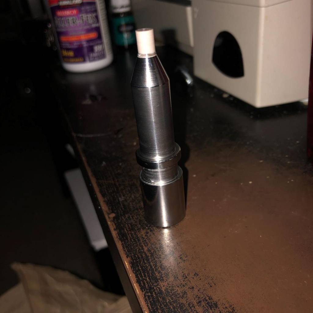

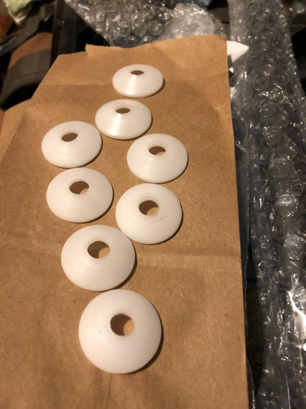

Hey Mubhaur,
Here are some pics of the mods I have done. I usually get lost in time while working on the gun and really never take many pics.
Started with this:https://www.pyramydair.com/product/raw-hm1000x-lrt-air-rifle-camo-laminate?m=4797
Ended with this:
Along the way changed out LDC, butt pad, spring guide assembly for a SSG, hammer tip, valve poppet, regulator seat, TP doughnut and regulator set-point.
