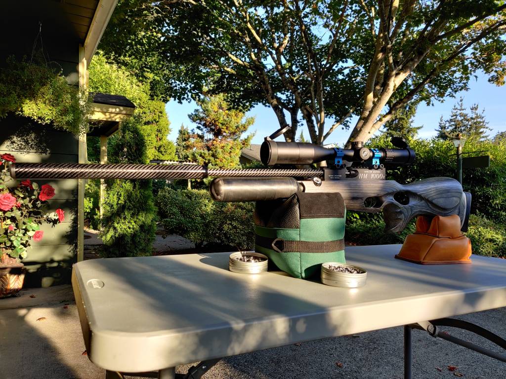

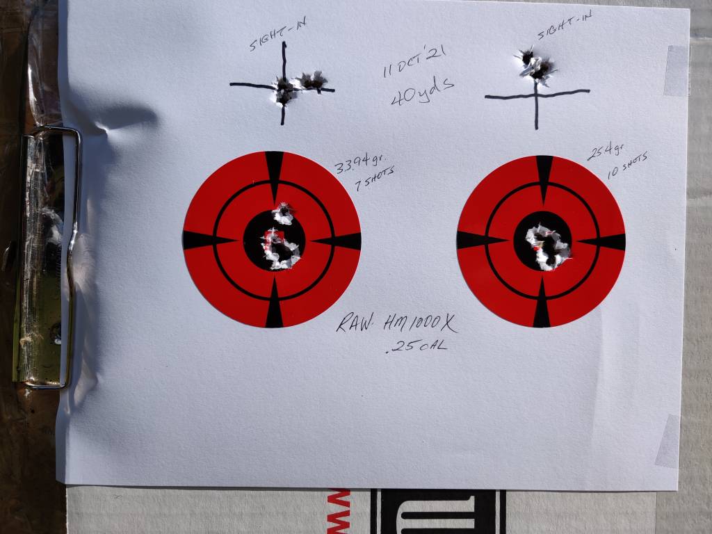

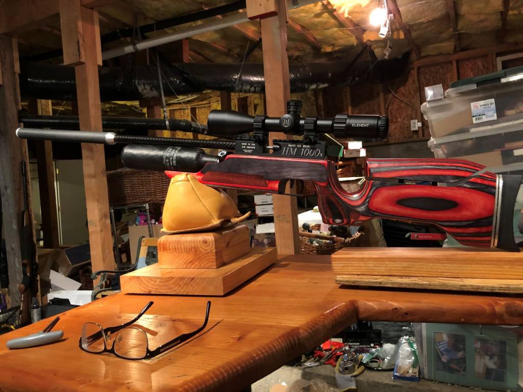

IMO the Muffler style moderator completely ruins the look of the HM1000xLRT and needs to go in all forms. At moderate power levels my .22 cal. get 160+ shots per fill at 35 FPE up to 250 bar and my .25 cal. gets 108+ shots per fill at 50 FPE. As I venture up to 33.95 grain pellets and slugs things my change. Power valves or larger plenums used by Mubhar and FX lead the way.
