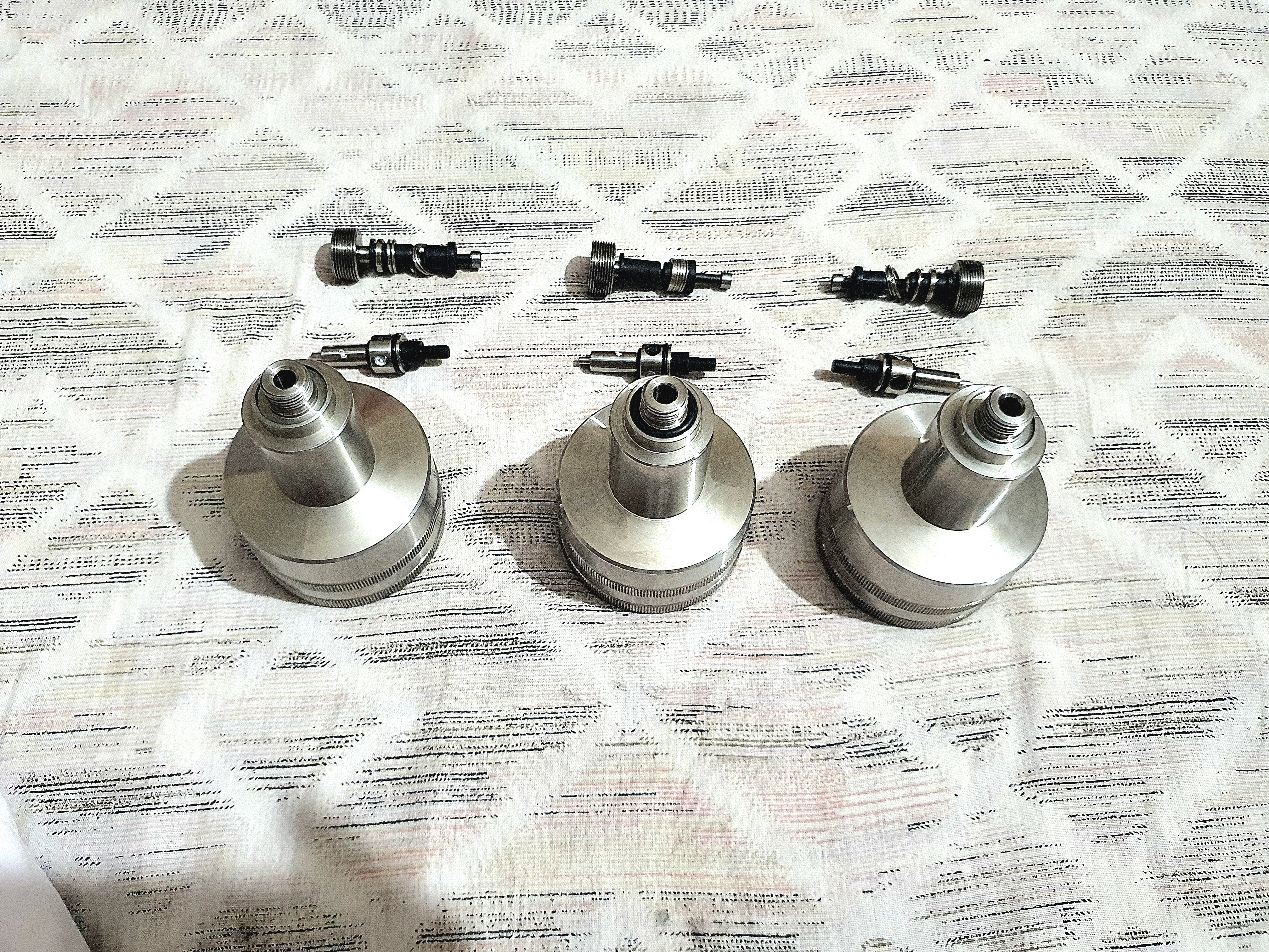

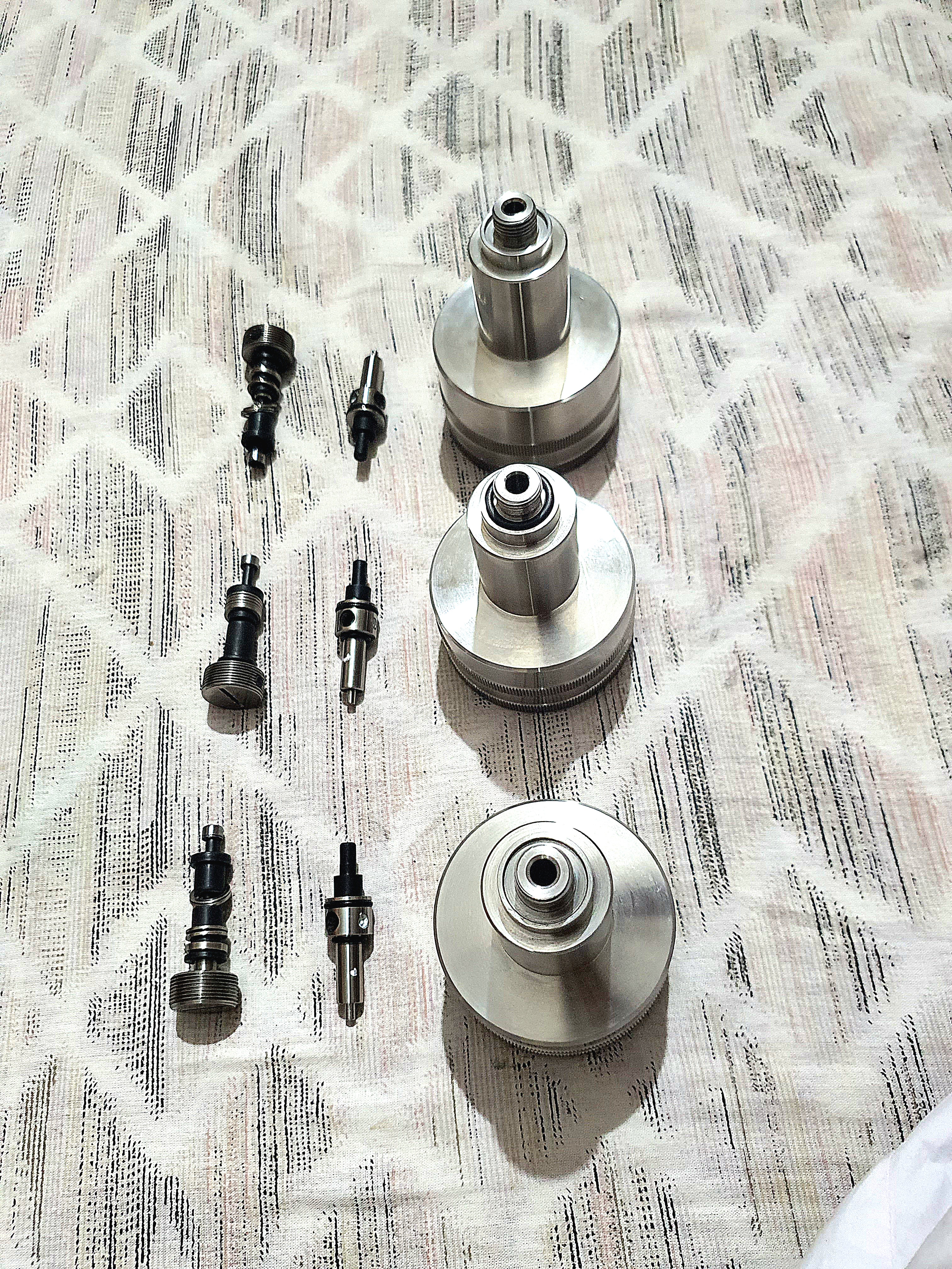

For two friends from US and a friend from Holland, three sets of high efficiency quality tested parts for RAW HM1000X are ready for dispatch.
70cc and 80cc external plenums
High efficiency valves
Anti hammer bounce devices

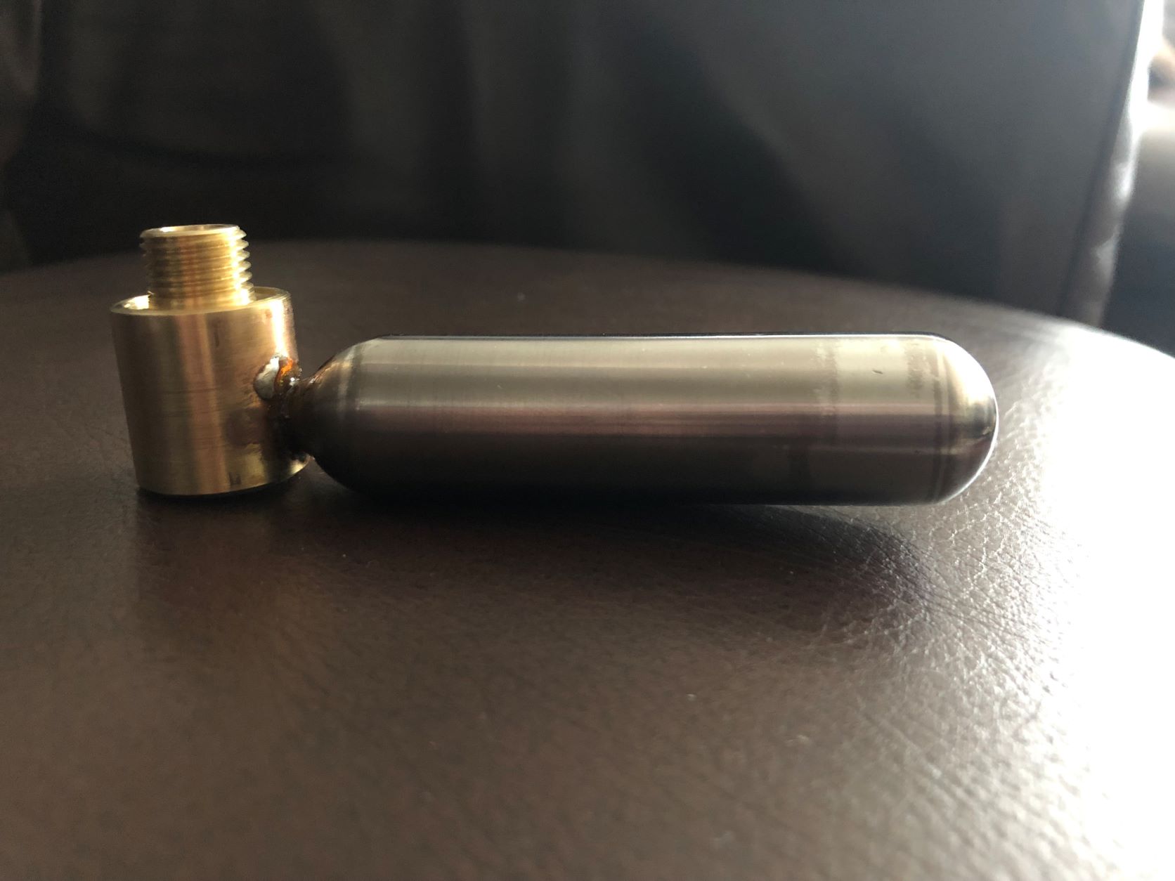

Also, I've added 20 CC's of plenum to 1 of my RAW's .... which I believe gives me about 50cc's of total plenum space.
It's almost seems unnecessary to add more than 50cc's unless your shooting a .30/.35 caliber RAW:unsure:.
The most power I would ever need in .25 caliber is 70FPE -> Hence I think a 50cc in plenty!
What do you think?

Yeah, even Martin will not confirm the plenum size, although he likely knows. Last speculation was 30cc, but ....
Right now - I'm shooting 34 grain JSB pellets to about 895/915 and used 950/960 fps as a max to conservatively get 70FPE.
Given that power lever a 45cc or 55cc total plenum would give .643 or .786 ratio to FPE:) .... not ideal, but far from a problem.
Since your max squeeze ratio is .334, my plenum space is about 2x the max or more.

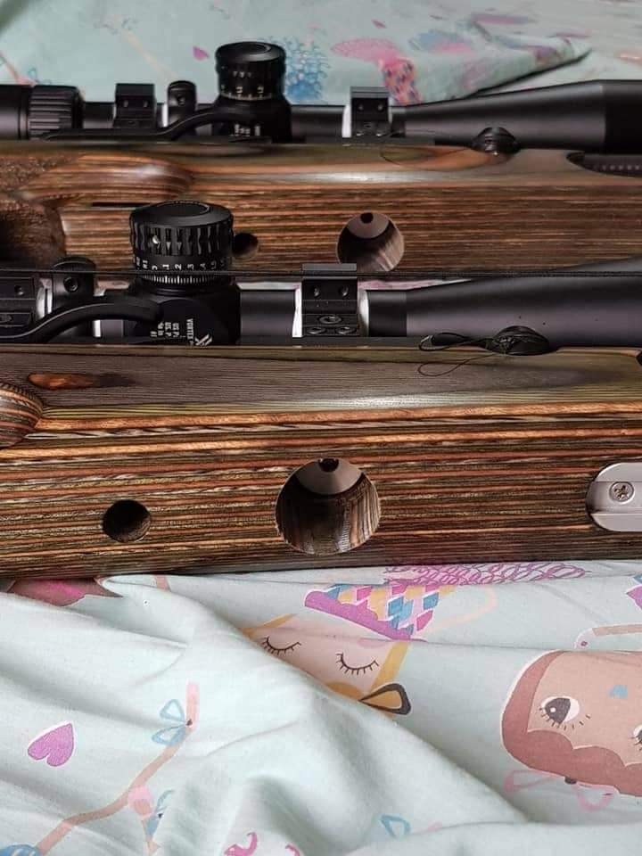

The pics below reflect it's somewhat crude appearance relative to yours; thankful that it's hidden underneath the stock.
Reactions: mubhaur

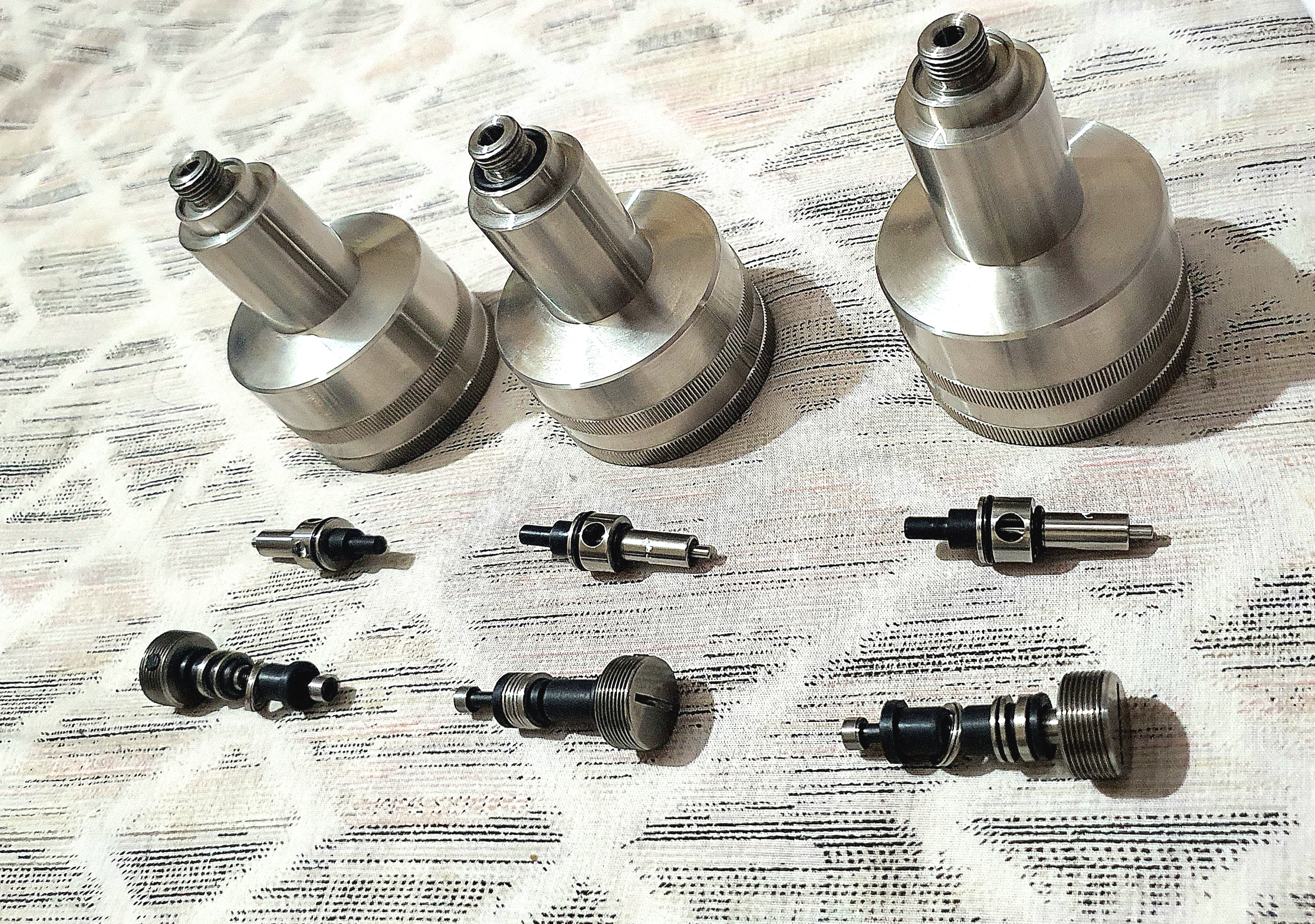

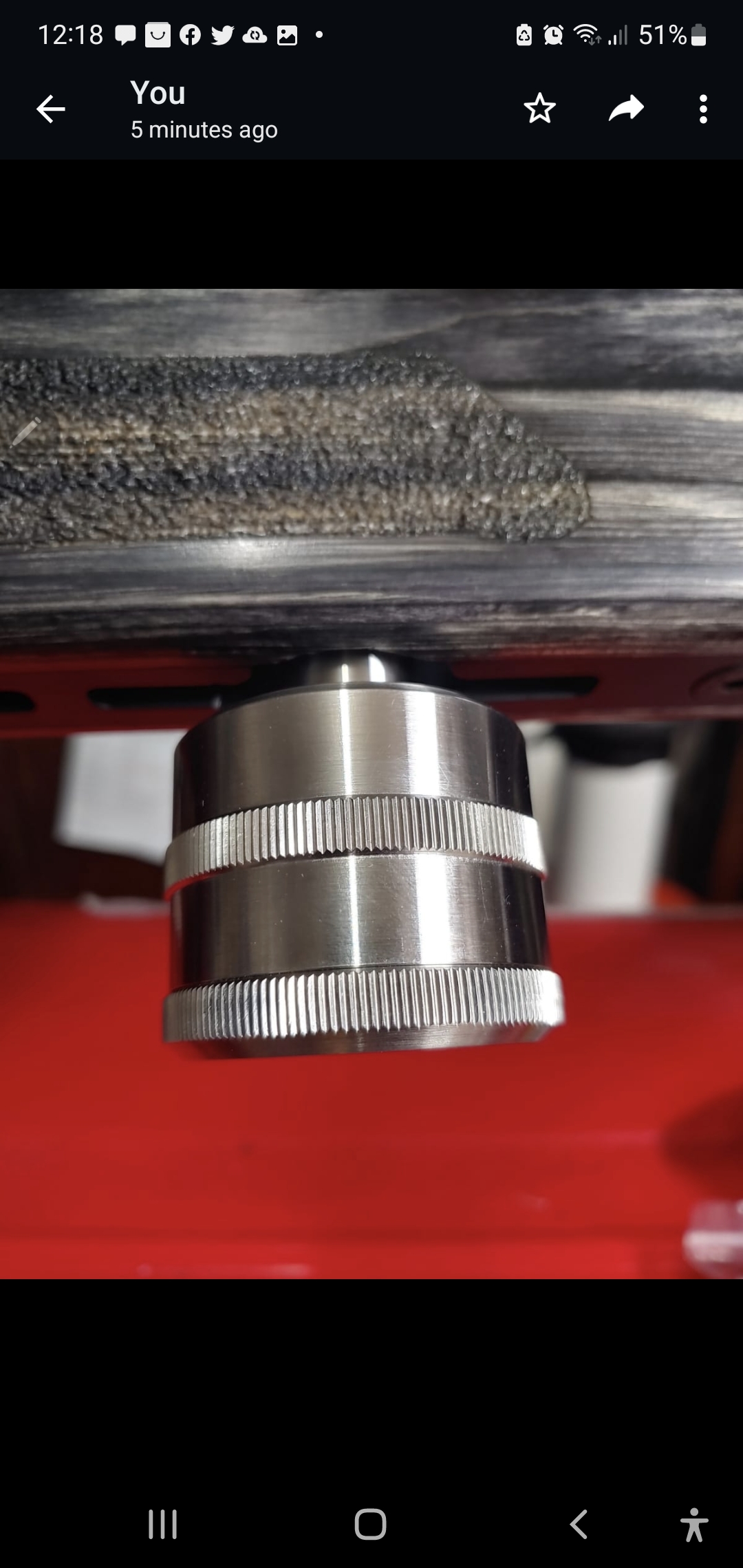

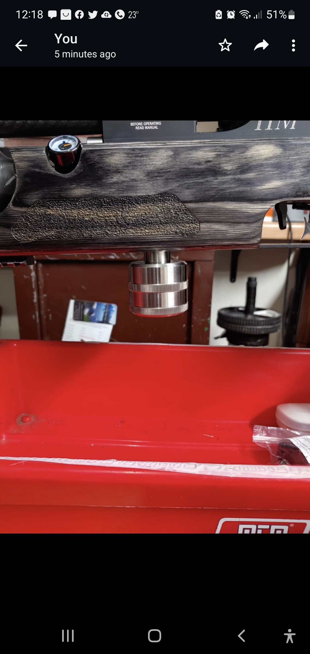

Umair, We need some help on purchasing two of your Vertical Plenums for our RAW air rifles. We shoot Benchrest Competition 25 meters and 50 meters. We will appreciate any help or information on this. Sincerely, Doug and Vipha Miller you can verify us: Google: "Vipha Miller " my wife. Thank you.
