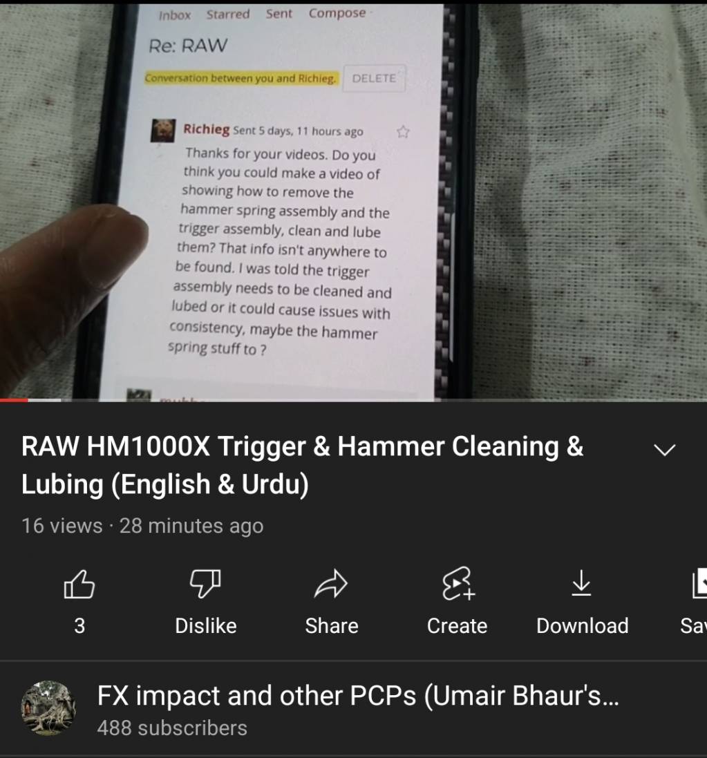

Tuning RAW HM1000X hammer and trigger assembly removal, cleaning and lubing video
mubhaur
Nov 8, 2015
1,470
65
Karachi, Pakistan
    https://youtu.be/RQRxSe-44bA
    P. S. Looks strange that I have copied the link here but it is not being reflected when I save the post. But one can see it on my YouTube channel.
    On the desire of Mr. Richie, a member of this forum, I have made the above video.
    I hope it will be helpful for other users of RAW as well.
    Umair Bhaur

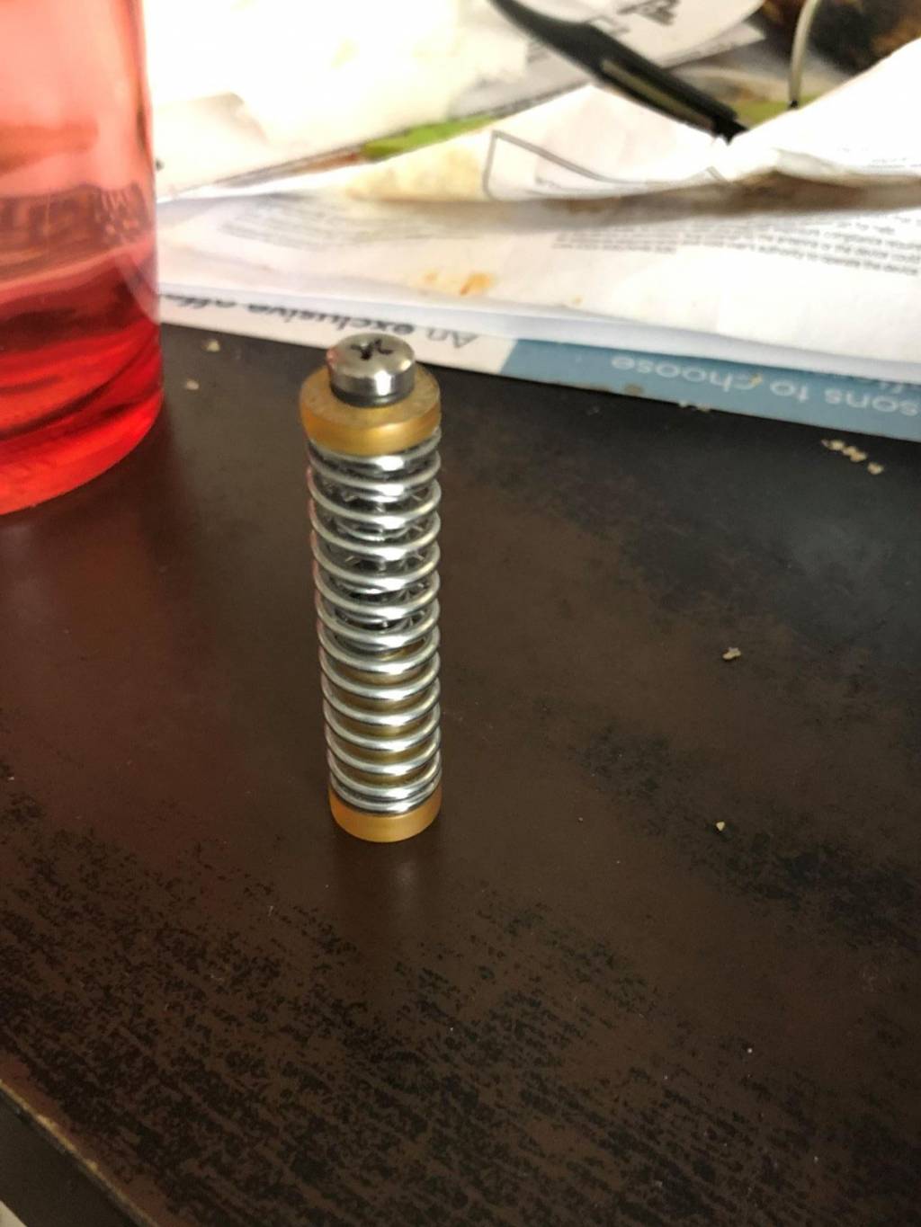

      Hey Mubhaur,
      Make a video about the benefits of using a SSG vs. the OEM hammer de-bounce system.
      This is likely the cheapest/most significant MODIFICATION that can be added to improve a RAW's efficiency.
      Hear hear !! you got that right !!!! few years ago when figuring out a way to do it in the RAW / Theoben and built the first ones have NEVER looked back on not using SSG devises where they can be implemented.
      The inclusion of the SSG mod gave me:
      - 150+ shots in .22 caliber using 18.13 grain JSB pellets at 950 fps.
      - 110+ shots in .25 caliber using 25.39 grain JSB pellets at 950 fps.
      For folks seeking higher power, the SSG is still beneficial, however, at decreasing rates as additional power is required.
      Given higher power requirements, an additional Plenum is the next necessary step.

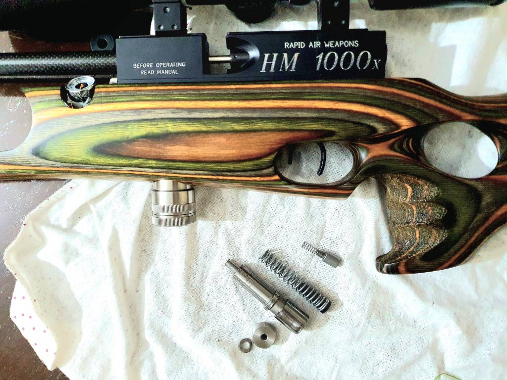

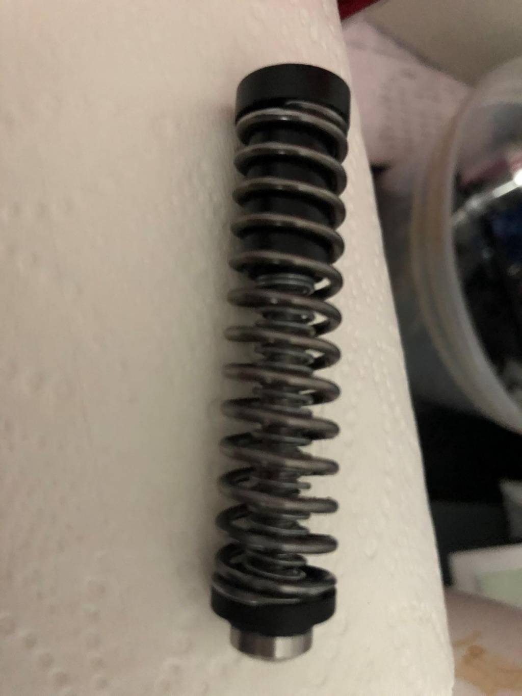

        I was asking for the SSG anti bouncer .
        There are a few things for which I need the action of RAW for SSG.
        If I replicate the one like I use, it might not work in your gun as sometimes the tolerances are different.
        Further even if I arrange as per the specs of my SSG, you will need to arrange an appropriate spring for SSG.
        In fact I too imported the SSG spring as I couldn't find good springs here.
        Bhaur
