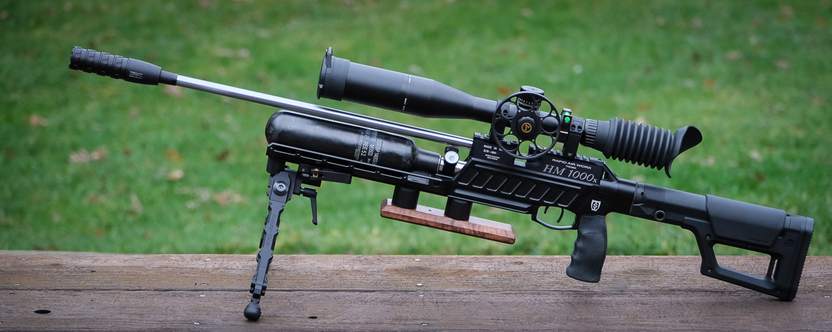

On the Chassis, I've added an MK Machining zero angle grip, and a Gray OPS Swiss Arca rail. The rail adds weight but makes the platform more versatile with where I can place a bipod, flashlight etc, it also protects the carbon fiber reservoir.

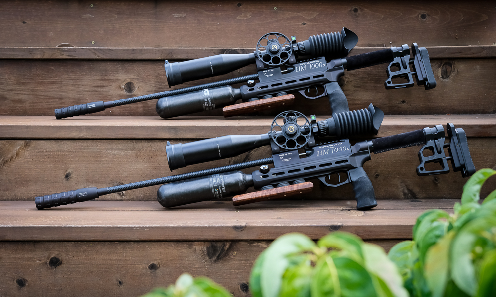

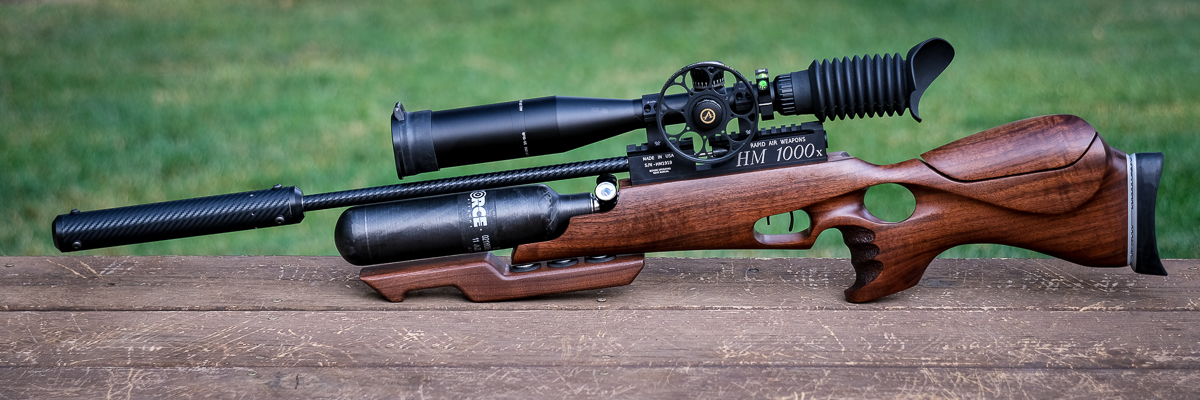

We also have a RAW HM1000x with a chassis except that my son uses an Ergo Air grip and a Seekins Precision stock. We’ve were considering a Gray Ops rail too but since my son mainly shoots off of a tripod, we decided to just stick with the rear Arca mount. I understand you’re using a laminate stock and can probably find a hamster that attaches to the RAW’s T-Slot but the chassis really is so much more versatile. We had a LRT stock and thought it was the greatest. Unfortunately, iIt broke, was replaced with the chassis and now, my son would never go back to an LRT stock. He loves the chassis version of the RAW. It’s all personal preference…You could try it and always switch back if you didn’t like it? Rapid Air Worx is coming out with a few cool accessories in 2022, maybe one of those will be what you’re looking for?

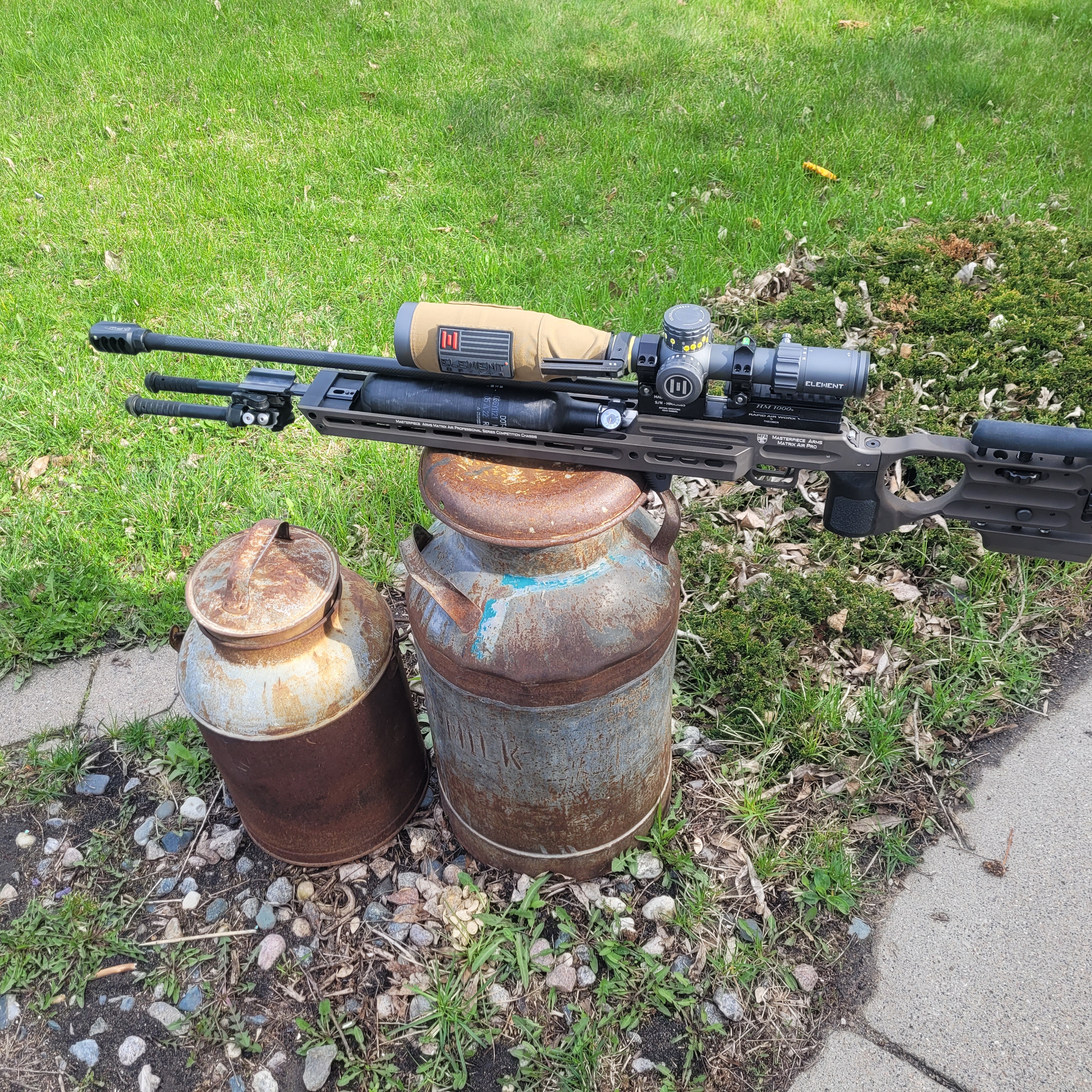

Mine Was a uk spec sub12 ftlb ,since buying it I have taken off the original buttstock and fitted the MDT , pistol grip is a magpul ,side biathlon lever , Xl sound mod ,Picatinni risers with fx no limits rings opened the barrel port raised the reg shortened the hammer and changed the hammer spring ,the gut is now running at 32 ftlb with about a five fps variation over all shots whilst on reg ,still do is the factory Raw valve ,the uk is the Theoben type and a new polygonal barrel at 24” that should get me upto 50 ftlb
