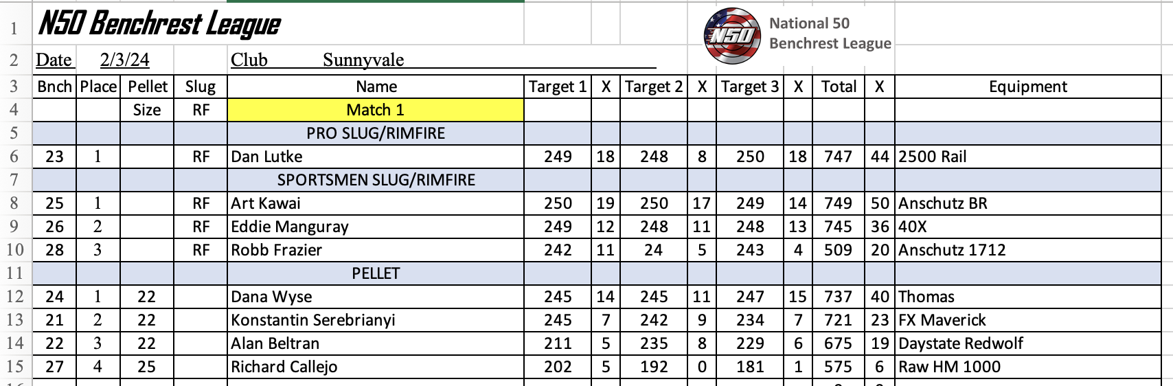

This may not be an accurate answer to your question, but here are the results from my N50 match earlier in February. Look at the pellet section.
A gun is only as accurate as the barrel and projectile, if both of those are good then consistency of velocity and smoothness of action/trigger are critical. RAW use quality barrels, the blocks are built to a high standard and the trigger is one of the best on the market. Find the right pellet and the right speed for that pellet , then yes, the RAW is more than capable.
Unfortunately my RAW easily out shoots me☹️
I would say highly accurate and one of the best triggers out there. The only gun I would ever consider over the RAW is a Thomas.
