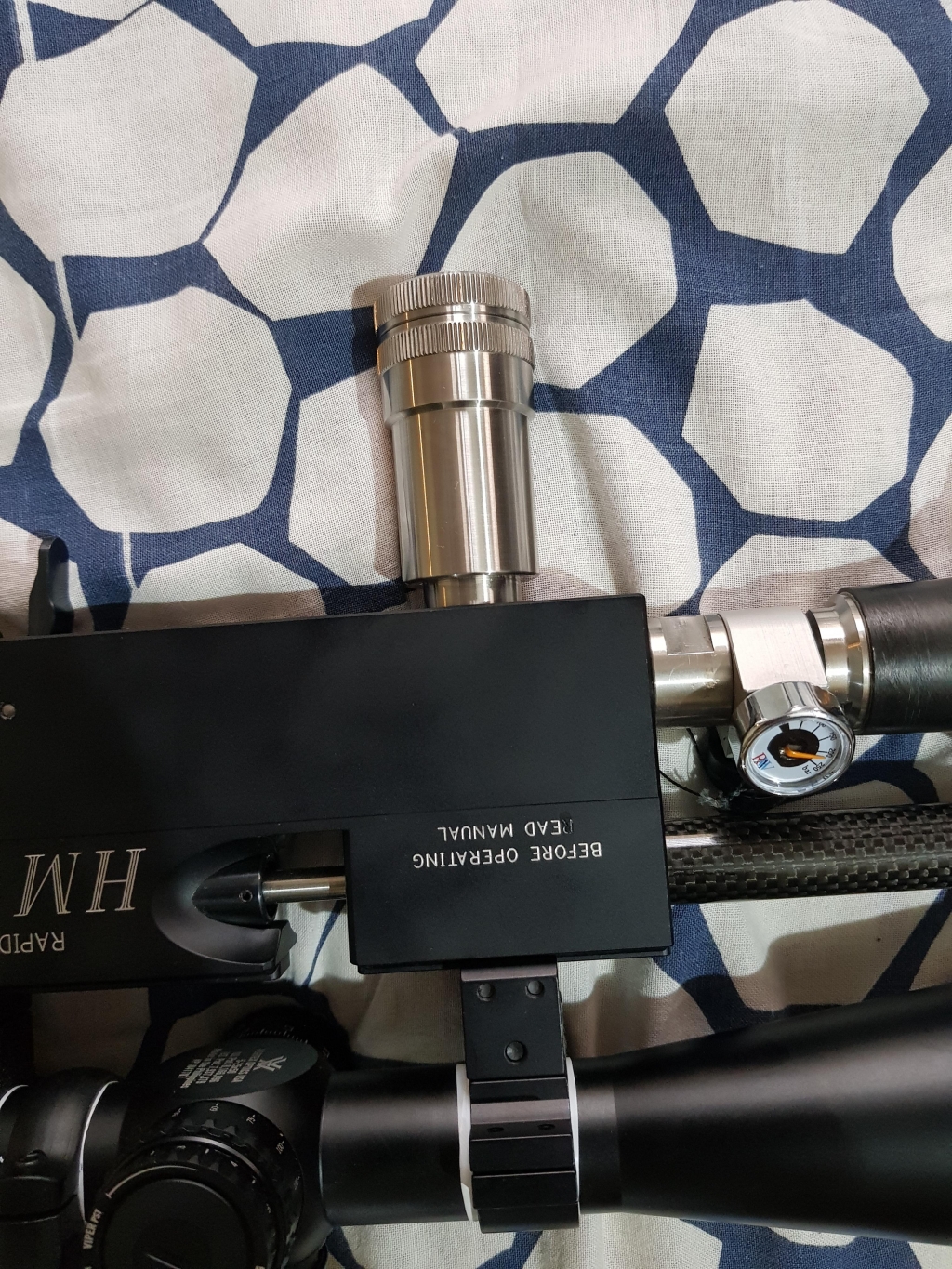

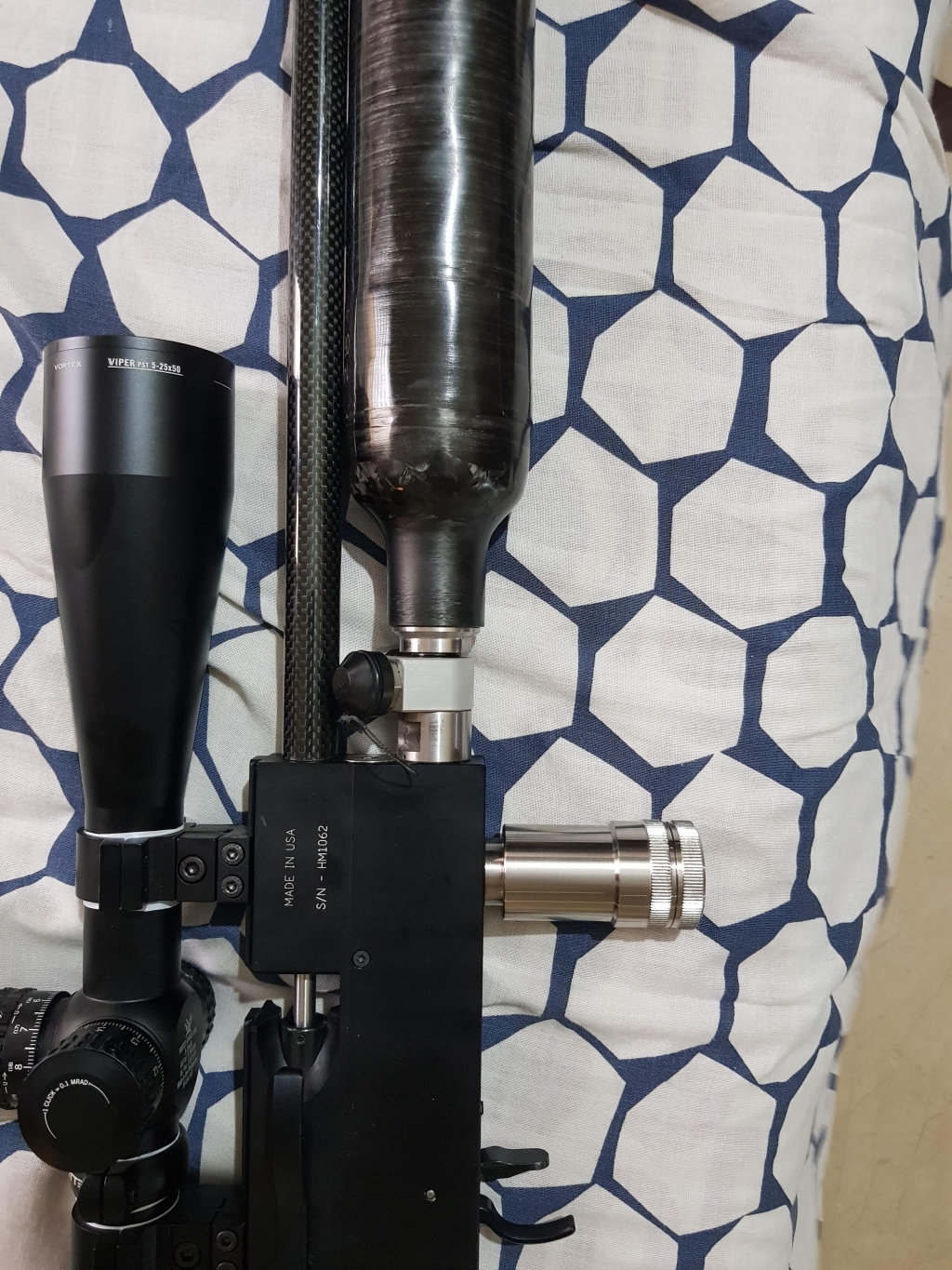

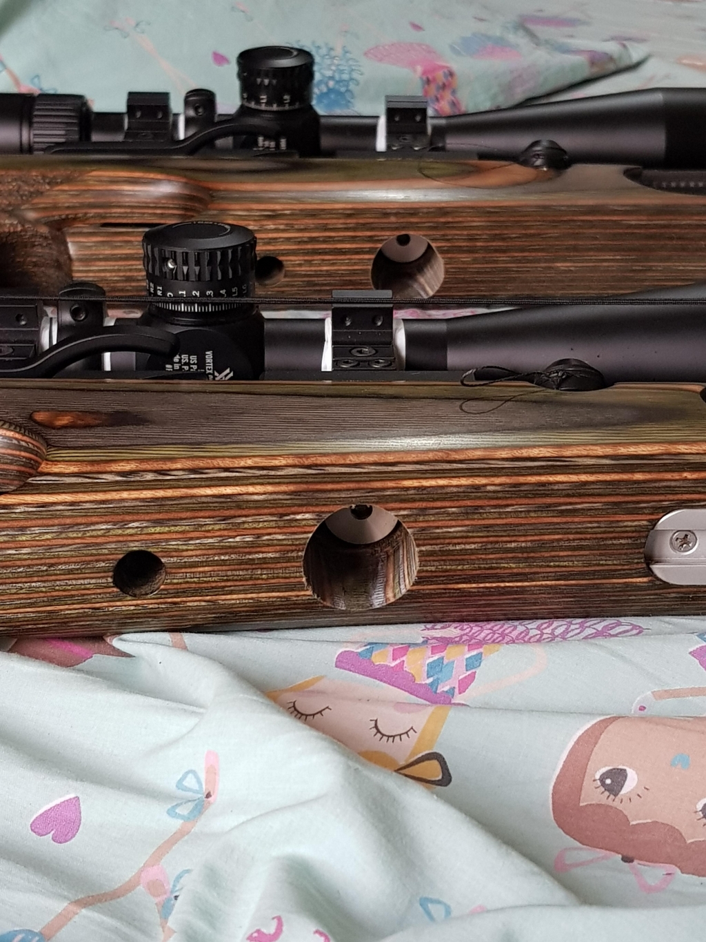

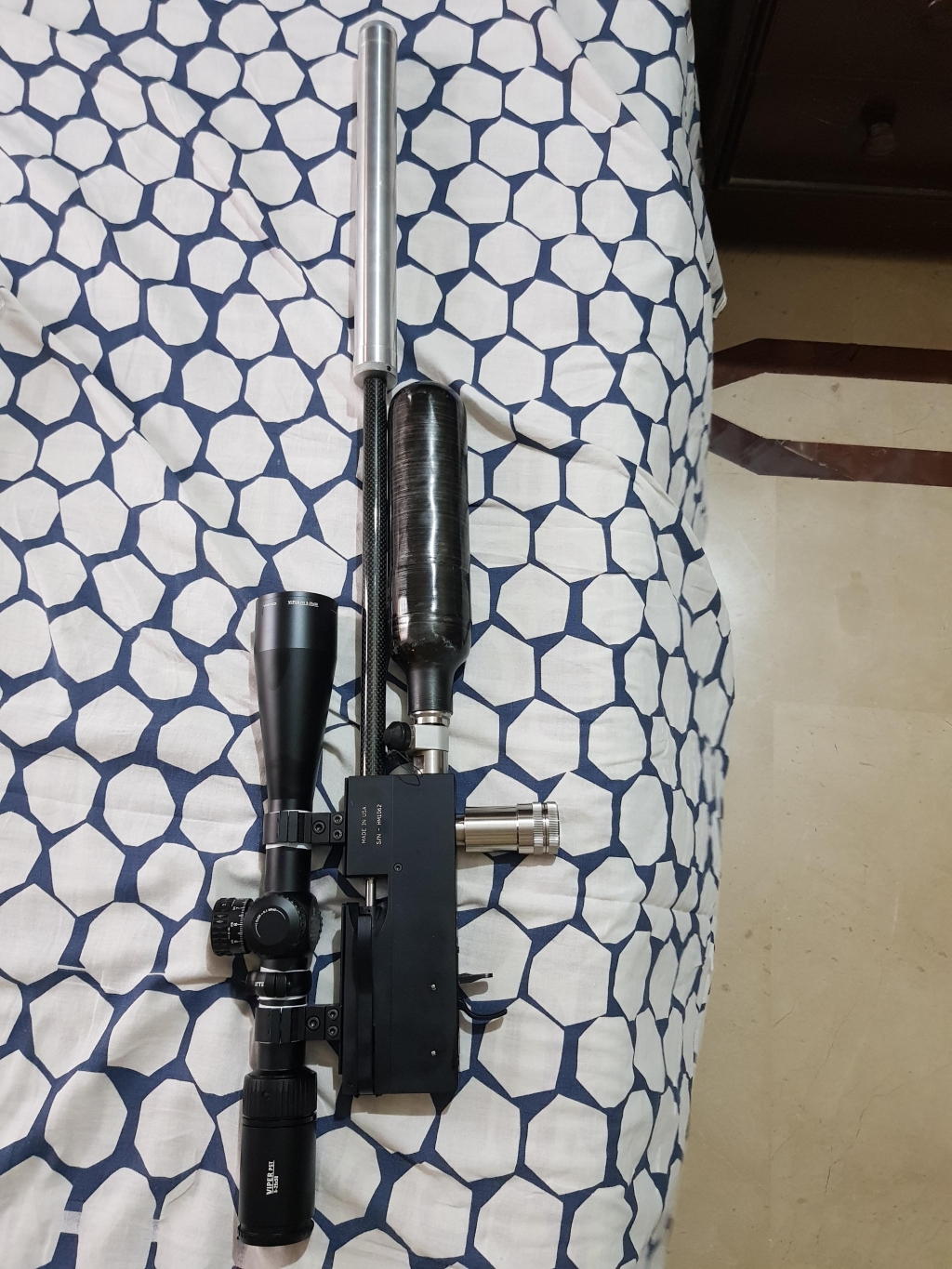

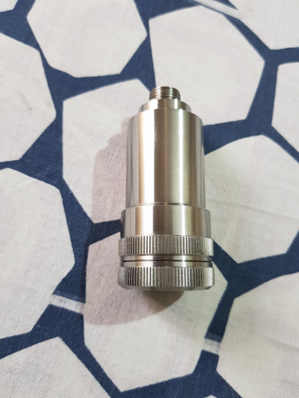

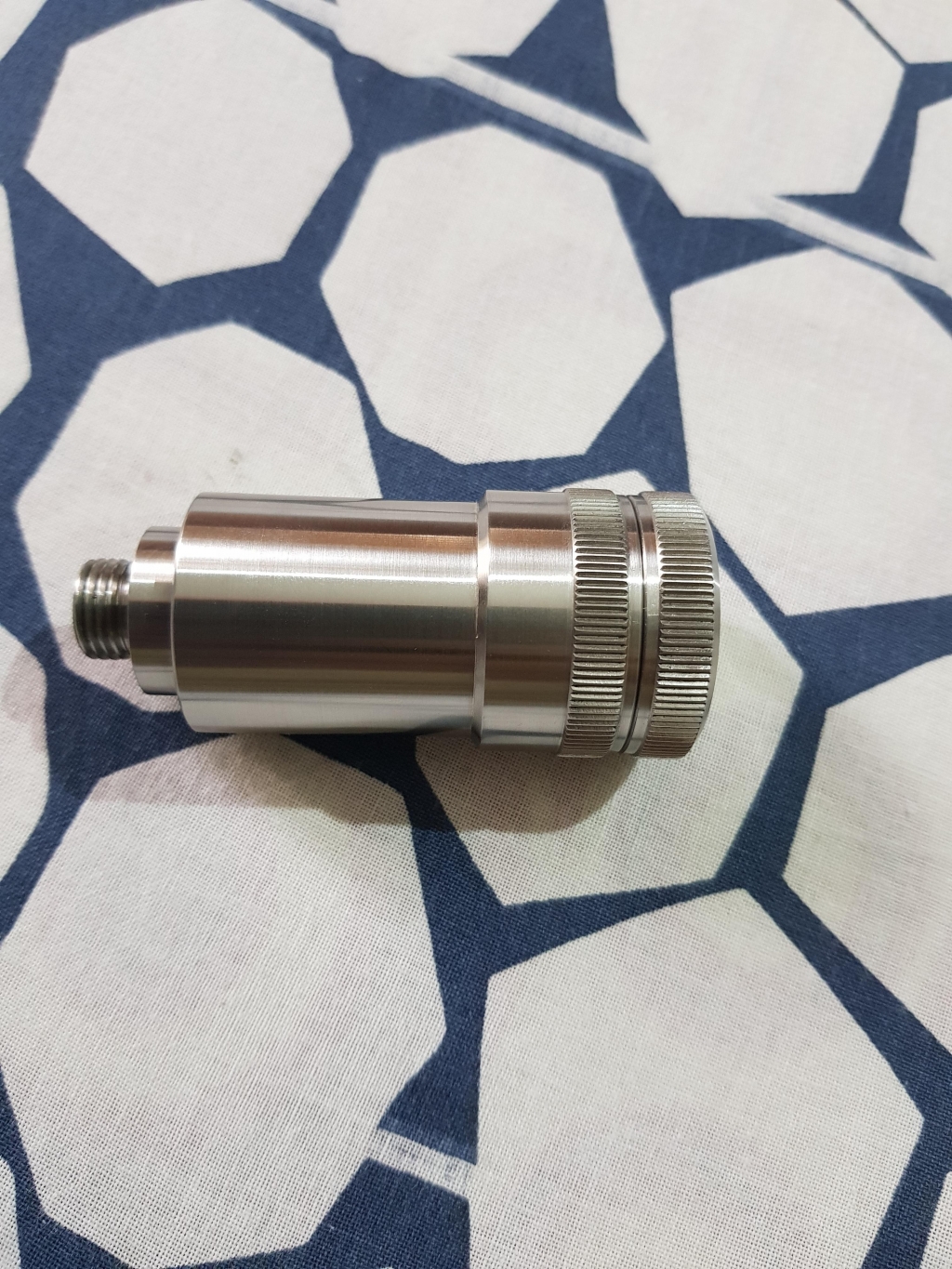

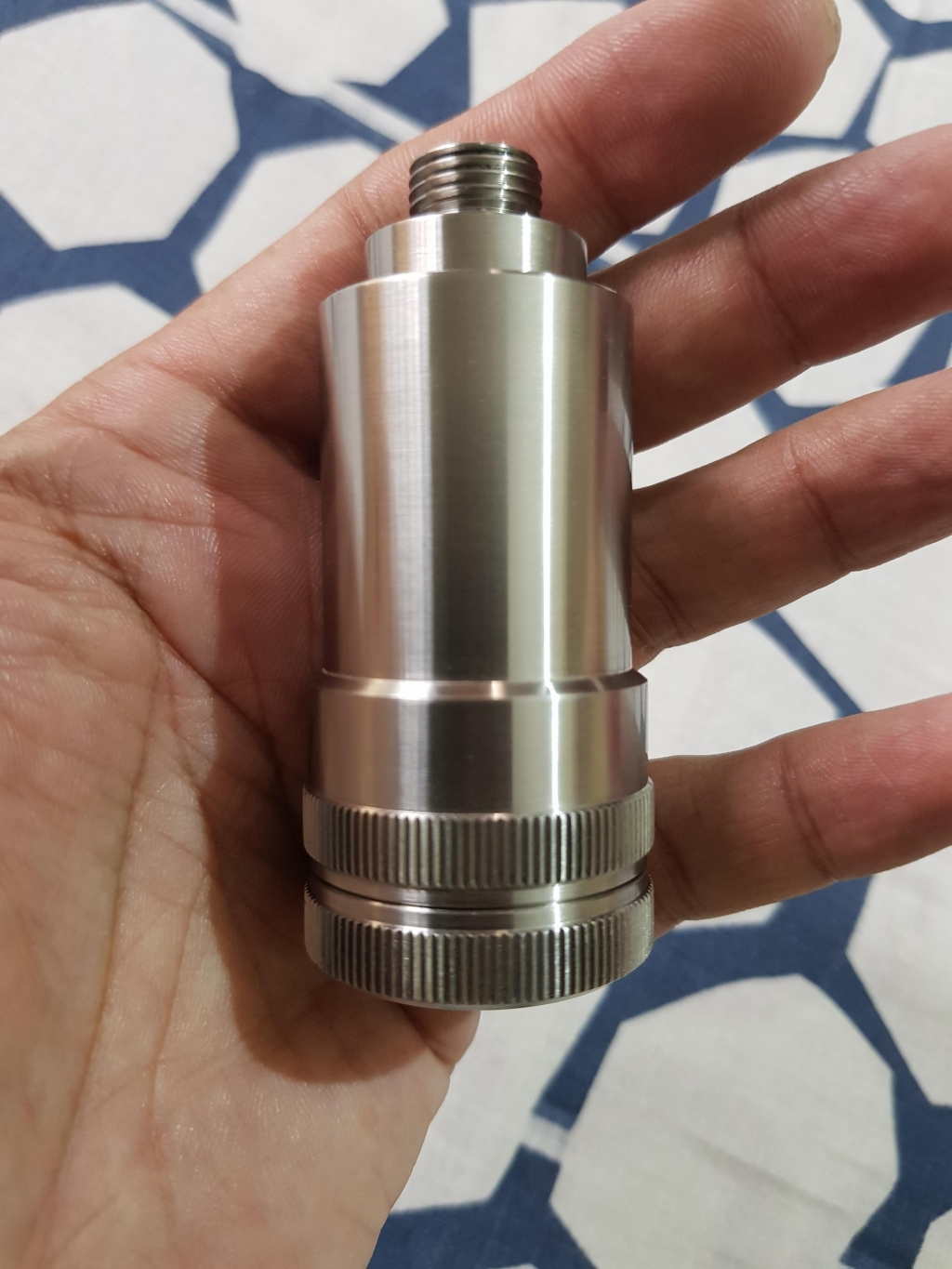

I just got machined and installed an external plenum of 25cc in my RAW HM1000X .25 60 ftlb version.
Before the plenum it was doing 900 fps with 34 grain jsb and after installing the plenum it jumped to 950 fps.
I didn't touch any settings. All the increase of 50 fps is just due to additional plenum.
Hope you enjoy.
Umair Bhaur

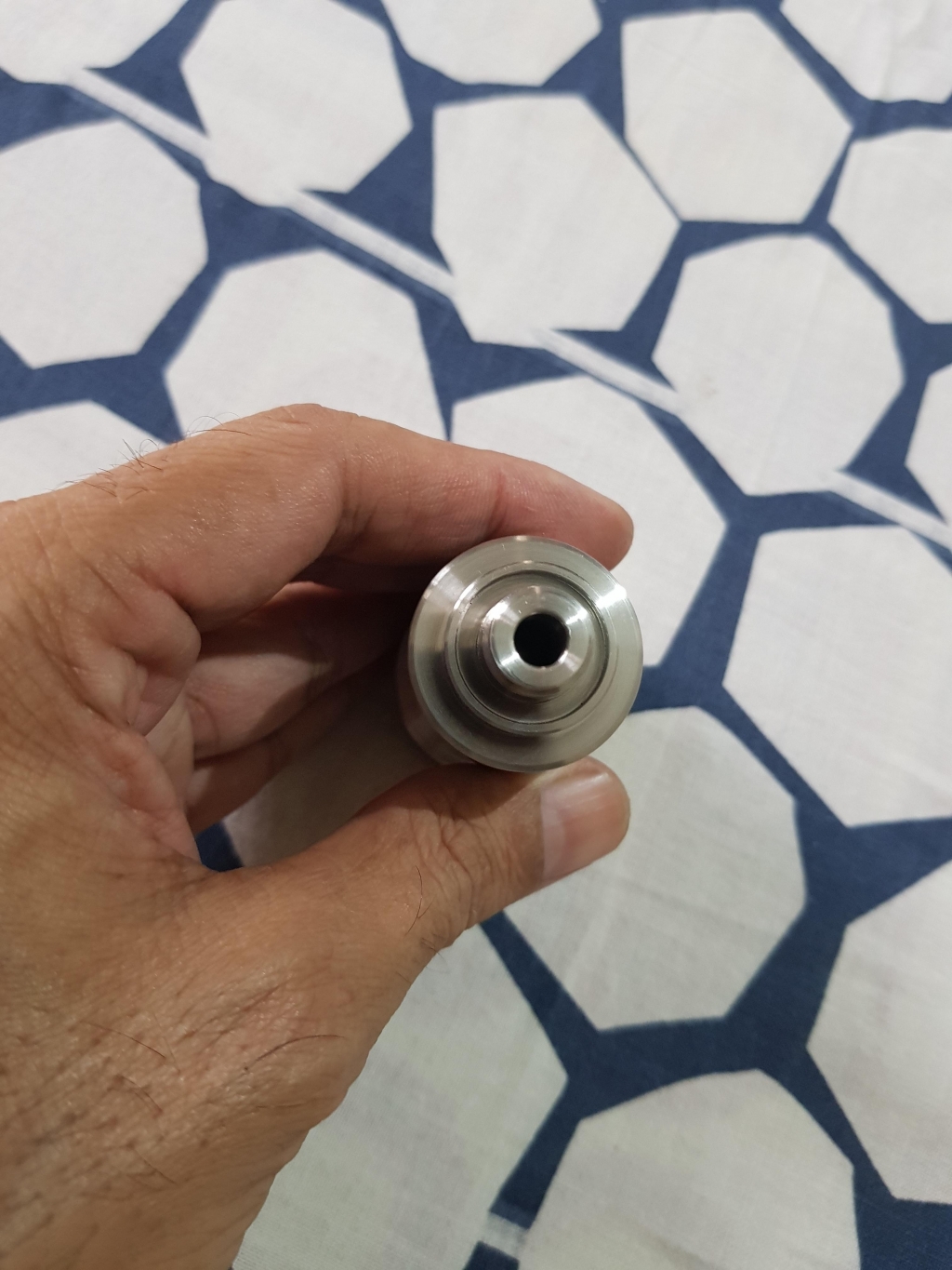

Is there a gauge on the bottom of the plenum? Of all the photos you posted, not one show the bottom (end) of the plenum. Thanks,
Mike

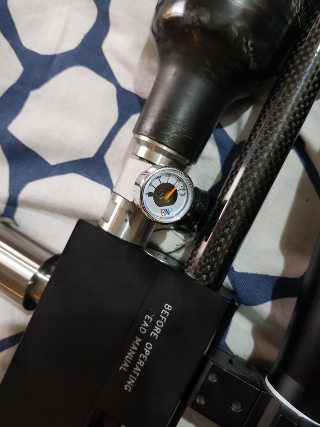

No I didn't make option of regulated gauge at this stage as it will protrude from the stock, it can break.
However I will make one more end cap with the gauge option. That I will use carefully only when I will have to check or adjust the reg pressure.
