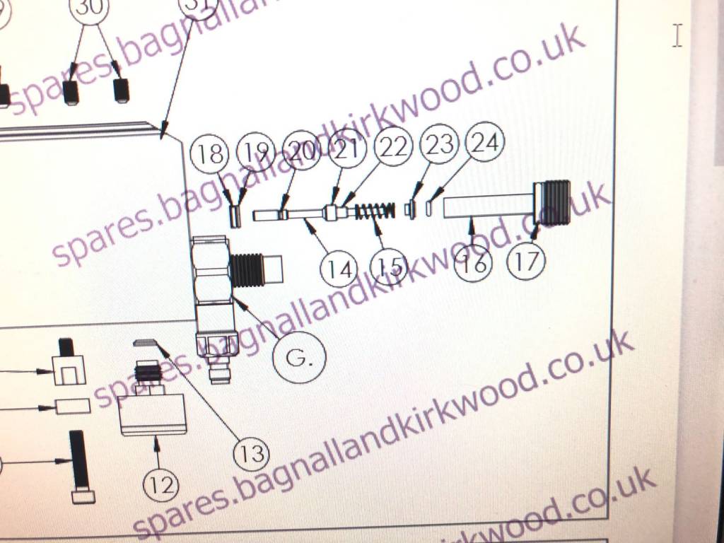

Hey Mubhaur,
It looks like were replacing D 14-24 (less part 18 & 19).
Yeah all of that I believe was replaced but is using the stock valve with the oring in the rear of it I believe he said the spring is now on the outside of the valve area and is adjustable from the outside with a Allen wrench so it is easily adjusted or changed from the front that drawing must be for the new after air force took over the gauge location is different and screws in the bottom as well as 16 17 23 24 are different in pre air force not alot different though 16 17 and 23 are all one part in pre air force and the gauge is in the part for filling on the reg otherwise it looks the same
Oh ok he just extended the poppet and sealed poppet end with original oring valve extended the rod threw the valve spring guide plug with a oring and a chamber to install a spring which is adjustable with Allen wrench is way I understand it don't think he used any of fx parts at all to modify the raw valve they were all custom made but is using the same idea as fx valve but the poppet spring is on the outside in a adjustable chamber like set up I'm sure he can explain it better than I can or even correct me if I got the wrong idea too
OK, he just extended the poppet and sealed poppet end with original valve o-ring, extended the valve stem through the valve spring guide plug, with a o-ring and chamber to install a spring ... which is adjustable with Allen wrench - is way I understand it. I don't think he used any of FX parts to modify the raw valve, ... they were all custom made ... using the same idea as fx valve, but the poppet spring on the outside in a adjustable chamber like set up? I'm sure he can explain it better than I can or even correct me if I got the wrong idea too.
Hey Airgunmann,
I believe he used a modified "Power Valve" made by Bucketboy and then used the entire FX design ... except - adding an adjustable threaded tube to tweak, valve spring tension or to completely change out the spring if desired. Seems to me the valve rod assembly and poppet need to be pretty precise, otherwise ... together they won't seal properly using the o-rings between the valve and guide assembly.
No finally I did not use stock valve. Rather I used high efficiency valve without O ring in valve body. There is a delrin guide in valve body.
As a later thought I found it to be better and more efficient design.
So there is difference in fx design and my design.
You are correct.
