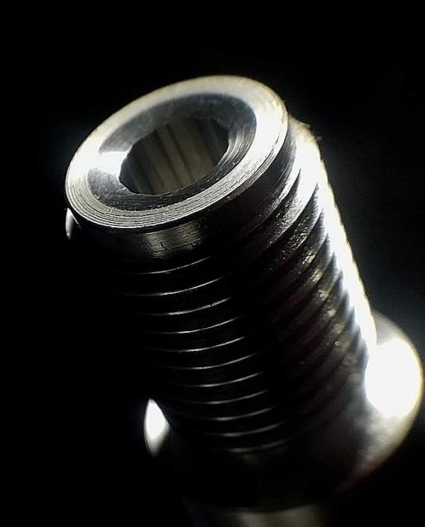

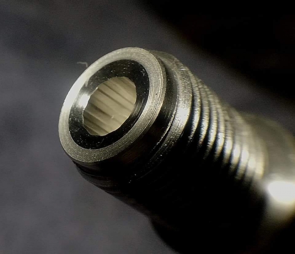

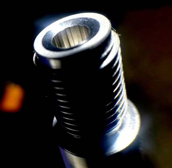

Finally I have got a good barrel machined to fit my 60ftlb HM1000x that was initially in .25 calibre.
I have kept the barrel indexable and TP can be changed to different sizes to shoot different weight of pellets.
Here are some pics.

Finally I installed BSA .22 barrel from old stock.
Keeping the factory settings that were for .25 60 fpe, now the gun shoots .22 25 grain redesigned pellets at 935 fps with extreme accuracy up to 90 yards as I just checked.
18 grain is shooting at 1050 fps . Accuracy at 24 yards with 18 grain at 1050 fps is great.
Its pellet on pellet.
I still have to see the accuracy in detail.
