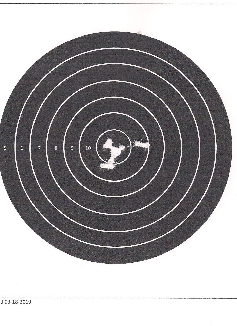

Here's my best targets shot with 22 cal MRD's at 100Y in low winds but normally my scores are in the 210's to 220's in the 5-8 mph winds. I'm out of this batch of pellets unfortunately.
I used a 35 cal plug and might be off 1 point here and there??
I've only shot 100Y using slugs like 4 times on these EBR targets and this one I really fought for because it went from 2-3 mph to 7-8 mph before I finished. It was a weird wind day?? It was my best one and if I were using pellets in these same conditions I might not have gotten more than 200?? Big difference in wind drift!

You have some pretty good 100 yard EBR cards here! I especially like the last one with slugs. What rifle/slug combination did you use for that one? That is a very nice card.

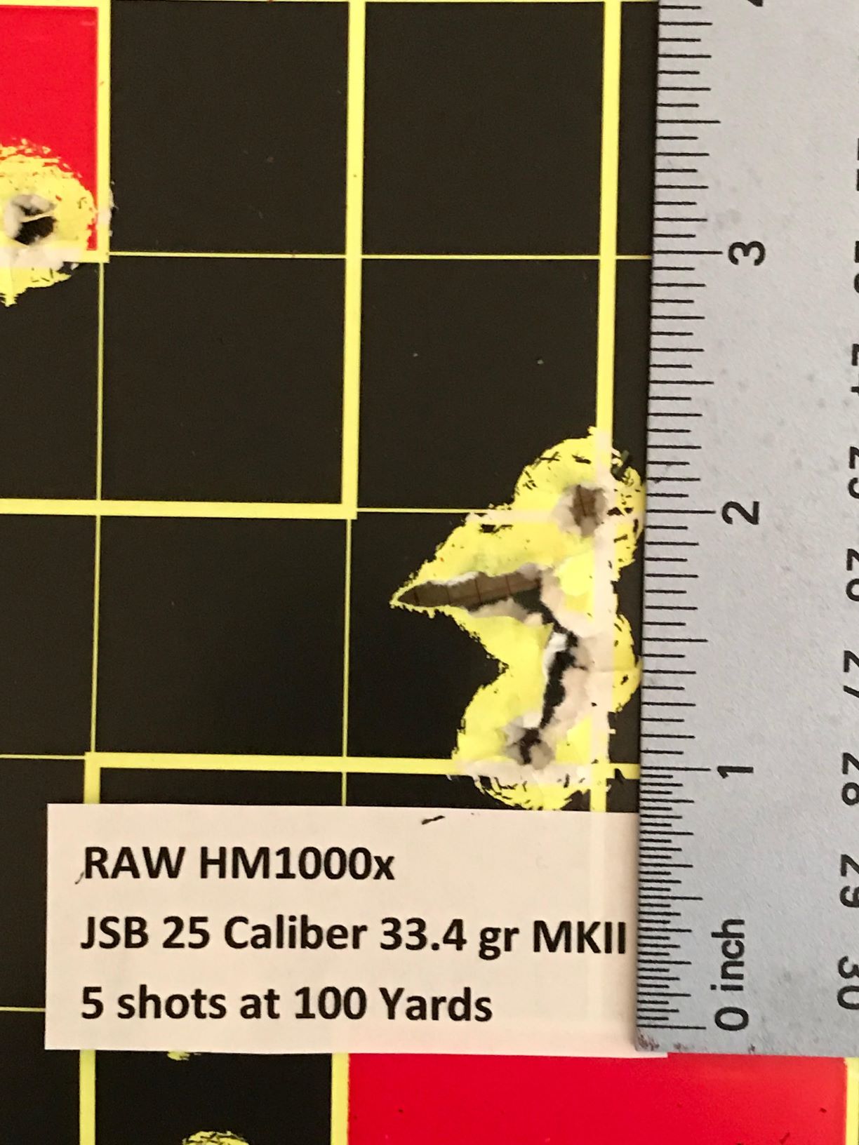

So far .25 cal. 33.94 JSB's can easily achieve 1 MOA at 100 yards and JSB 18.13 grain can also, just less frequently (both assume no wind).

Can you post some of your score targets or groups at 100y with both 18.1 g and 33.94g?
When you say’ “easily achieve MOA,” you have everyone’s attention. I have shot hundreds of groups and score targets with my RAW .22 HM1000x at 100Y, and nothing comes easy for MOA or for score.
