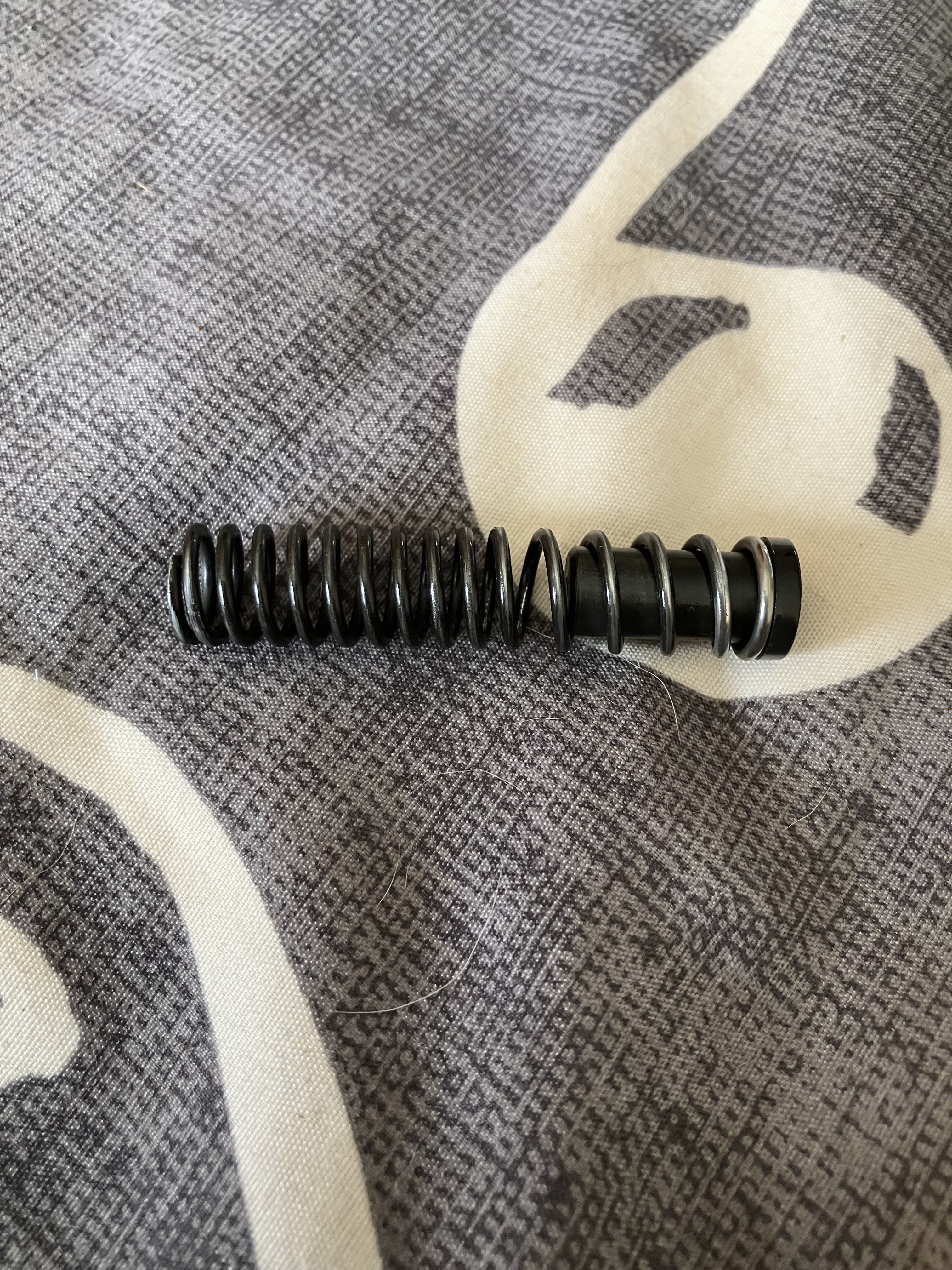

Thank you guys for all the advise!
Update on where I am with it.
Friday morning I took it to the range and shot groups whilst adjusting the hammer spring.
I stopped when I got a fairly good group at 25m.
Yesterday I shot 50m competition with it. My first card was my lowest total ever 197:eek:
I then turned the hammer in all the way and slowly started backing it out until it cocked. Shot some croups on the sighters and adjusted out until I got it to hold a group. Needless to say the whole process and stress was not conducive to good accuracy in a competition. At least I managed to get it to hold a group at 50, and shot a 231 in the second card.
Today I disassembled the hammer, and low and behold! Seems we put the hammer spring in the wrong way around when it was taken out. Was also quite dirty in there. Cleaned everything out, turned the spring around and re assembled. Fired a couple shots, and I am not sure if it is my imagination, but the shot cycle sounds better now.
Wednesday I will take it indoors and see if it is sorted now.
Hold thumbs!!
Hold thumbs!!
I wouldn't think the direction of the hammer spring would matter???
