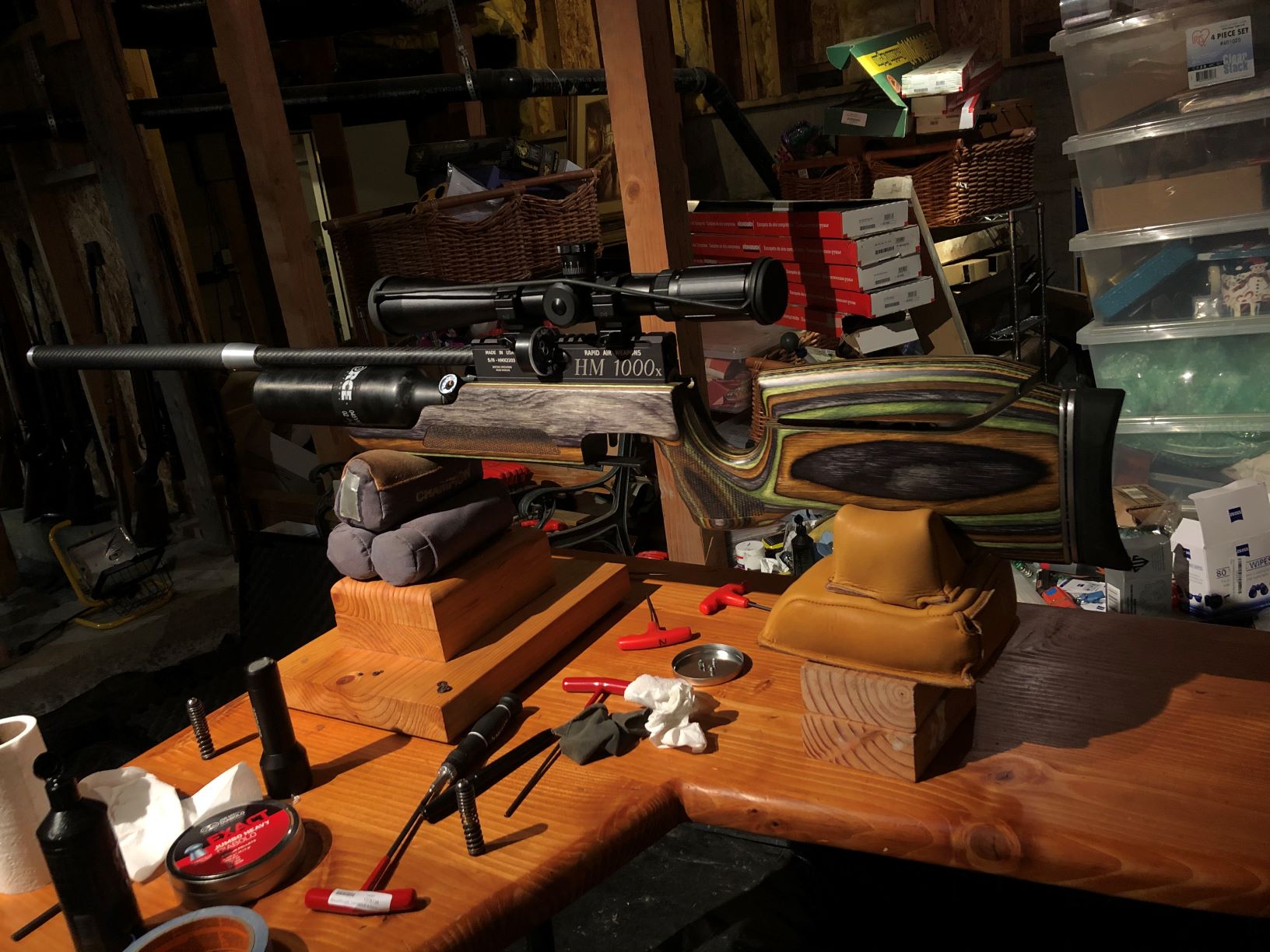

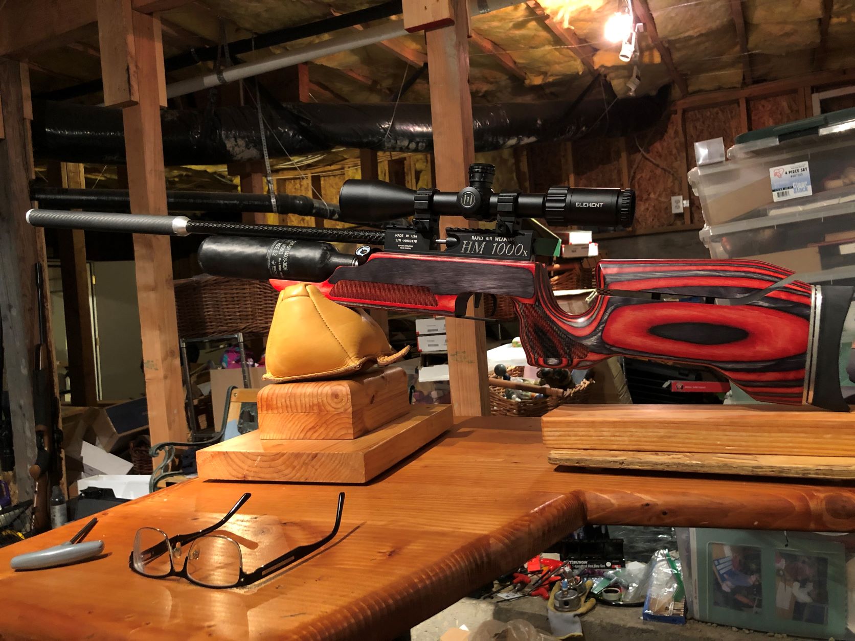

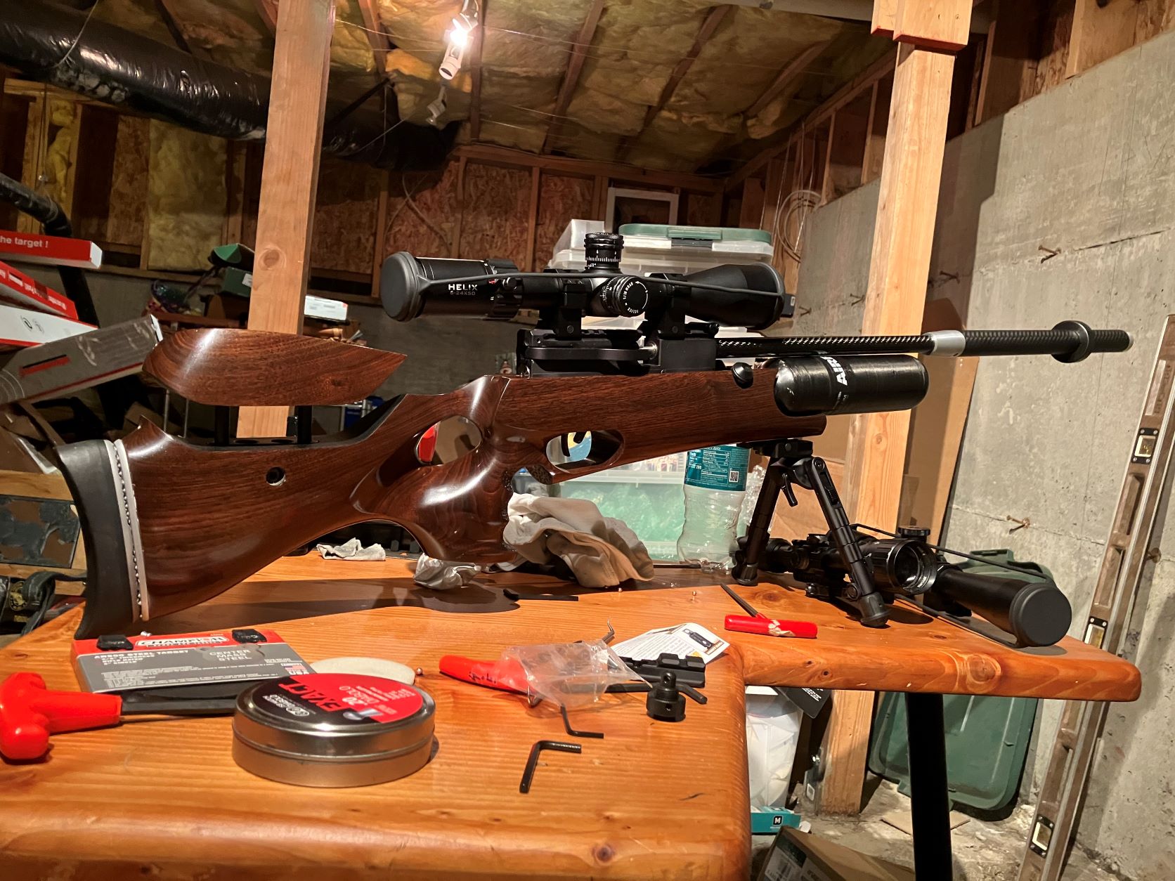

Have never used FX Airguns, but own 3 RAW HM1000x's. Shooting .177, .20, .22 and .25 calibers. Plenty of power for my needs which is targets out to 100 yards. Very simple, but elegant, solid rifles that lend themselves to endless hammer, valve, plenum, regulator and stock mods/tinkering.
Don't hunt or want to shoot anything over 34 grain pellets/slugs.

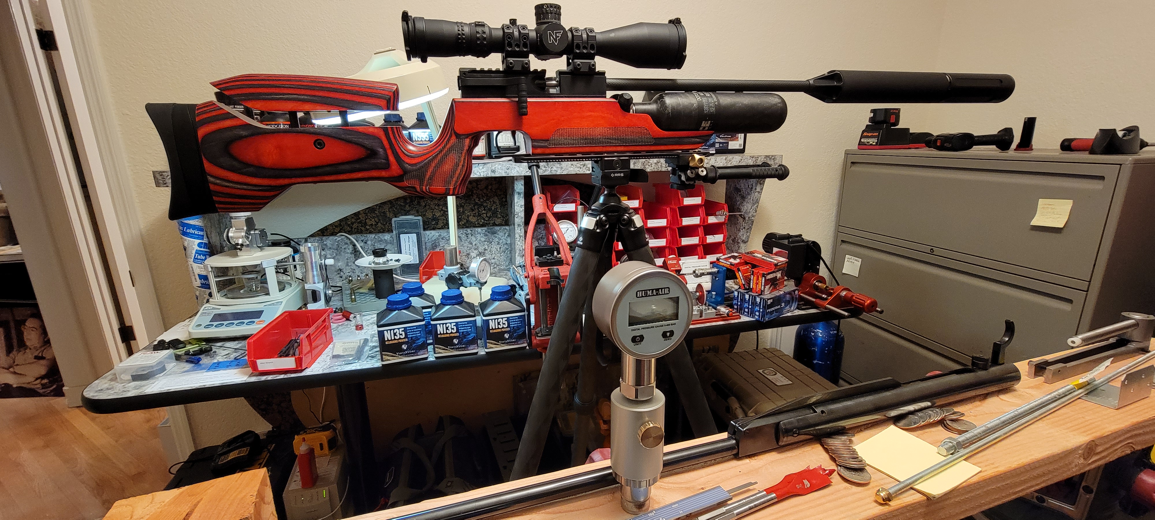

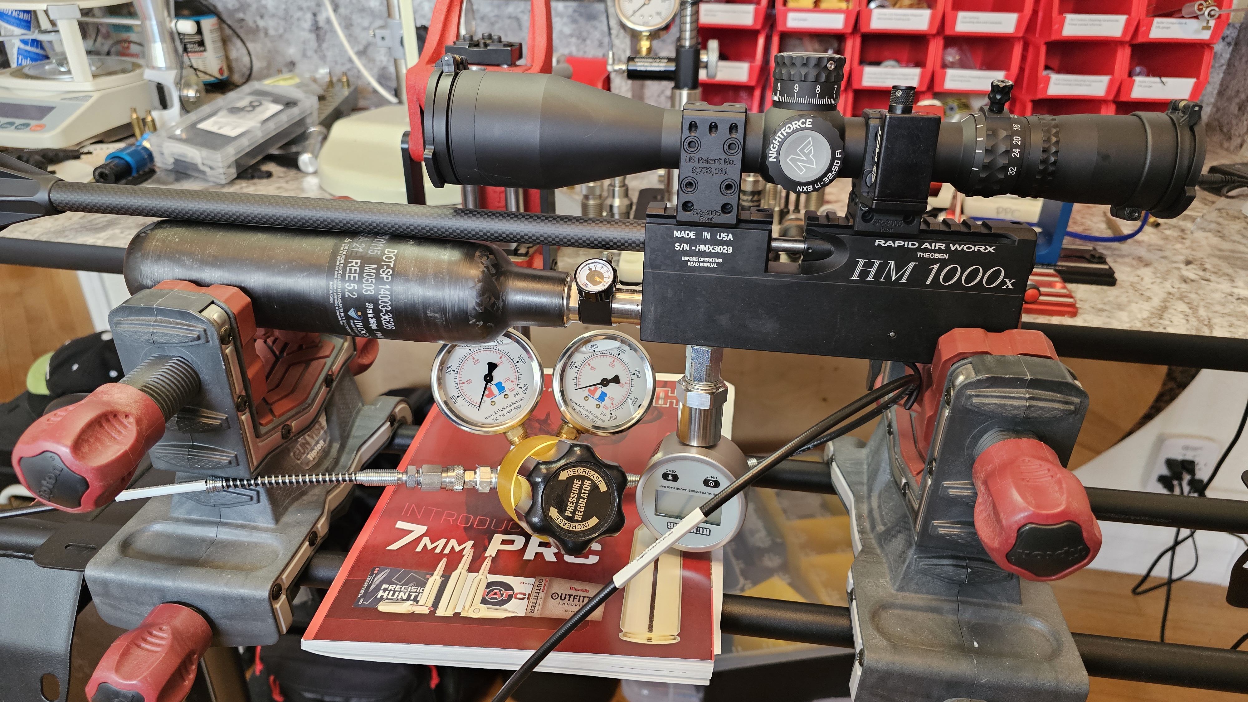

I have a 2022 RAW HM1000x and have figured a way to try out various regulator and hammer tension settings, but it is not nearly as easy nor convenient as the FX models. Also the FX Panthera has a larger plenum, useful in shooting heavier slugs.
