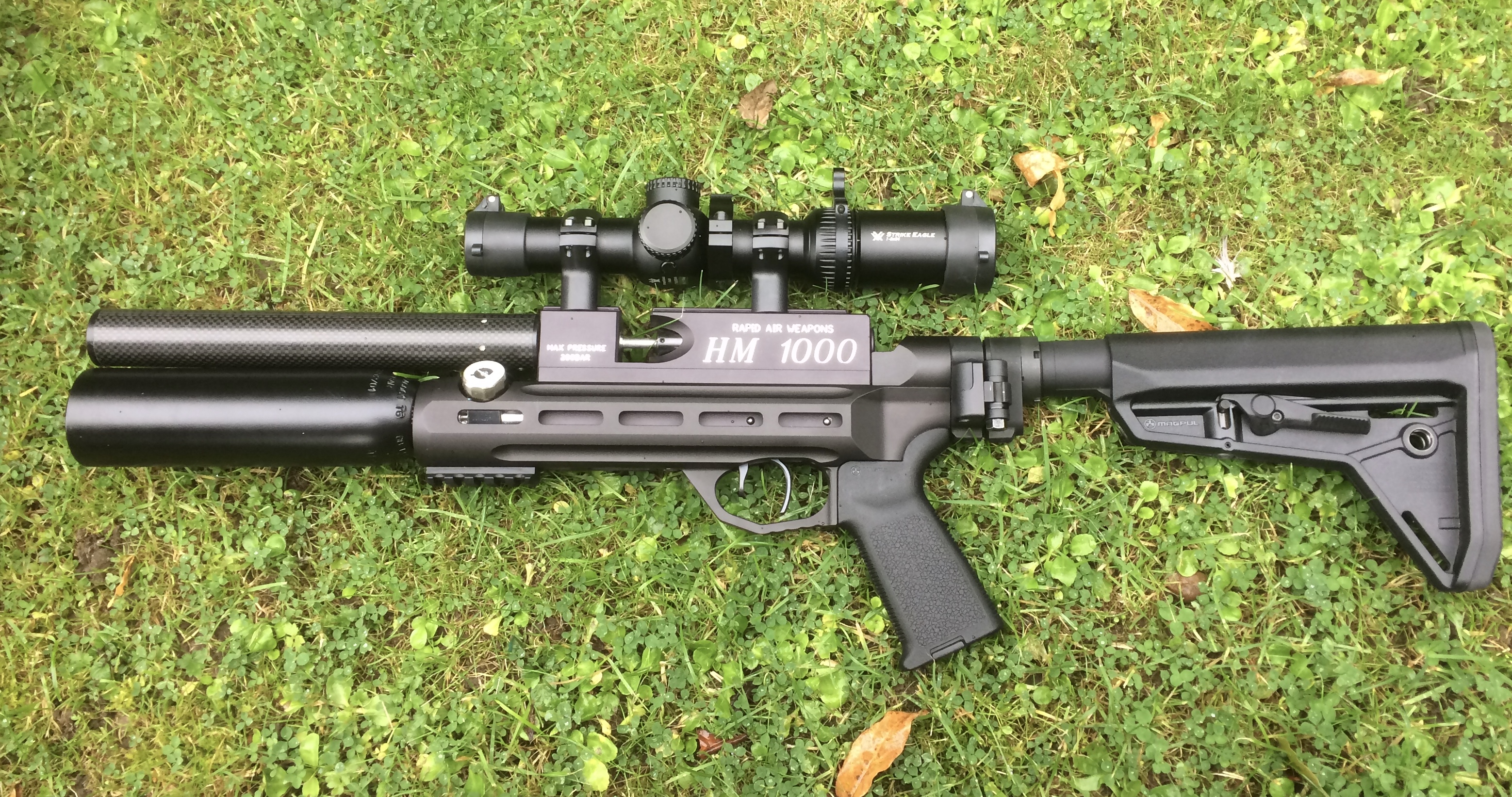

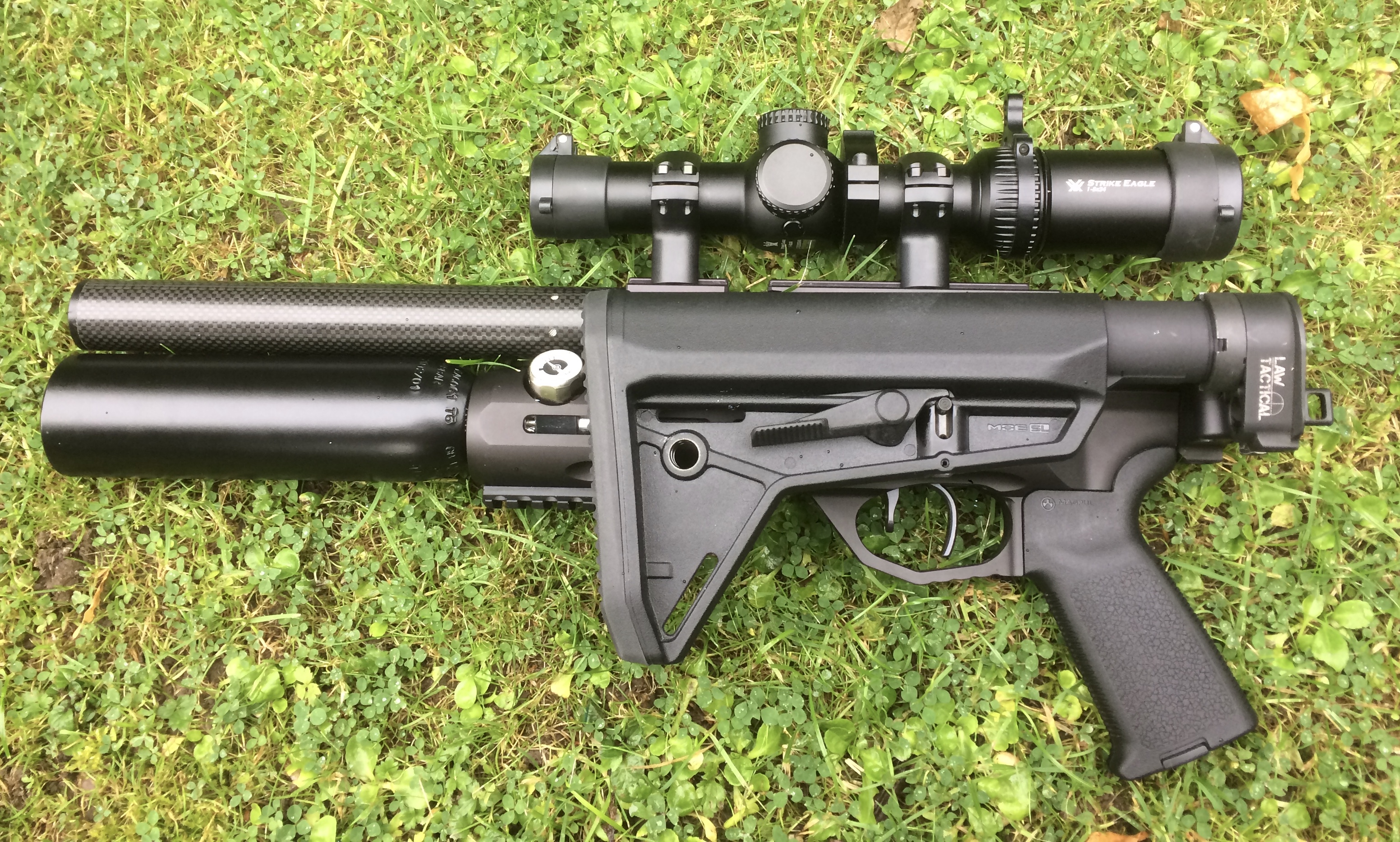

Or do what I did, best of both
Thinking the real question becomes ( being you have another fitted barrel to use ) is>>>> Do you want a dedicated single shot or an Either/Or Magazine use rig ?
Tho do understand ... as these are sorta special order rigs from RAW, you can get any barrel or bottle combo you want used on other RAW versions ;)
Exactly this^^^^^^
I have several barrels, stocks, regs, springs, bottles and moderators, my raw could be 6fpe a pistol in the morning.
A 12fpe compact barn gun at luchtime, a 50yard target gun in the afternoon and a slug shooting hunting rig with night vision in the evening.
With a little knowledge, a few spares and the right tools, swapping parts really is very very simple.👍
