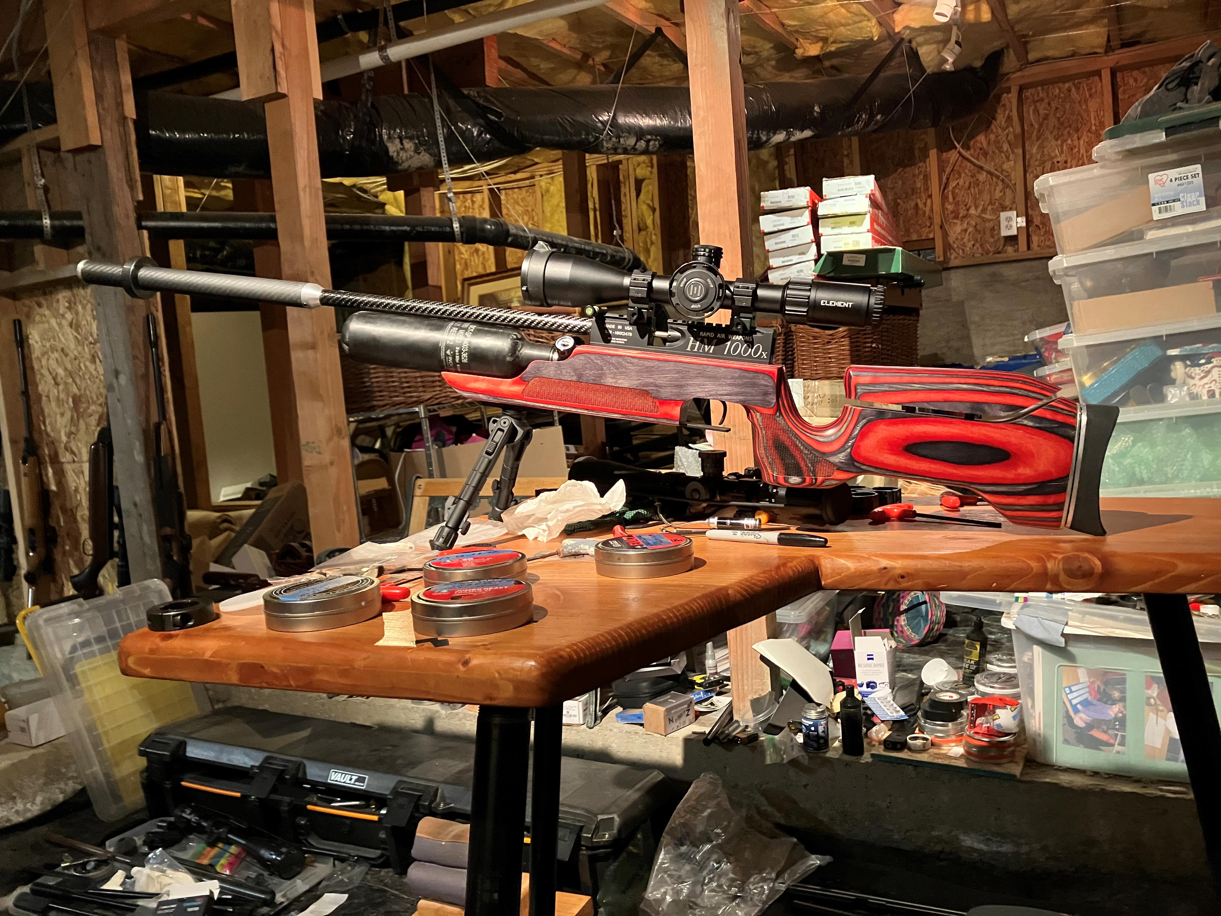

Here is the weight setup on the front of my TM1000. I used some of the Rok-Lok weights, a BKL scope ring, and a Talon buttstock tank clamp and extender to mount this setup out front on my rifle and balance it out. I also have Gray Ops CNC weights on the chassis and buttstock to add some weight to the rifle so that it is more steady when shooting from the WFTF position. I have lots of tuning options. RAW might offer this setup for sale if folks call and ask.
I also use the Rok-Lok on my HM1000X rifle setup for EFT, because the weight out front helps tame muzzle flip from heavy .25cal pellets. I attach the Rok-Lok to the Gray Ops CNC ARCA rail and hang them out off the front. My bipod or shooting sticks can go right behind them. I'll see if I can find a picture.
