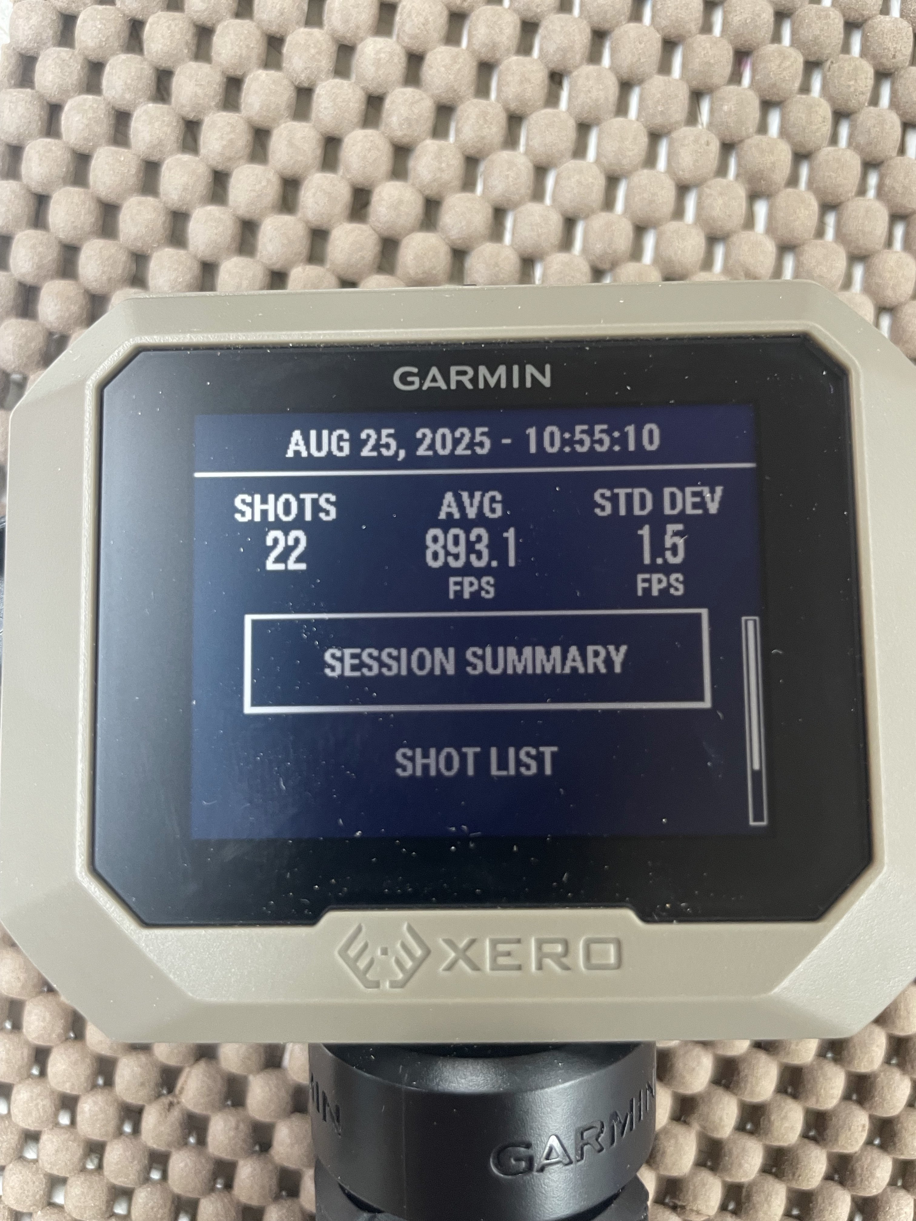

Shot one of mine today with AEA 45s. I was off by 8.1 that I posted above. I’ll get a crono string on my other one tomorrow.

I am shooting AEA 45s at 890-ish but can't get the 50s above 840. Did you raise your reg pressure to get them up to 880? I already have 2 washers on the HS.
No, I have an extended plenum. The reg is still at 145bar as stock. I don't want to raise the reg, because it will eventually make the shot cycle harsh and not be conducive to long distance accuracy.
