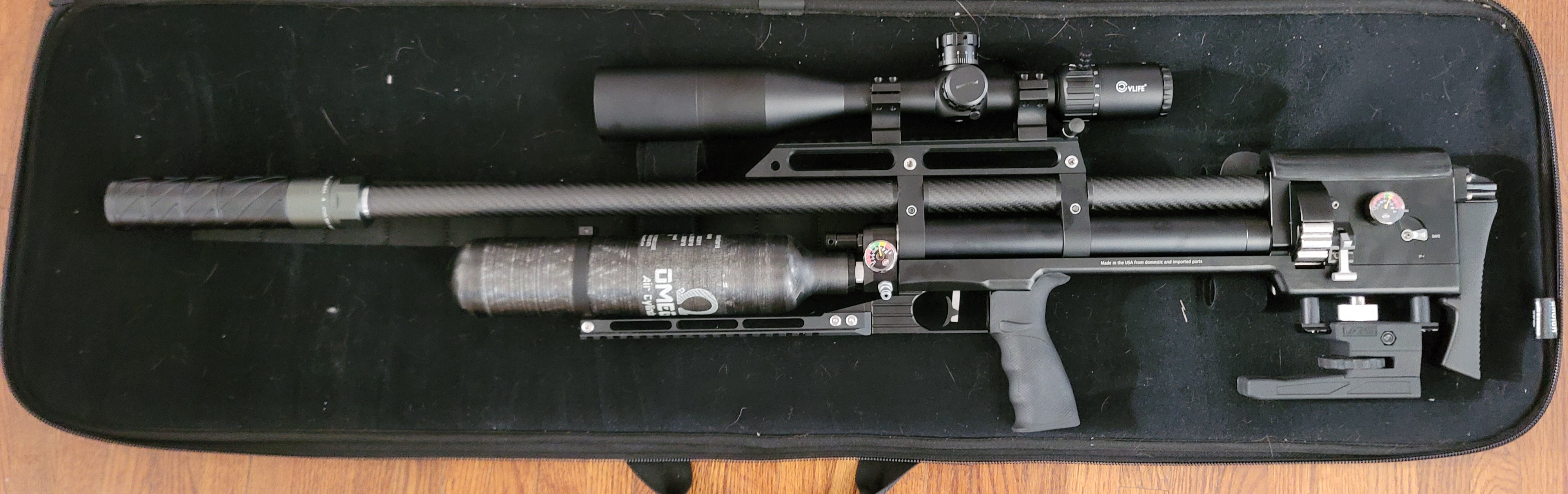

@caliusoptimus What type of shroud did you put on that Rattler? Or is that just how it looks with the factory moderator removed?Or maybe... a 36" barrel. Made this earlier in the week. Havent done much testing, but I put a 142gr in there and it was doing about 275fpe on 170bar.
I made it. 26x24 carbon tube with a variety of plastic and aluminum bushings.@caliusoptimus What type of shroud did you put on that Rattler? Or is that just how it looks with the factory moderator removed?
@caliusoptimus Did you also change barrels?I made it. 26x24 carbon tube with a variety of plastic and aluminum bushings.
Yep. I have a 36" 1-20" twist and the stock 28" 1-26" twist. The setup is the same aside from the length of the tube.@caliusoptimus Did you also change barrels?
@caliusoptimus What benefit(s) are you noticing since switching from the stock barrel to the one described above?Yep. I have a 36" 1-20" twist and the stock 28" 1-26" twist. The setup is the same aside from the length of the tube.
This is the stock barrel.
Mo powa! Up to 310fpe vs 270fpe with the stock barrel. Maybe more... I haven't tempted fate by going over 180bar. Accuracy is the same.@caliusoptimus What benefit(s) are you noticing since switching from the stock barrel to the one described above?
@caliusoptimus A faster twist rate and adding 8" to the barrel did that?Mo powa! Up to 310fpe vs 270fpe with the stock barrel. Maybe more... I haven't tempted fate by going over 180bar. Accuracy is the same.
Twist rate didn't increase power, but an extra 8" of barrel sure did.@caliusoptimus A faster twist rate and adding 8" to the barrel did that?
@caliusoptimus What is your reason for increasing the twist rate?Twist rate didn't increase power, but an extra 8" of barrel sure did.
At first I didn't have one. Just got a few blanks in both twist rates to see what happens. Now that I've played with it a bunch, I don't think the rattler needs a 20 twist. The 26 has stabilized every slug I've tried.@caliusoptimus What is your reason for increasing the twist rate?
