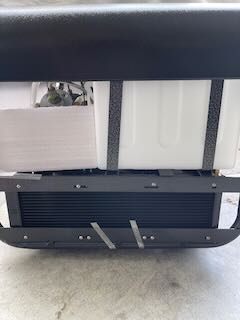

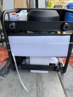

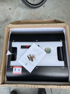

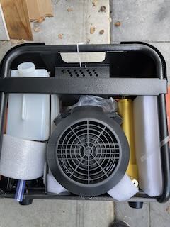

Well, I received the compressor today, box had a small hole in the top but other than that, unscathed, packing was incredible, LOTS of foam, around the unit and in the guts to stop things from moving, very impressed. Except for two minor little details, to follow, everything that was suppose to be tight was tight, no cross threading or other issues. The pressure gauge was slightly lifted on one side maybe 1/16", pushed right down, they did neglect to attach the coolant line from the pump to the cylinder. It's on the 'pressure' side of the pump so a zip tie will take care of that. Instructions were fair, seen worse. Awaiting for the compressor oil to come in to local O'Reily's, I'll pick up some coolant then. Hopefully tomorrow afternoon I can fire it up and see how it works. Need to figure out how to attach an hour meter, shouldn't be too hard. Not that it's going to get a lot of hours on it anyway.

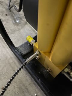

Great to hear 👍 my package was well done also. In the final photo above showing pump outlet, the High Pressure head is visible. There is a small hole in the head that should accept the pre-wired thermocouple ( it will be a black wire with a silver color tube on the end) that tube is the thermocouple that goes into the hole in the High Pressure head...used to display running temp.
When you get it ready to fire suggest setting autoshutoff at 1000 psi or so. Plug the hose end and be sure bleed on fter is open. Run cooling pump Only for 5 min or so and check for leaks and confirm circulation.

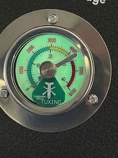

Turns out that the pressure gauge glows in the dark when exposed to a flash light, cool. No obvious leaks. Turned off the compressor and did a leak down test, after 5 minutes lost 500psi, close enough for right now.
Went and reread the instructions and no where does it say there is a gasket on the high pressure fill. Now maybe I missed it three times but.....not so sure about that, I'll defer to others

Yup your temperature probe was out of the cylinder. Shows in your unpacking picture. Mine shipped same way. The shutoff is notoriously not consistent. Most of mine (on 3rd gauge) have problems of alignment where in certain positions the 2 arrows don't make electrical contact, so no shutoff. Since I fill to 4500 the bleed valve goes but if you are filling to 250 bar it will be an issue unless you readjust the over-pressure bleed.

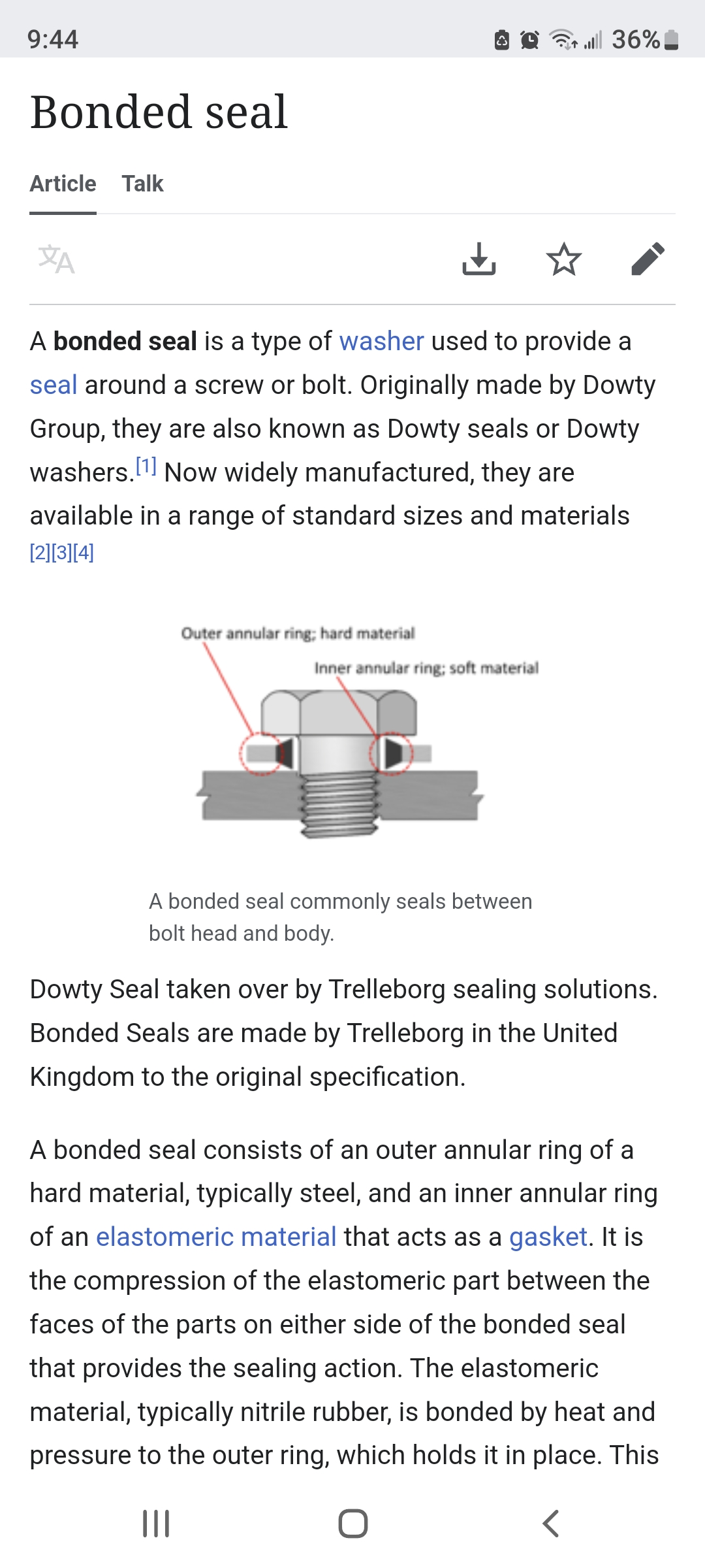

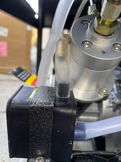

Originally I complained on Amazon and they responded and sent a bunch of parts (same manufacturing errors and silliness - primarily misplaced drain screw that causes it to leak oil, they are still all like that based on the complaints I see). I got tired of the broken telephone routine. Bought parts on both Amazon and Aliexpress. When the coolant leak stalled the compressor, sent it to Veradium to have him rebuild (he dealt with whatever parts he wanted to replace). My guys didn't drain oil properly (it hides behind the large rubber gasket) and didn't plug the breather/oilfill hole. UPS played football with it and Brian received an Oily mess. Many months later he shipped it back (replaced piston rings, coolant system o-rings, plastic drying media housing in yellow filter, changed to better desiccant media, installed his upgraded gauge hose location, replaced gauge, replaced electronics with stock electronics because my upgrade was oily). UPS just about destroyed it on the way back, frame bent, screws holding sheet metal stripped, the intake dryer completely missing (torn out), and covered in oil because Brian didn't plug it either). The plastic gasket under the brass pressure adjusting screw on the gauge fell out upon the first adjustment, replaced it with an o-ring but it wouldn't shut off at 4500 did fine at 3000 but 4500 needles wouldn't touch each other to make the circuit. Cleaned it up, replaced gauge, installed air intake dryer, retapped the sheet metal mounting screws, filled with Bauer oil from Nuvair, runs like a champ.
Next projects: better drain screws, digital gauge/control, add flow window thing on the coolant system, and put the temperature cutoff back in.
