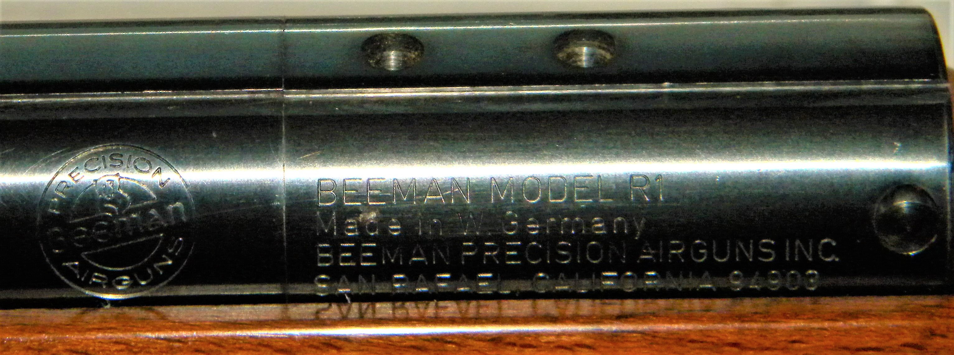

None of the Beeman R series have/had the Jnc marking, just FWB124 and extremely rare 127. The double stamp is an R1 thing only and it refers to both the CA city (only San Rafael) and Boswell bear on the same side of the rear block (left side). Those were on the earliest of the R1's and are pretty scarce.

None of the Beeman R series have/had the Jnc marking, just FWB124 and extremely rare 127. The double stamp is an R1 thing only and it refers to both the CA city and Boswell bear on the same side of the rear block (left side). Those were on the earliest of the R1's and are pretty scarce.
