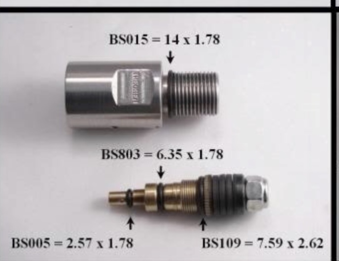

Have not had the rifle out in several months. When I took it out of the case yesterday I was surprised to find the bottle empty. Tried to refill it it but the air was leaking out. Thought it might be the bottle O- ring so I swapped it out for a new one. That did not fix it. I know the leak is somewhere around the fill nozzle. Anyone else had this problem? What did you do?
If it's leaking around the v-block I would suspect a regulator leak. How old is gun or how long since serviced? O'rings go bad over time.
Yes, the two (same size) thin o-rings of the v-block are likely the culprit. Those two and the bottle o-ring are by far the biggest offenders in a RAW.
The skinny regulator (against the receiver) o-ring can fail too, but you need to have removed the regulator several times ........
Most others require you to do something stupid to fail.
I purchased packs of (50) of these 3 sizes ....... just for this reason.
There are a few area’s to look at, the v fill o rings, or the reg core o rings, these are the most likely suspects.
Remove the reg from the block with a 21mm spanner, make a mark on the brass knurled locking nut and on the reg. unscrew the brass not DO NOT UNDO THE REG TENSION NUT. remove the two o rings on the reg core and reassemble so that the two marks line up. By doing it this way the reg pressure will still be the same.

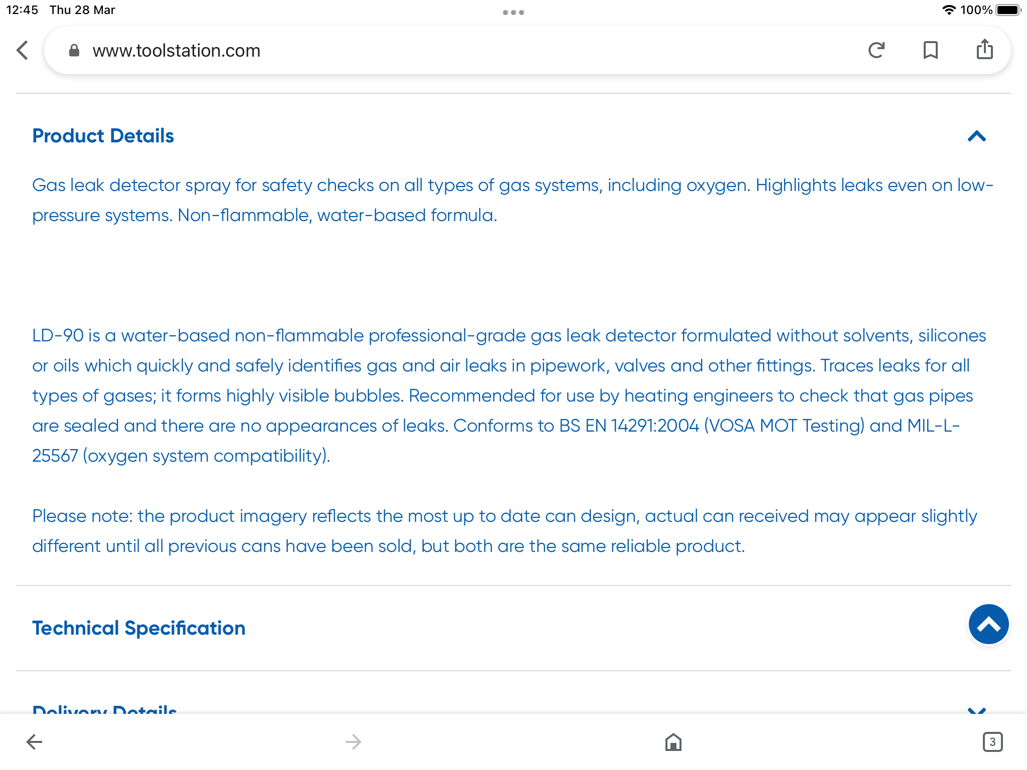

What kind of leak spray?
Yeah I get
Yeah I understand that we'll being a mechanic for 14 years I just didn't know there was salt in the dish soap never really even thought about it
To be honest, any of the sprays used by gas engineers is suitable, I prefer the type in an aerosol can because it’s slightly more foamy. Something like this.
