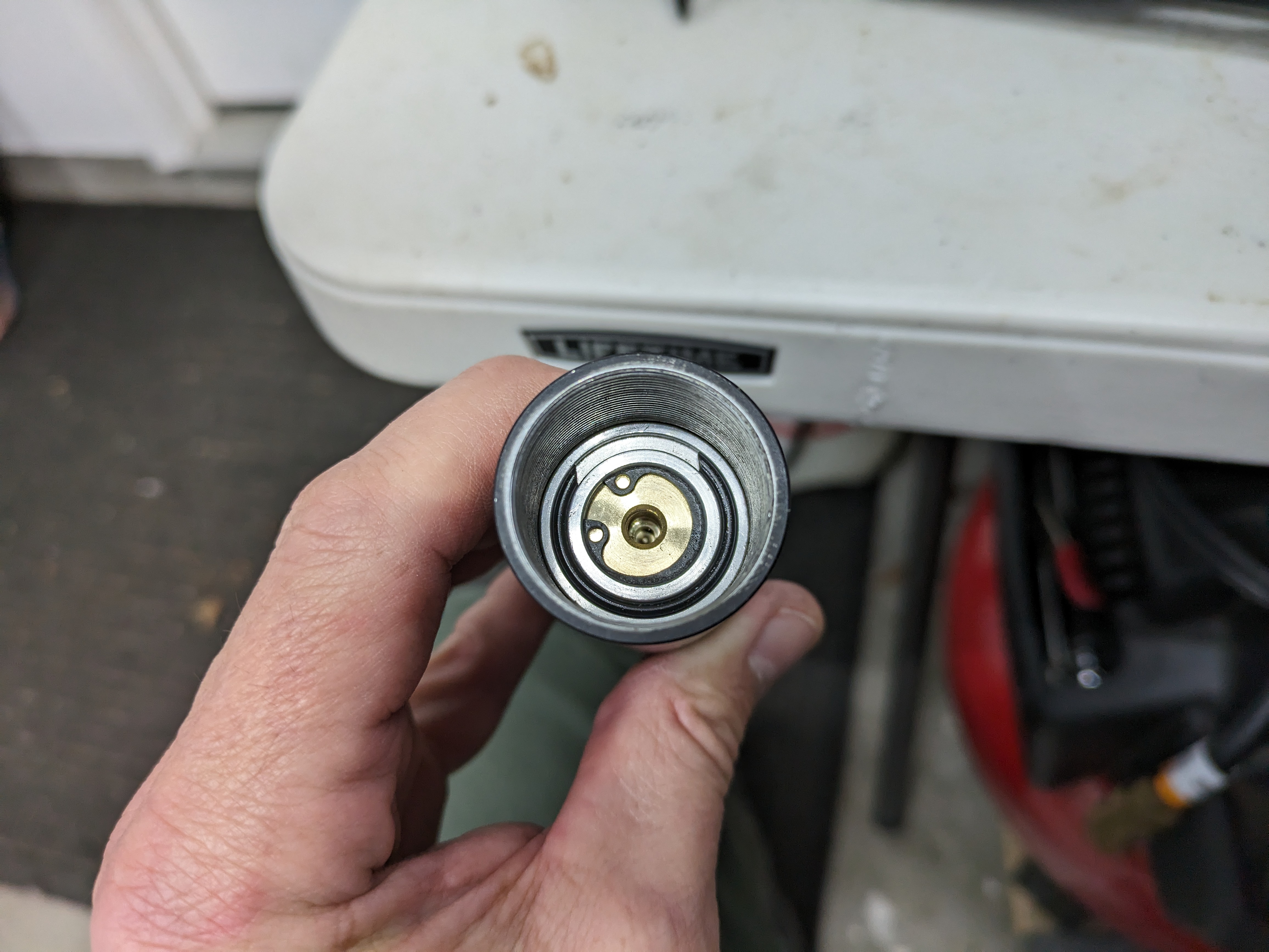

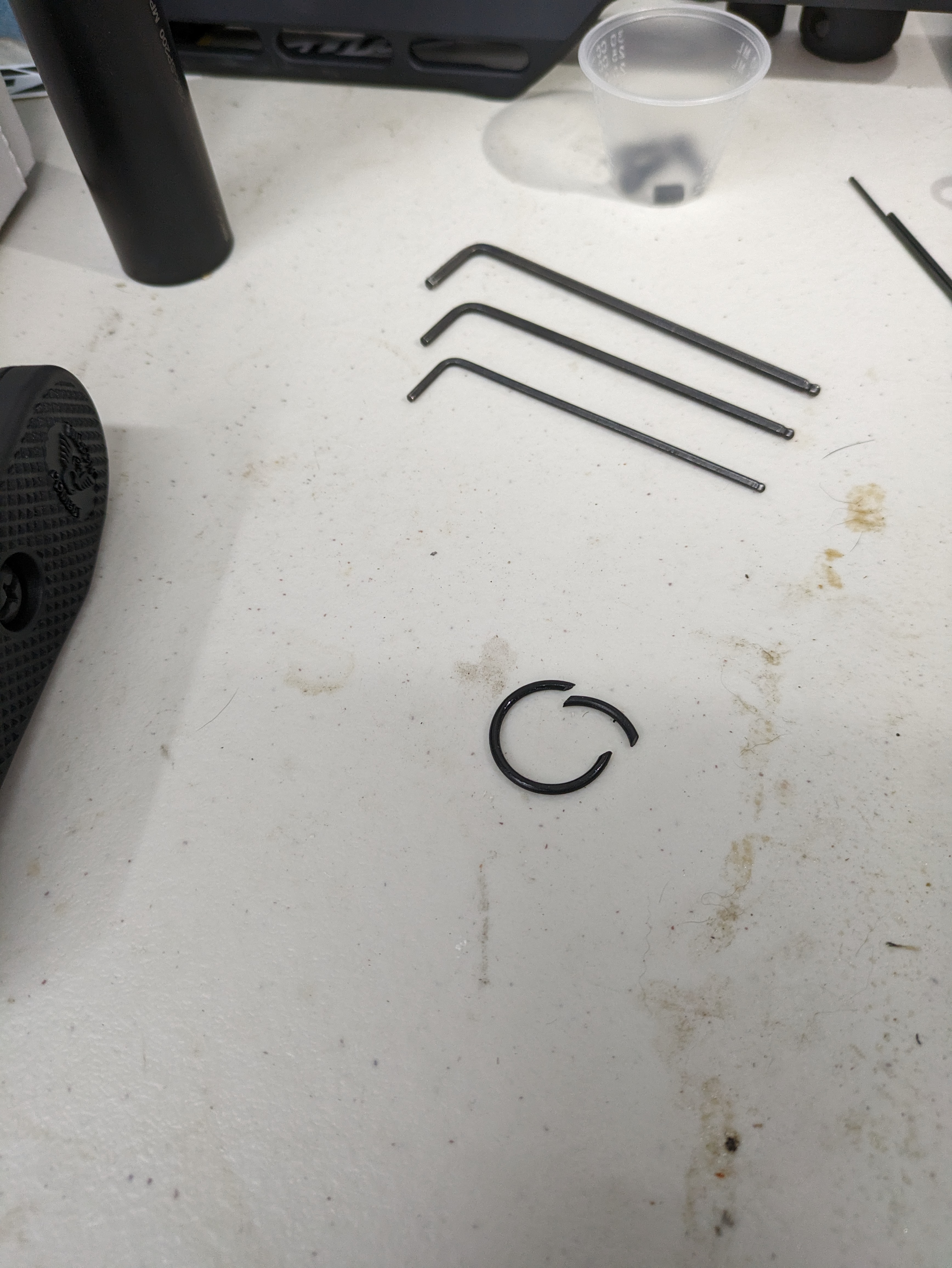

Second issue - After fixing the above problem the rifle developed a leak from somewhere under the scope rail area. AoA's tech, Shane, felt pretty confident it was going to be the o-ring on the face of the regulator causing the leak and gave me some pointers on how to do the work myself. Got a kit from them in which Shane had separately packaged the suspected o-ring for simplicity and started digging in. Yep! He was exactly right. Easy peazy to see and replace, thankfully. I know my rifle's inner workings better now through this experience as well. Also, I really like dealing with AoA, in both sales and service. They've been quick to respond to messages and spot-on with diagnosing what's wrong.
Pics of the offending o-ring:
