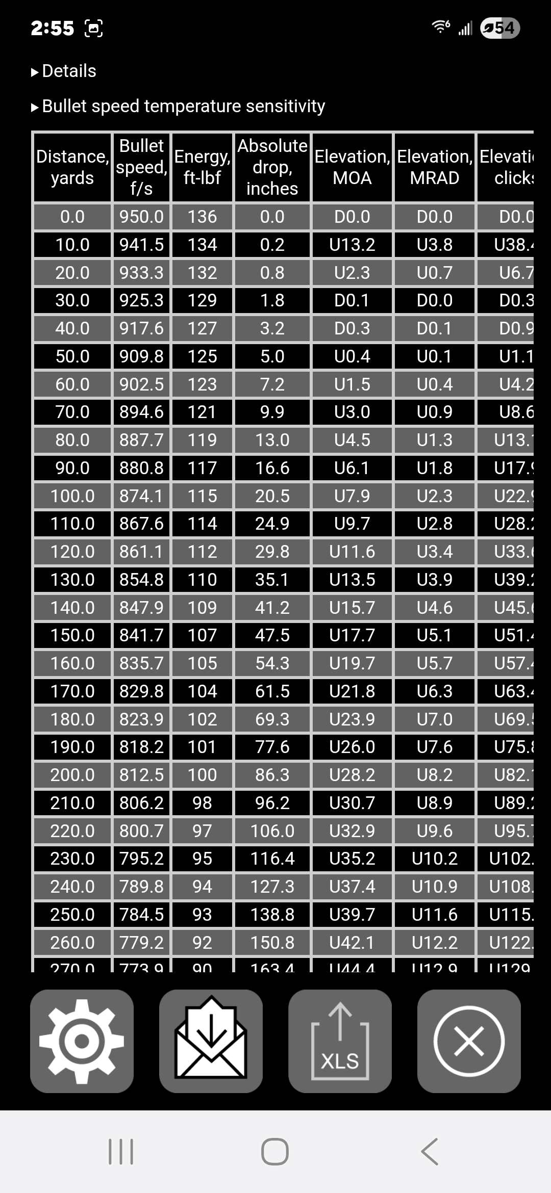

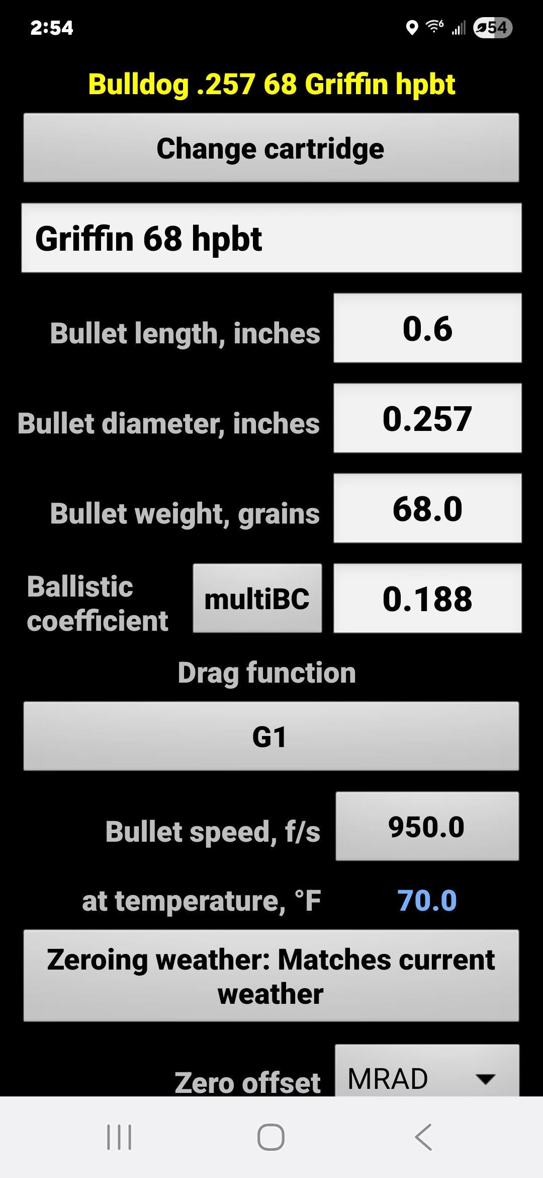

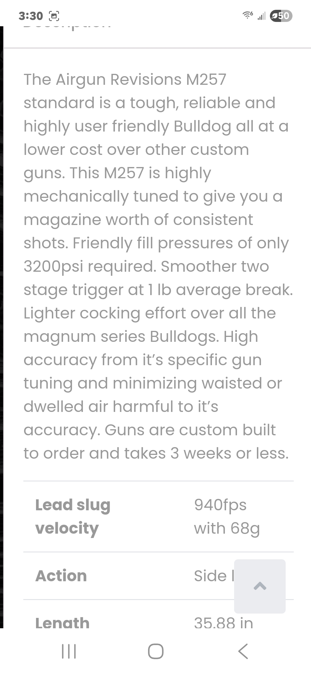

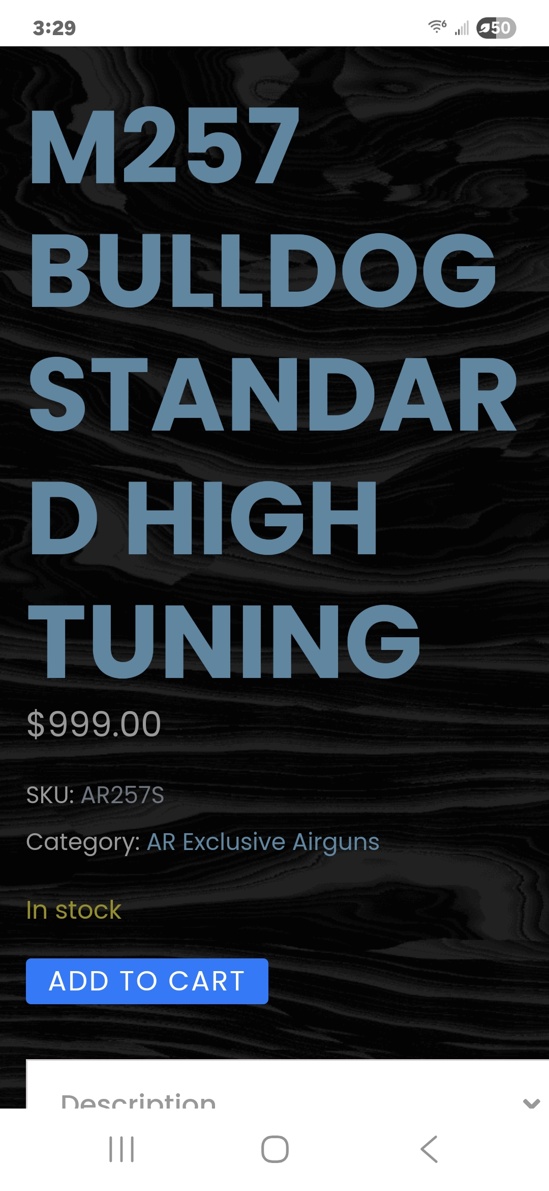

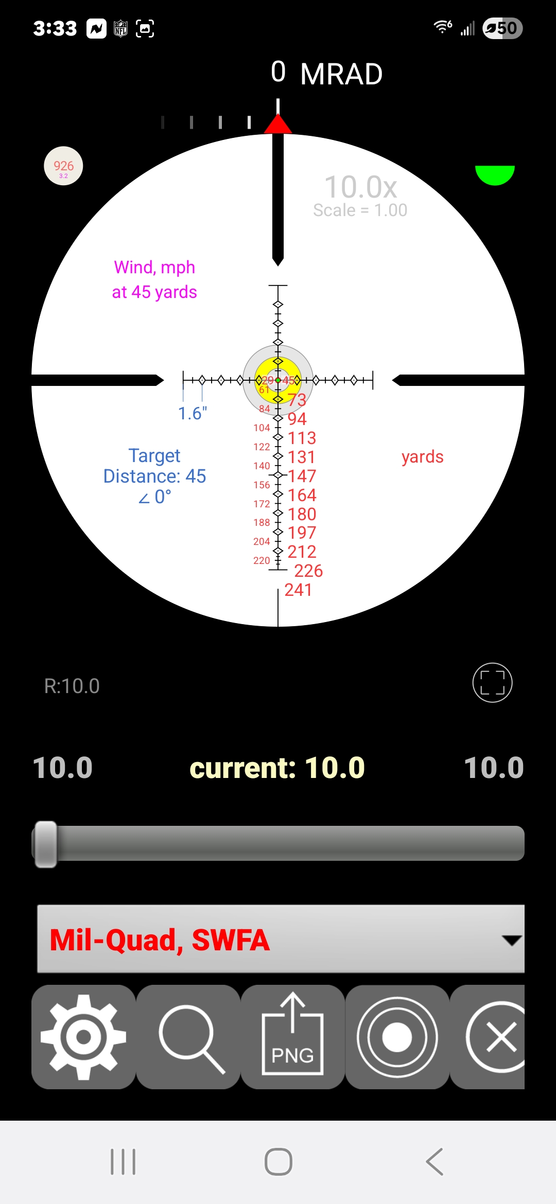

For 175 yds you need some ump. Benjamin bulldog m257 Griffin 68 hpbt.

Hey all! I live on a farm with a fairly long flat driveway, probably 175 yards. We have a major ground squirrel infestation, burrows all along the driveway. Anyway, i'm wondering what your go to rifle would be in situation like this?
