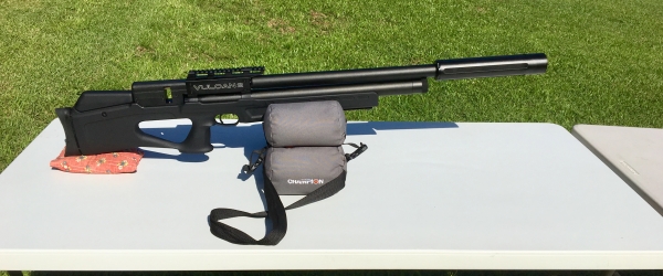

Photos of the gun please.
1546905964_16871790955c33e96c337616.68047623_39E99861-3A43-49BE-96E2-634D5CAC66EC.jpeg
2manyAirGunz, Ran outside to take a quick pic. Took off the scope as I was going to adjust the trigger to see if it’ll improve my groups
