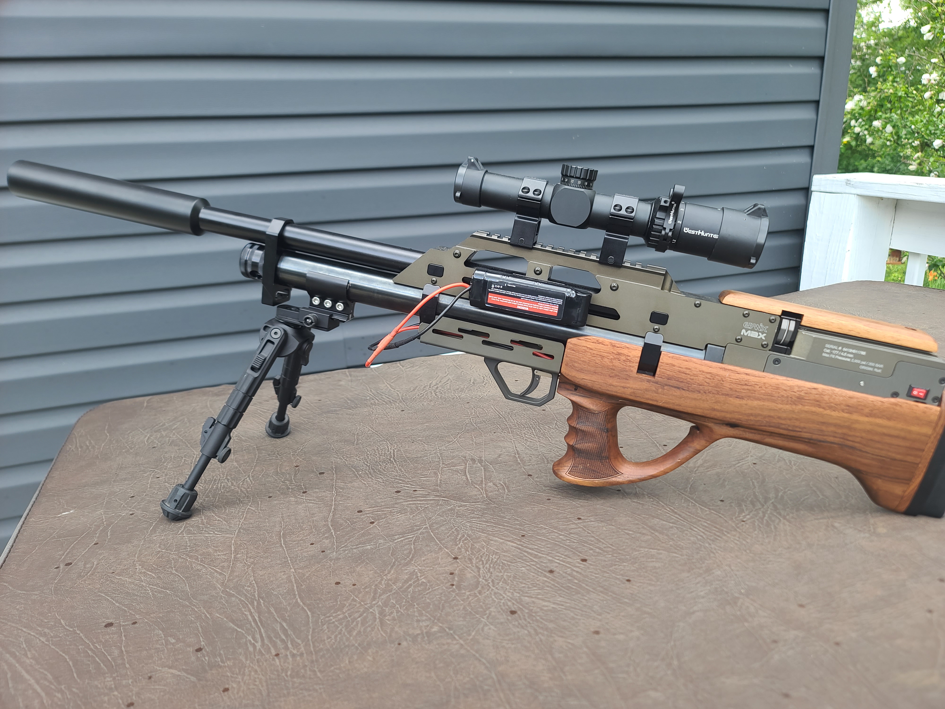

I put a Neil Clague on my Evanix Max .177. He makes it for your rifle,threads into the shroud and guarantees it. The opening and internals are all def at least .22. So .05 larger than caliber.
