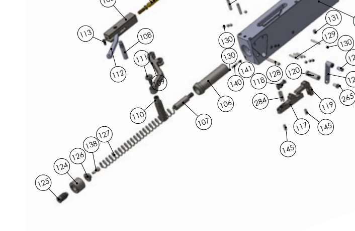

after you take it out of the stock,
the hammer spring adjustment is the large silver flathead l,
it will only go out so far,
and will only go in so far.
the grub and screw hold a sort of spring guide that the spring fits over,
and turning the flathead pushes the guide forward to increase hammer spring tension.
BUT!!!!
even if you run the reg up over 150bar,
the hammer spring is too strong,
even backed out all the way,
so i took the small guide cup off the hammer adjustment and put the screw back in so it still had a guide,
this allowed the spring to expand another 1/8th inch or so,and in turn decrease the hammer tension slightly.
but with the "spring cup" removed there are no adjustments to be had,
so i just tuned the reg to the pressure that gave me a flat shot string,
(in .25 with the 25gn im right at 130bar)

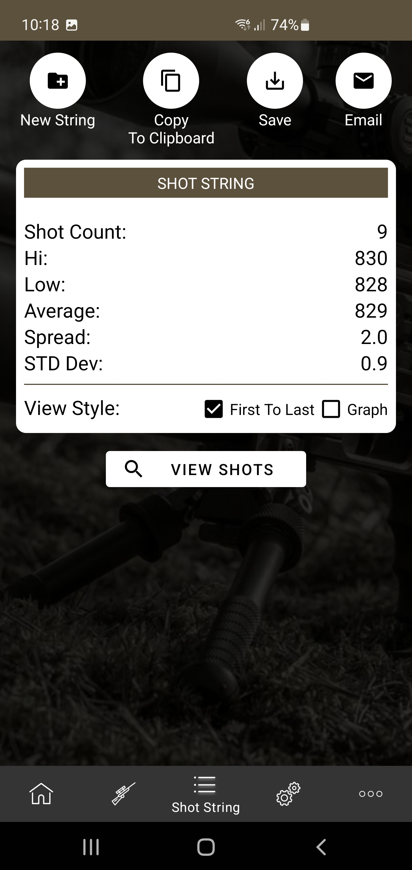

its not a powerhouse,
maybe with a bigger plenum it could be,
i have the .25 barrel on it,
running the jts dead center 25.39gn,
and its pushing them to 830fps but the string is so flat.
reg takes alot of shooting to get it to settle down,
mine would creep nearly 20bar in 15 min
but its getting better now after 600+ rounds through it.

Thanks for the response! I'm interested, but am still curious about a few things.
So, in the diagram, #125 is the fat flathead screw that is captive by #124. You take out #125 (or remove #124 through some sort of magic), remove #126 and put #138 back into #125. Now #125 goes back and forth, but the spring now fetches up against something in #124.
It looks like a thinner hammer spring might be useful. Warranty? What's that? :)
The trigger looks like a backwards Avenger trigger, so the back grub screw (#145) tightens or loosens the spring, and the front grub screw sets the travel. Turning the back #145 screw in makes the spring feel weaker, and turning the front screw in makes the trigger lighter. Is that correct?
I don't see any bleed screw, so it looks like you let the air out by taking off the bottle and either dry firing the gun to empty the plenum, or backing the regulator gauge out to let the air out.
Finally, did you try out the power adjustment switch?
Thanks again.
ok lets see...
1. yes i removed part #126 and put the other pieces back together,
the spring now butts up against part #124,
but still has the post going into the spring to hold it in place,but turning the spring tension screw now doesnt do anything.
it allows the spring to weaken slightly,
ill be getting an assortment of slightly lighter weight springs,
and will put 126 back in so i have adjustment.
gotta make do with what you have onhand lol
2. i see 2 parts labeled 145, but the one to the REAR of the gun is the second stage/sear engagement,and the one to the FRONT of the gun is for the first stage travel,
i also installed a lighter weight sear spring (#284) the factory one was beastly heavy.
also on the trigger linkage near the trigger there is a return spring,
i replaced it with a lighter one also.
3. to degas unscrew the bottle,then bleed the gun by loosening the reg gauge,
-BUT-
to adjust the reg (go in the tiniest increments that you can! its VERY sensitive,
ask me how i know lol))
remove the stock,remove the trigger linkage,
there will be 2 hex screws on the bottom of the reciever where the block with the reg gauge and valve slides into the reciever,
take out those 2 screws and the whole pressurized assembly comes out,
then unscrew the bottle,
and use the included wrench to unscrew the reg from the plenum,brass screw in the middle is the adjustment.
4. power lever works,but its just chokes off the transfer port so i leave it all the way open.
