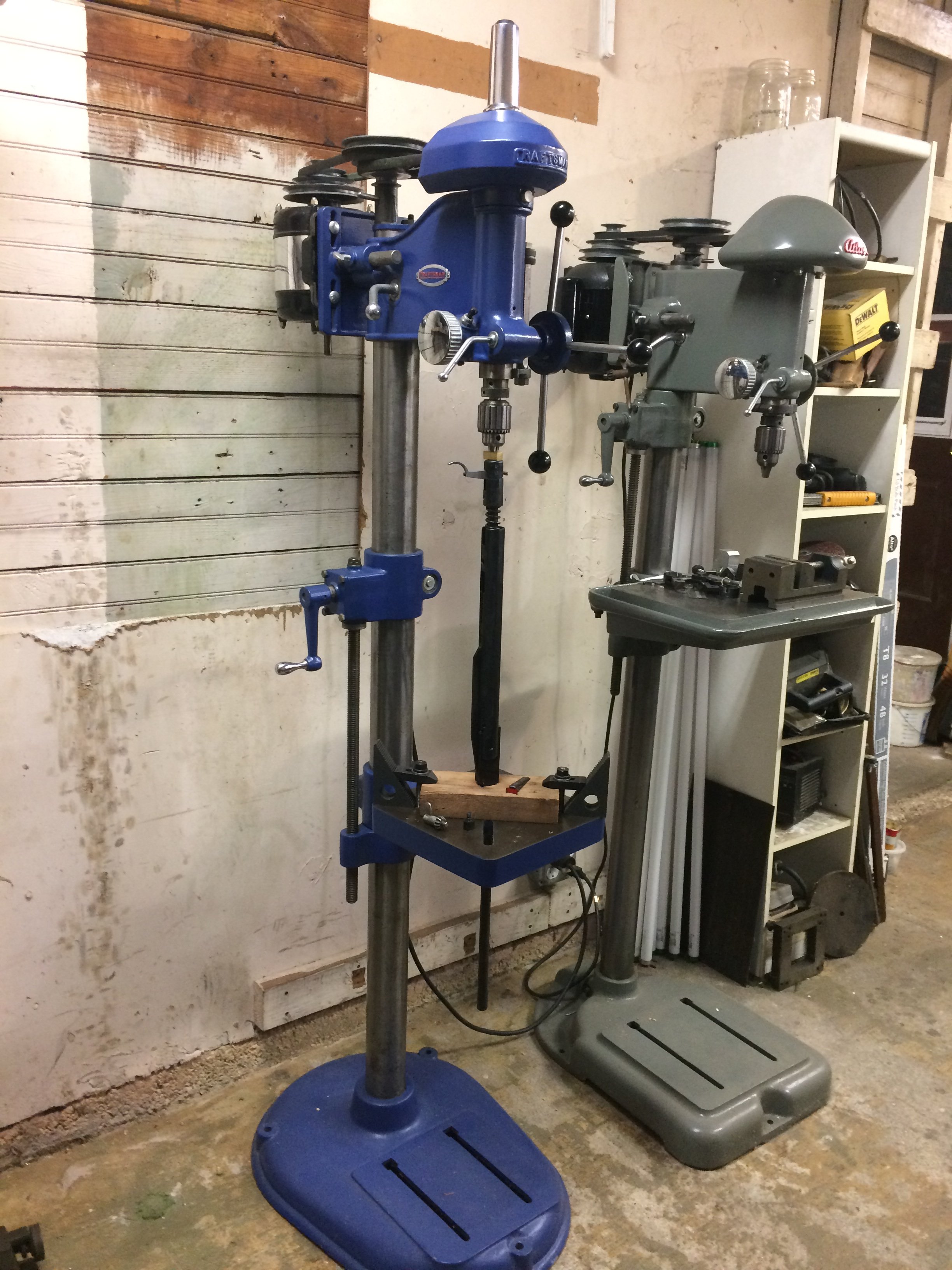

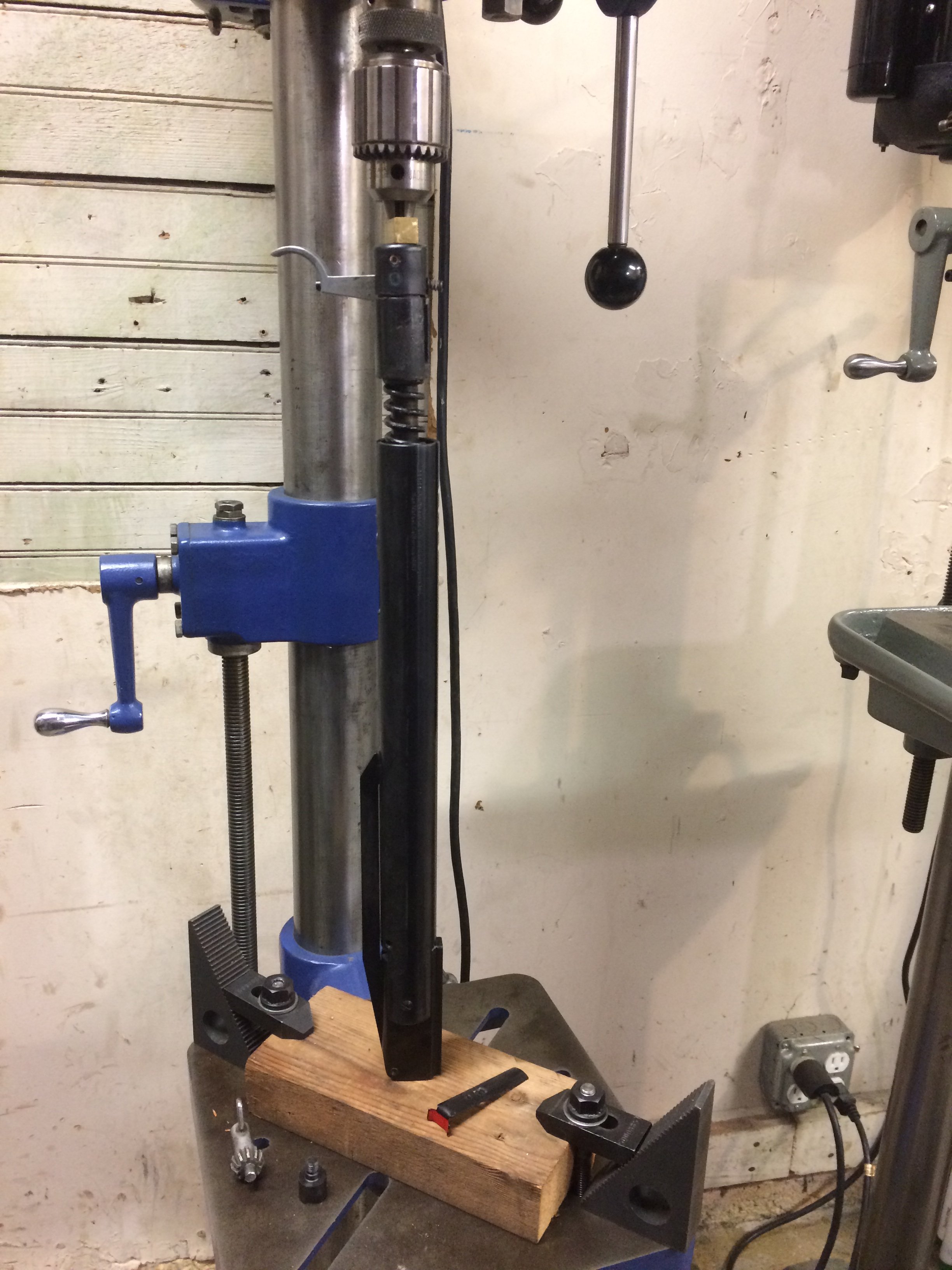

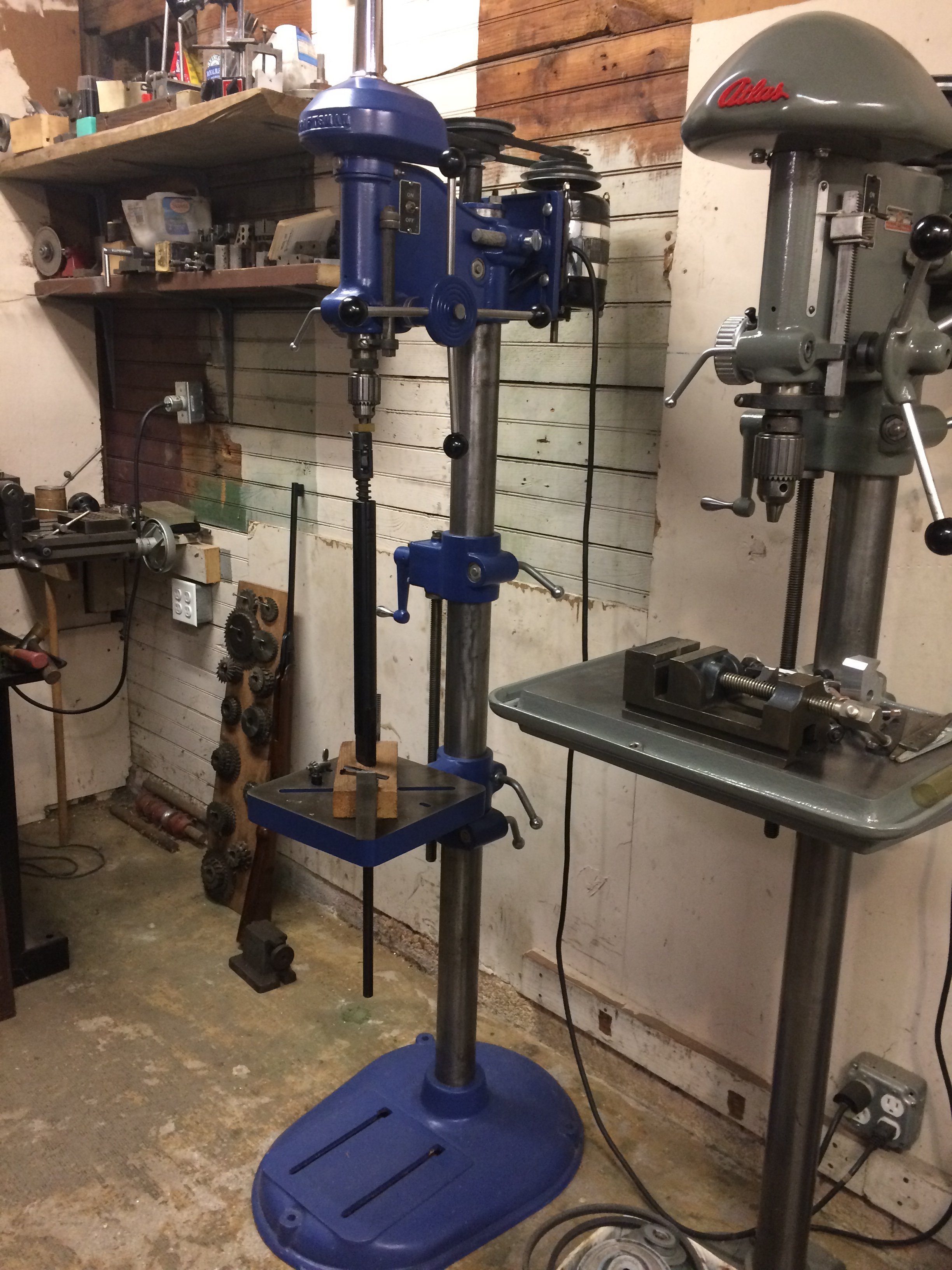

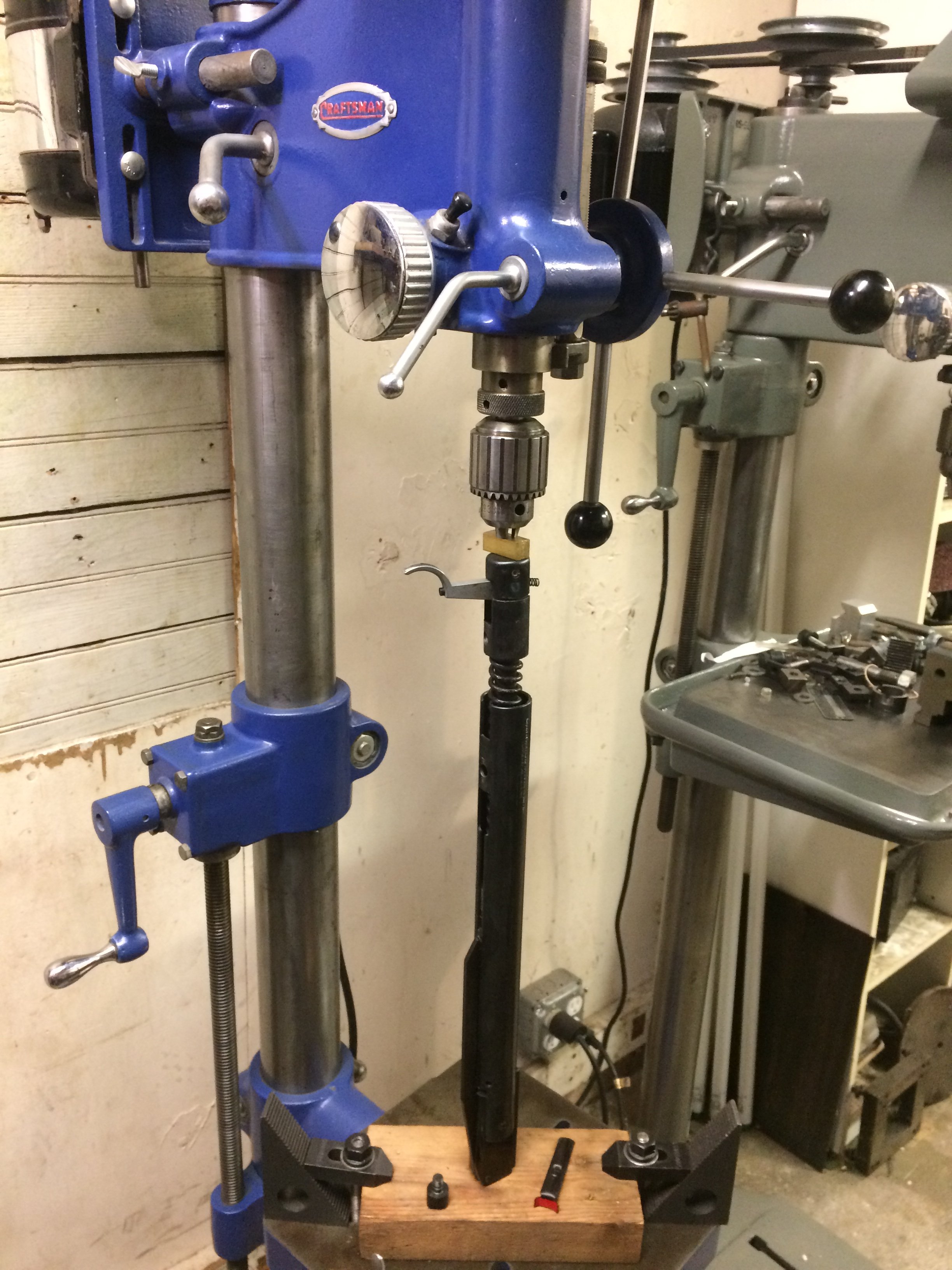

Several ways to skin a cat in my shop. I can use a drill press. I can chuck the action in a lathe and use the tailstock to compress. Some can be done just pushing against the work bench.
BSA like this get clamped in the vise and the tube screwed onto the back block. Takes strong hands.

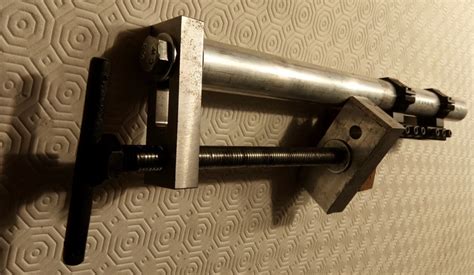

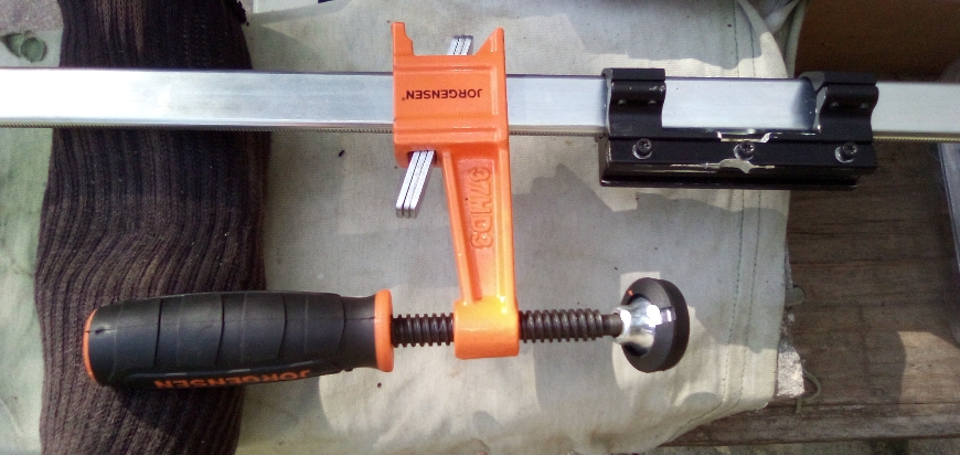

Heck take 3/4 a pipe style clamp thats 1"od pipe and mount it in a old scope ring. For 15$ + small length pipe . Got the sctew to comptess and mounts to the rail.. i dont know i guess some got more money then they know what to do with or the soon parted thing. I like ke keeping mine in my billfold best i can.

Check this i made up just now.. this clamps throat is too deep but thetes the pipe kind that's shallow and seem to line up with the receiver end
Like this one
The scope mount fit perfect on this beam type
A guy could have all he needs lieing around to make one for pennies or free.
