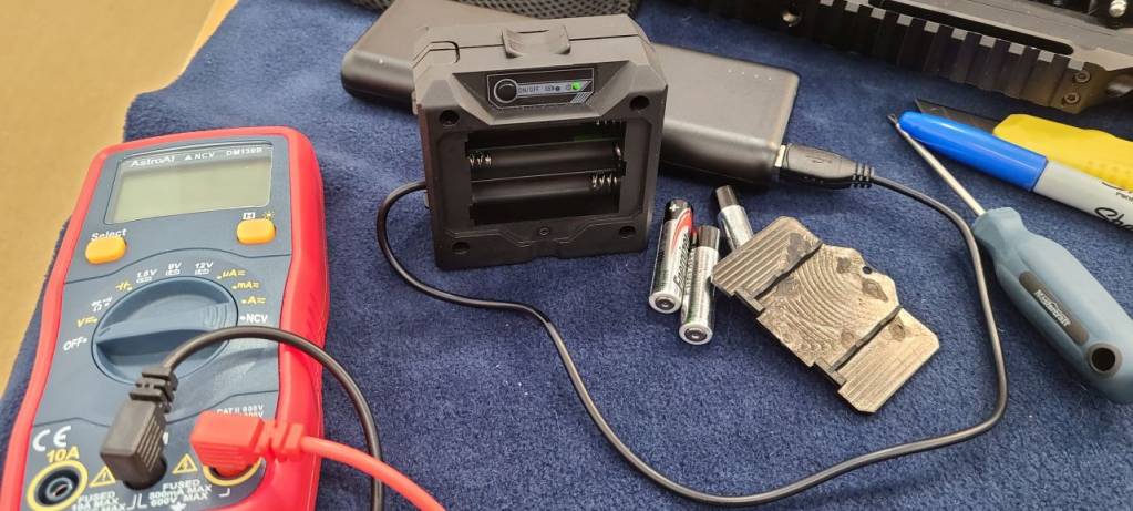

I could not find Li-ion in AAA size, so I tried this, without much luck. Even suspecting that, that hole from the side I just plugged with a cable have some function to do with the internal sensor.
Tonight I will remove the cable to do further trials.

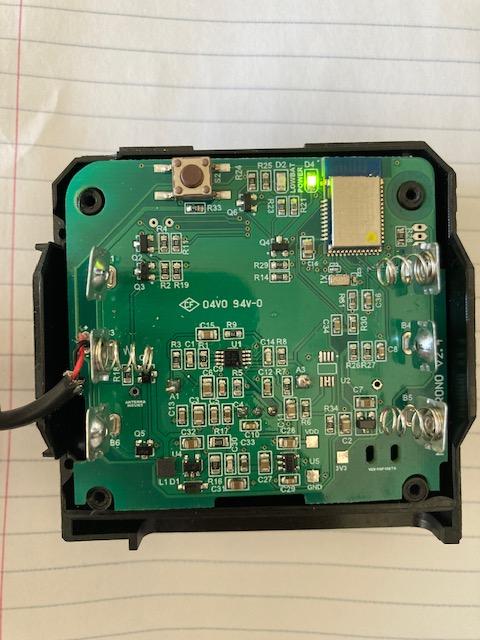

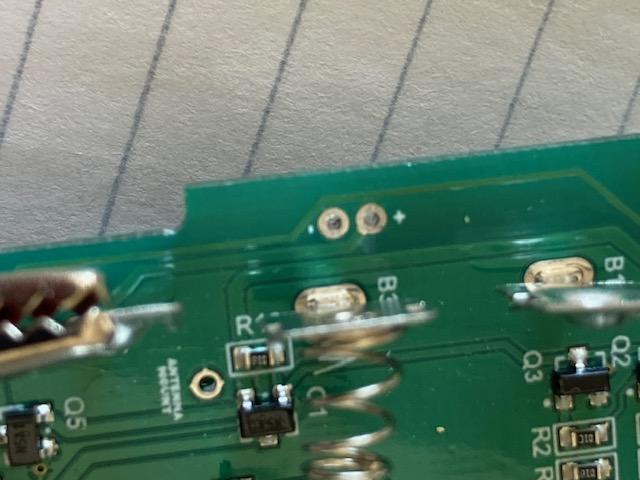

The hole in the side of the case is for placing a two-prone micro-connector that connects to the " + " and the " - " pads marked on the side of the circuit board right by the hole. These positive and negative input pads on the circuit board are quite close to each other so if you solder them be careful not to short them together. Or you can just run the 5V cable in there directly through the hole in the case and solder the positive and negative cable ends to the positive and negative pads on the circuit board.
Be careful when handling the open case. Do not mess with the front radar antenna because it's very very static sensitive.
Here there is an easier solution at the very end that connects to the existing battery pins inside the case and not on the circuit board.

Your inconsistent readings are unlikely from battery/voltage. The unit has a couple of voltage regulators, and as long as the voltage is above around 4.2V it should not mater. I would carefully check if the antenna board is properly seated in the 3-pin connector. At times, it may become loose (while you are there, also note the slight angle of the antenna)..

On the pic from earlier up that is an Anker powerbank with output of 5.1 V, was sitting in a drawer in between travels and trips and I just found a best use for it, but unfortunately the radar not behaving with numbers...
