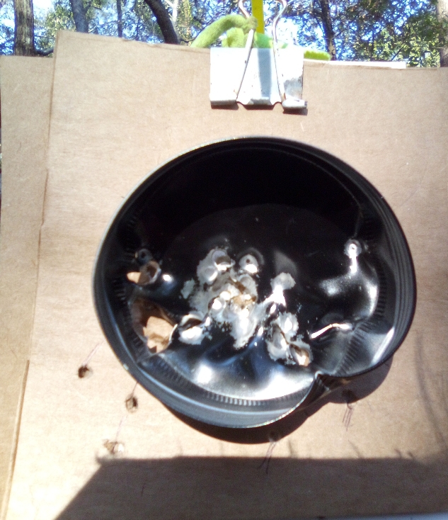

Speed aside i cant complain too much after that. It shoots and hits well .
After yestetdays clean and relube (using krytox in this). And a quick sight in heres the re- breakin shots . Just shooting 5 or so time to time through out the day at 50yards on stock irons and cphp .177. being slower and not as flat shooting it's just i cant use one sight adjustment for all ranges from 10m to 50. With little to no hold over / under. Just a bit too much trajectory arc now for my liking (??)

Man it looks like it’s shooting good. That’s all I need at the moment, a spring gun that’s easy to shoot. I’ve never gotten exceptional accuracy with mine because it’s pretty hard to shoot with the recoil.
