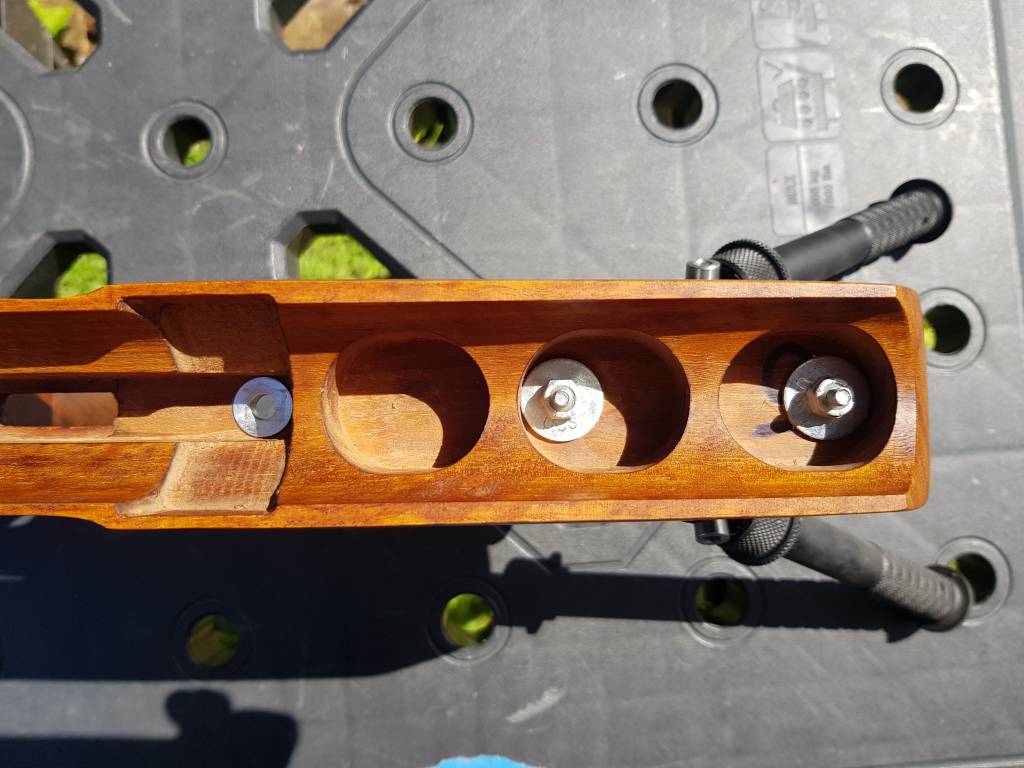

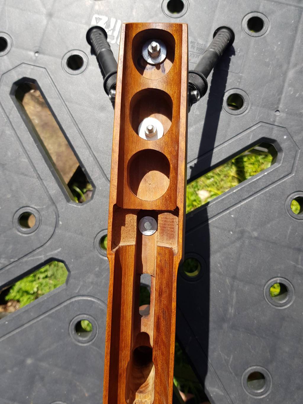

Here's a pic of the inside of the R5M Standard stock if you need to get an idea. If you need any other pics, let me know.
Peskadot671,
Thanks for the comments😊, and pictures. I actually have a r5m. I always meant to check out the possible fit with the Lelya before I got a wild hair and sold it.
