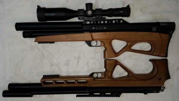

Just noticed something else neat about the R5M... because of the way the R5M action is designed, Ed was able to shorten the rifle by 3.5" without giving up barrel or reservoir length. Here's a pic of the .25 R3M long next to the .25 R5M long. Note how the magazine on the R5M sits further towards the butt than on the R3M.
