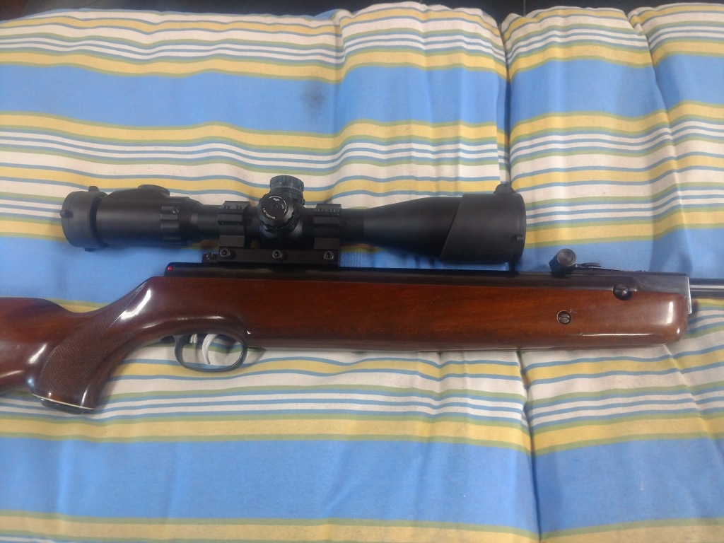

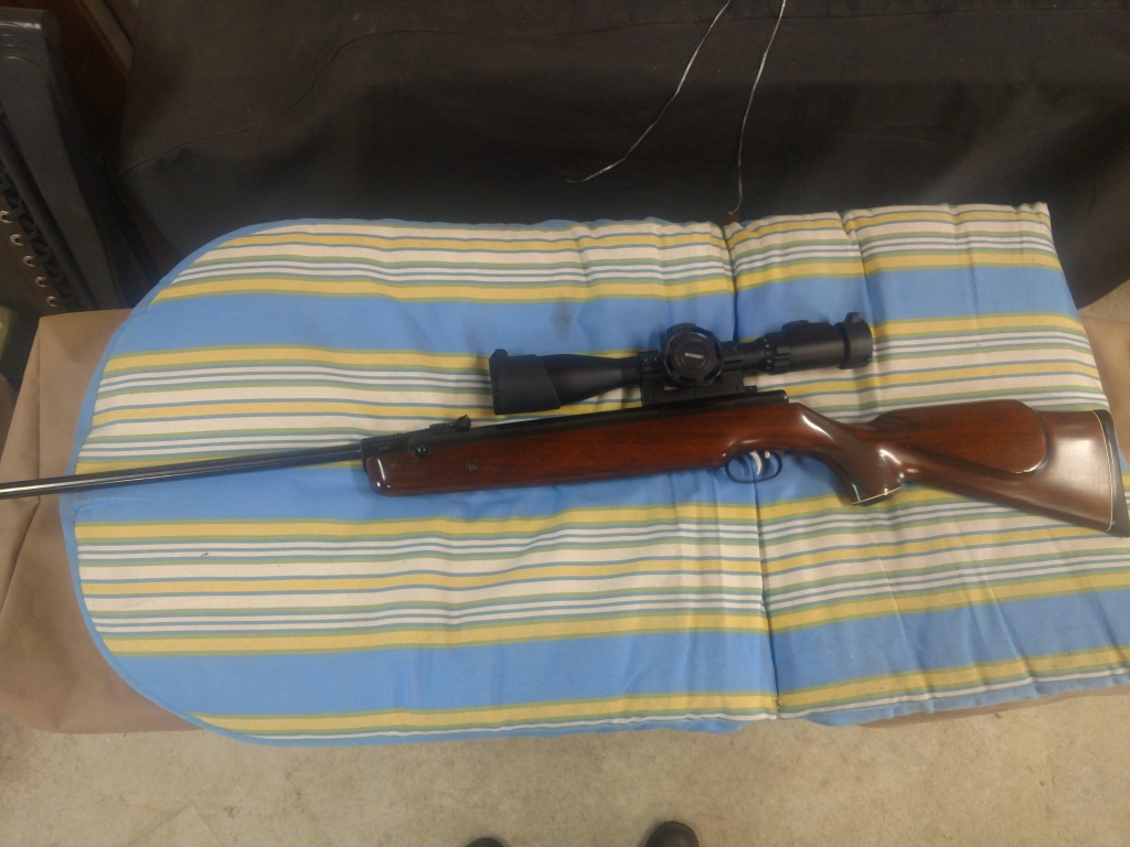

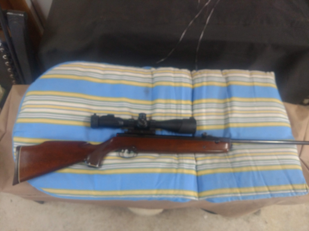

Here she is. Sorry for the not so wonderfull photos. My first air gun was a sheridan blue streak .20cal. I was 16 when I got it. My older brother growing up lost an eye playing with his bb gun. No way was mom and dad going to allow me to risk losing mine. I was born with sight in only one eye my left. This is why I shoot left handed. Thanks for looking. Barry

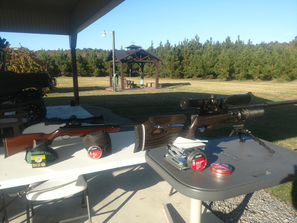

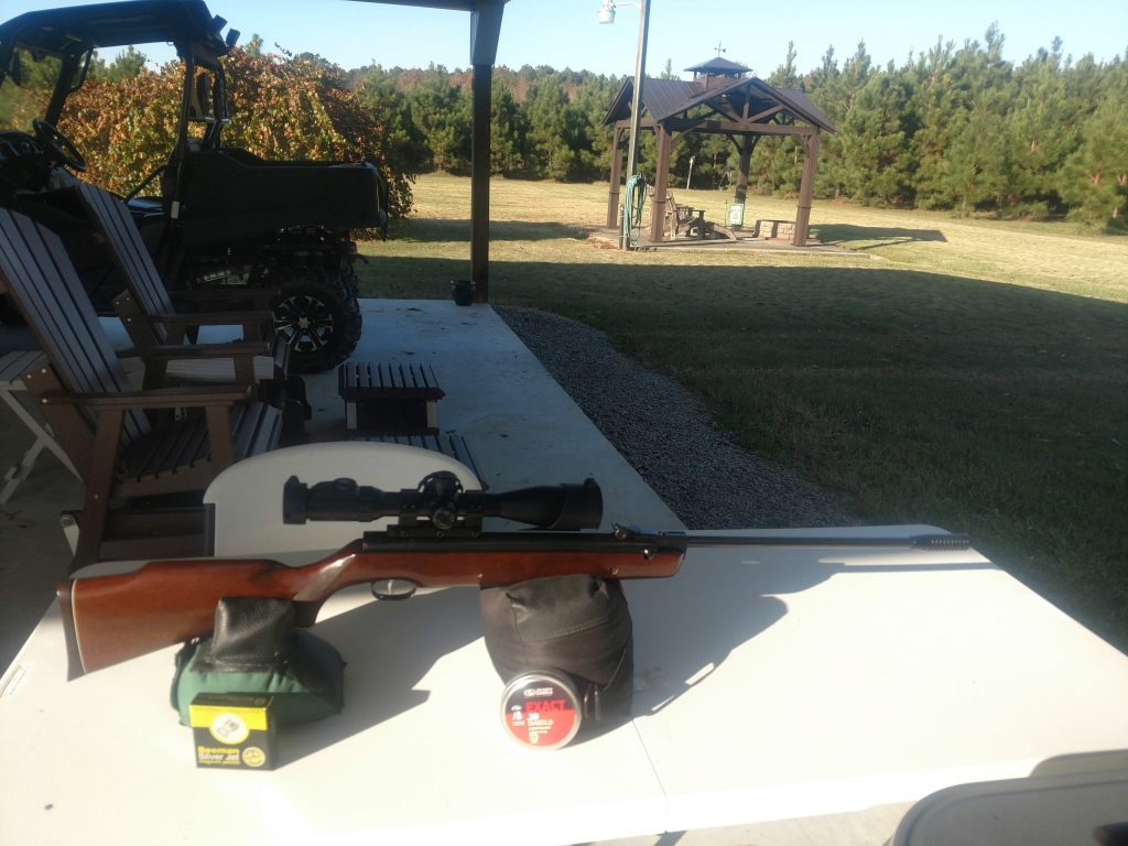

Mine always liked the silver jets the best. I bought a whole case the last time I ordered. (Long,long,,long, long time ago. I had the raw .25 out today and also shot the R1 with jsb Diablo 13.73. The R1 is actually louder than the.25 raw. I am surprised. The Beeman was built like a tank, it is a very heavy gun with a very nice and light trigger. It has been quite windy here today trying to get it sighted with the jsb's. Thanks for the interest and sharing your Beeman's. Barry
