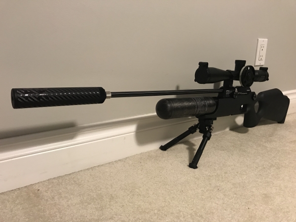

Here is my 22 Crown without the shroud. A DIY LCD with carbon fibre wrapped over an airsoft moderator. I got better POI than with the shroud on. Very quiet for an FAC.
1543714635_17104342515c03374b1a7076.48419640_A801729C-7C46-4758-B169-89F939008400.jpeg
Bob, does this make the barrel more flexible without the support of the shroud?
The shroud on the Crown is supported by the barrel, not the other way around, so it should be better, all else being equal.
My shroud caused a relative loss of accuracy regardless of configuration, so I removed it altogether and put a Weihrauch on the end. Just as quiet as with the Weihrauch attached to the Donnyfl adapter on the shroud itself, so I'm losing nothing. The looks are a personal thing I guess but I like it. I also removed the bit that Bob left on near the action so no naked threads are there to look unfinished or get damaged.
Matt Dubber has done the same on his Crown with a Huggett now. You can see it on that recent collaboration with Air Hunters
