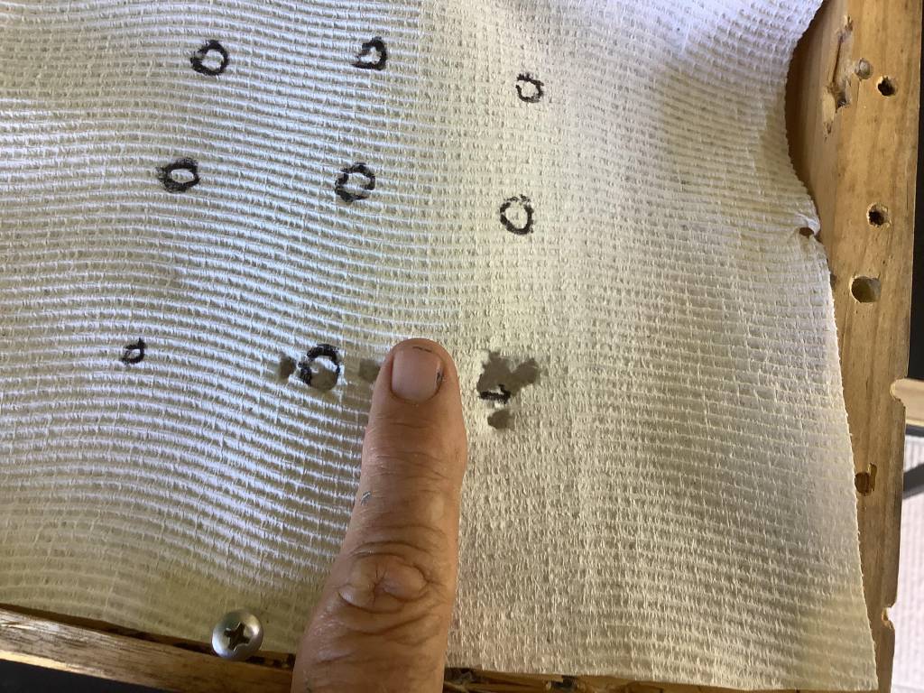

Qball after my post I was thinking of using absorbent paper. It’s soft and you can draw circles with a felt pen. It shouldn’t be louder then the photo copy paper and with a pellet catching box full of compressed old clothing it should be really quiet. Tomorrow I’ll have she who must be obeyed stand next to the target (Safely) and fire a couple of shots at photo copy paper and absorbent paper. Will let you know outcome.

Qball on the left 3 shots with my Hw77 22 cal shooting H&N 14.65 gr ( not the best pellet in this rifle) On the right 7 shots from my HW50S 22 cal shooting Barracuda Green 12 .65 gr. All at 25 metres. I also put a few pellets through photo copy paper. Wife reckons no sound when hitting the absorbent paper and it seems to hold up well. Maybe someone with a sound meter could chime in.

thanks Gary! I tried a few shots with napkin and paper towel yesterday and found napkin with smoother surface being better visually but both basically silent with no sharp snap from printer paper. Also like you I’m going back to old clothe because it is quieter than rubber mulch, the combo of old clothe and napkin has been near silent!! It’s so silent i can hear pellet fly……another problem can only be solved by 450fps? LOL

thanks! Will have to look into it. So far I have had good luck with old clothing and paper towel. Paper towel is 100% silent with absolutely no snapping sound like printer paper. The pellet does make a slightly bigger hole than printer paper target sometimes but I’m ok with that. the problem now is I hear the thud of pellet hitting the compacted clothing, not loud or that noticeable unless it’s pin drop quiet out in the yard but I rarely shoot during that time. I have tried different clothings, soft materials like fleece, sweaters and old tshirts are the best and jeans are the worst. Now I used jeans in the very back and use mostly old cotton T-shirts layered with fleece.
paper towel has been very economical and easy to replace. Costco bulk paper towel with amazon bulk painters tape make fantastic combo that is super cheap. When I have time I will go through a few targets an hour.

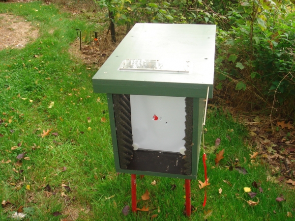

This is my pellet trap ; a wooden box 8"X12"X20"long , with a removable lid. The inside is covered with acoustic foam and filled with sandbags. The target is kept in place with magnets against a metal frame , about 4" into the box. This setup is good to stop .30 cal at 50 yards , but I usually shoot .22 . I can still hear the impact of the pellets because, of course , I'm facing the box when shooting ; put when I stand 30 yards aside , the noise is almost completely down. I also spend a lot of time to experiment different ways to improve factory moderators ; sometimes it works , sometimes it doesn't .....that's life😉.

Very NICE!!!! I've been thinking about building a bigger box like yours so the sound is immediately blocked by the side wall. Great idea on the acoustic foam! Gonna have to do some research and build two much bigger weather proof boxes like yours!

How much trouble do you have keeping the sand inside the box? How often (shots) do you change sandbags?
@rc4fun : I use plastic bags , the kind to keep food in deepfreezer , filled with sand and closed by a zip system .I put four of them , 2 on top of each other on 2 rows. Bags are changed after 200-300 shots . In fact I'm looking for a more "reliable" stuff , rubber mulch or something more dense which wouldn't need to be changed so often.But sand is so inexpensive.....
qball that acoustic foam seems like a good idea. You can buy adhesive rolls on eBay dirt cheap. I was thinking if you are going to build a new box what about having an extension on your the front of your target box that is hinged, say about 1 third of the length of the box so it can be lifted up to place your targets. The hinged section can also be lined with adhesive foam. It may act as a moderator. No radiated sound. Just thinking 🤔

Thanks. I use rubber mulch and 1/4" bird screen like @bigragu. You definitely need space for the mulch or sand to leak into or it will just spill. I bet The sand is a lot easier to sift the pellets out! I push it to about 800 or 1000 shots before hitting the back stop or having mulch leak out when changing targets, then the screen needs changed. I use 1/8" foam packing sheets with the target stapled to it and ditto with magnets. I've only ?sifted? pellets once so far after 2500 shots and then just to see what it takes.
