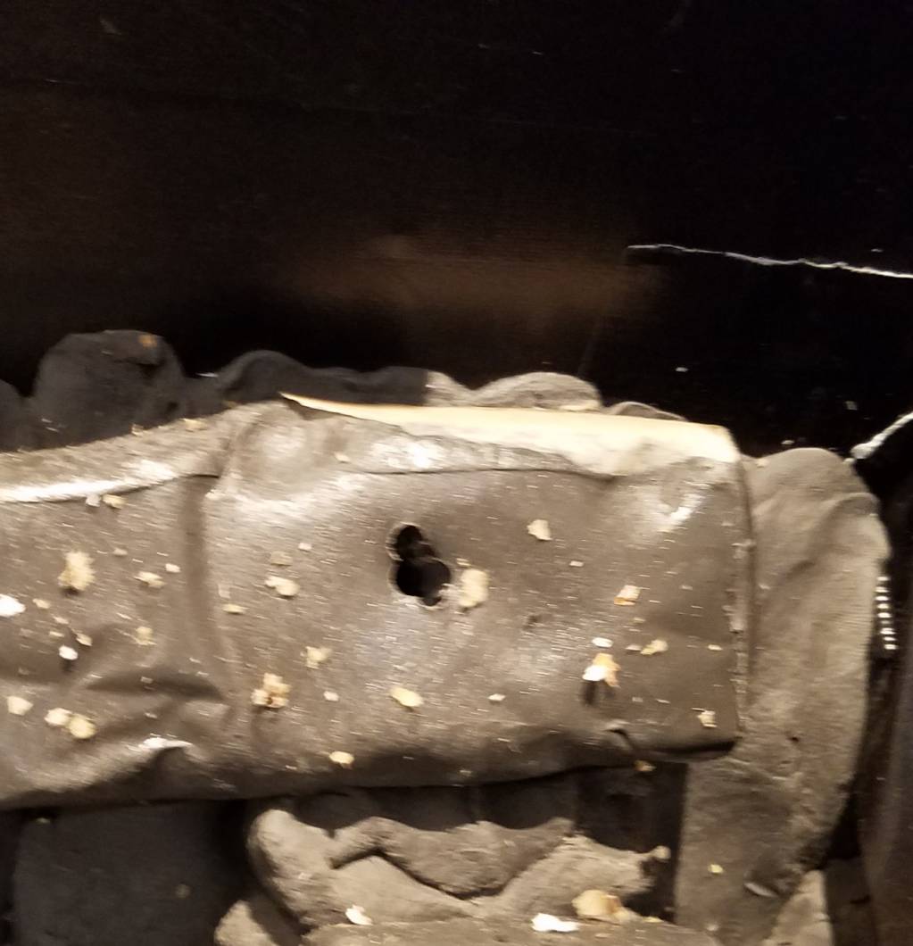

Up until a day ago both of my target boxes are filed with old clothe with duct deal behind it just in case. The problem has been the snap sound of the printer paper, I tried everything and only worked was taking it directly onto duct seal but that’s a hassle to put on and remove then have to constantly pluck out pellets from the duct seal.

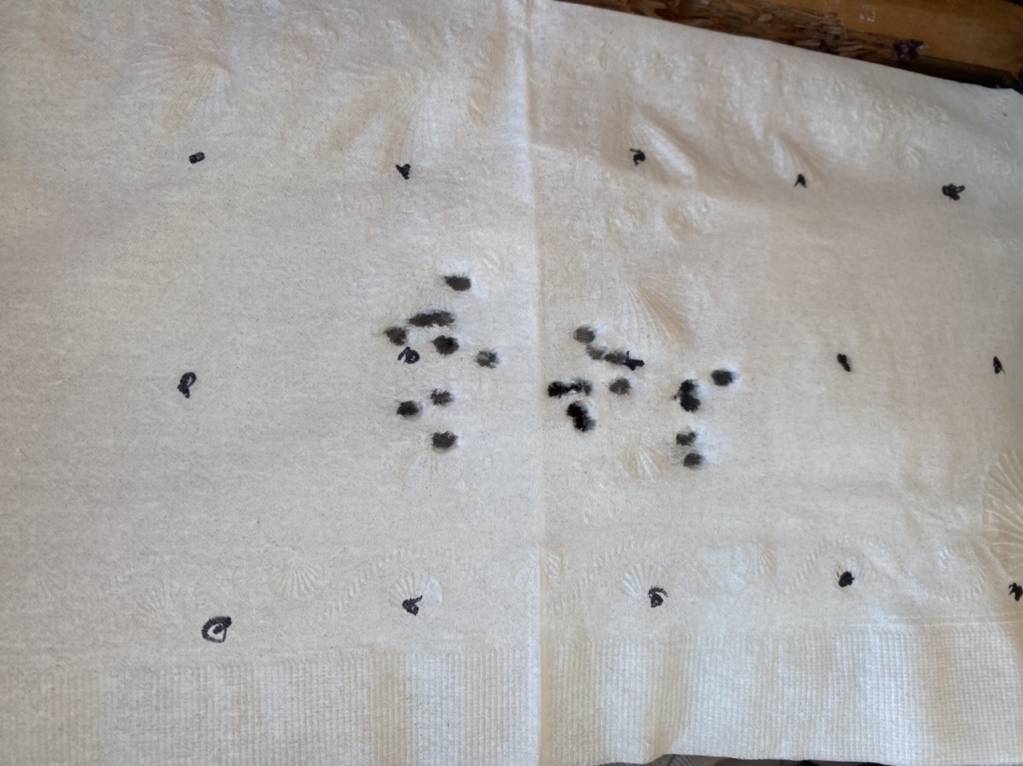

After some testing I think I found at least a temporary solution, fancy napkins. Fancy napkins have nice and flat surface which makes POI very easy to see and they are completely silent. How do I know? I shot at the paper and then then area isn’t covered by paper and the sound is the same. No more that sharp snap sound! Think as long as the paper doesn’t make crumbling sound it should be silent.
This obviously pushed the problem to the backing material as I can still hear a tap sound, lower in tune and volume but still pretty audible so I think I’m going back to old clothes because that was very quiet. Basically silent if I put soft clothing in the front. Not really happy with rubber mulch performance.

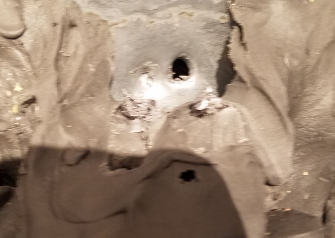

by the way...PSA: that duct seal i quiet, but it doesn't work that well if you stack pellets on top of each other.
8 shots in about 2.5 seconds. if you slow down to .25 speed, you can see the shake of all 8 hots.
started hearing it about shot 4 but kept going for the clip. went through 22ga steel sheet.
