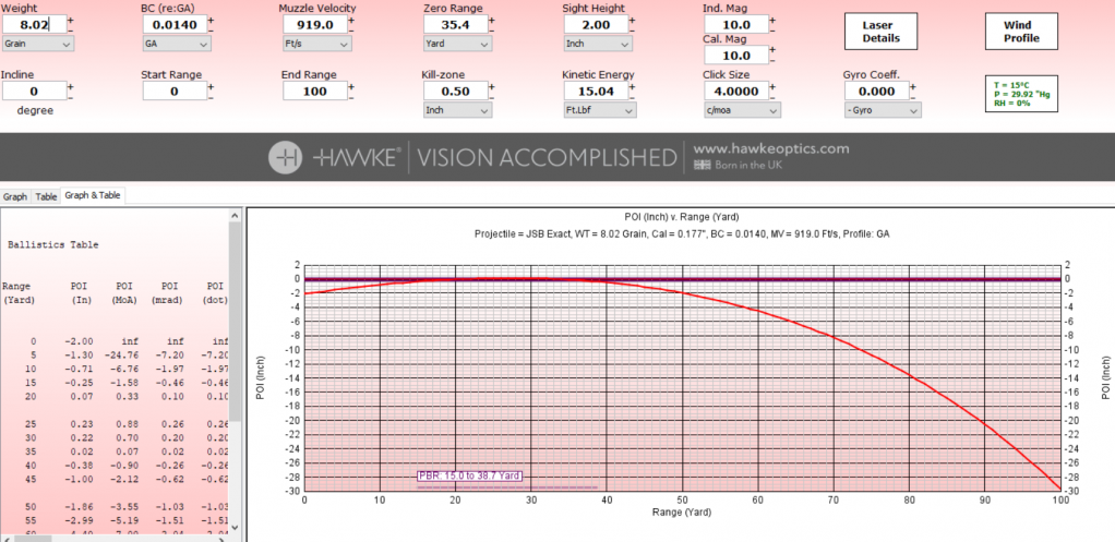

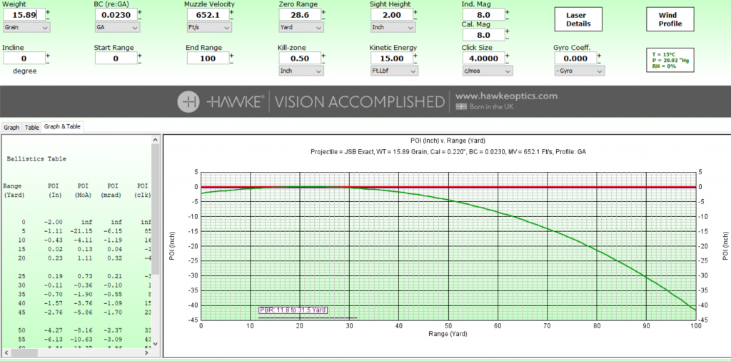

I have some free time this morning and entered some numbers in the desktop version of Chairgun.
I used a 1/2" kill zone and a 2" scope height for both 177 and 22.
I picked Polymag shorts for pellets as I believe they are considered good for crows and people certainly use them for squirrel. I picked the shorts as the regulars don't always fit in magazines.
I used 15 FPE but have no idea if it's sufficient for crow.
Please note that scope height will likely be different between a traditional rifle like the HW110 and a bullpup like the Taipan.
With a kill zone of 1/2" the 177 will be 1/4" low at 17 yards, 1/4" high at just over 25 yards and a 1/4" low again at 38.7 yards.
In other words, the point blank range (PBR) will be 15 yards to 38.7 yards for the 177 with the details I selected.
The PBR of the 22 Polymag short will be 11.8 to 31.5 yards. At 35 yards you would be 0.45" below your kill zone.
In my case I prefer to have my pesting rifles set up so that my closest shots are within the PBR. The reason being is that it's these shots that I often have to take the quickest so I just want to aim and shoot.
In your example if I knew I'd have shots between 12 and 15 yards I'd prefer the 22 slightly over the 177 and I would just holdover for shots at 35 yards.
But if quiet was the premium and 177 was quieter I would choose the 177. The 3.2 yard near zero distance difference would be no big deal.
Back to scope height. Sticking with one caliber, I'll choose 22, if I lower the scope height to 1' the PBR changes to 6.2 to 26.5 yards. If I raise it to 3" the PBR changes from 16 to 35.3 yards.

If you will be buying a US spec, or FAC power level rifle, they will have very similar trajectories, but the .22 will have almost twice the fpe. If you shop for a 12 fpe rifle, which is common in Europe, then the .177 will have a significantly flatter trajectory. If you are firm on wanting one without a moderator, then a 12 fpe rifle in .177 may be your best option, and the power is adequate for hour 35 yard squirrel scenario.
