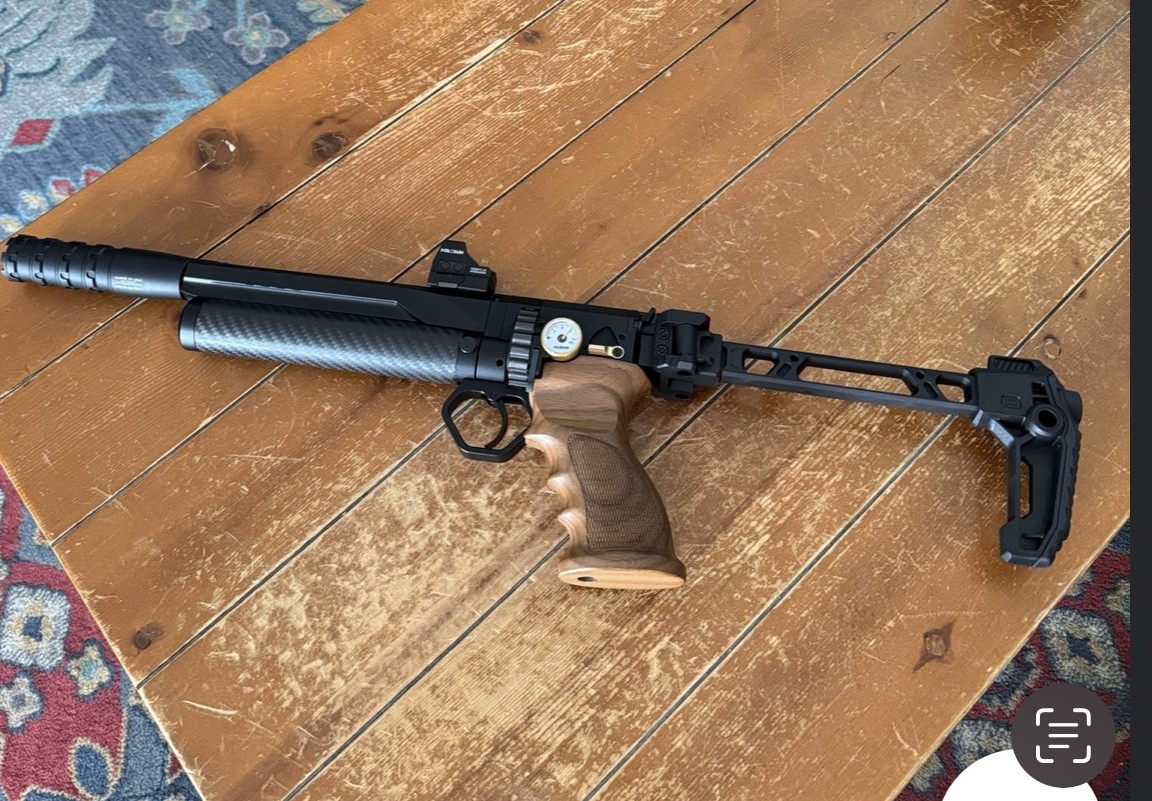

Hey all, I’m looking for some mod recommendations for the Huben GK1. I’ve got mine tuned for 1 mag, ~45 fpe and the buck rail mod I’m using currently isn’t really up to the job at this power level. Width is an issue here to not block line of sight, length not an issue at all. The combo of short barrel, high power, and shroud instead of direct barrel attachment makes this tricky, so I’m all ears to any advice. Thanks!
I use an Impulse Air 1200 .22 for my GK1 .22. Looks and works great!

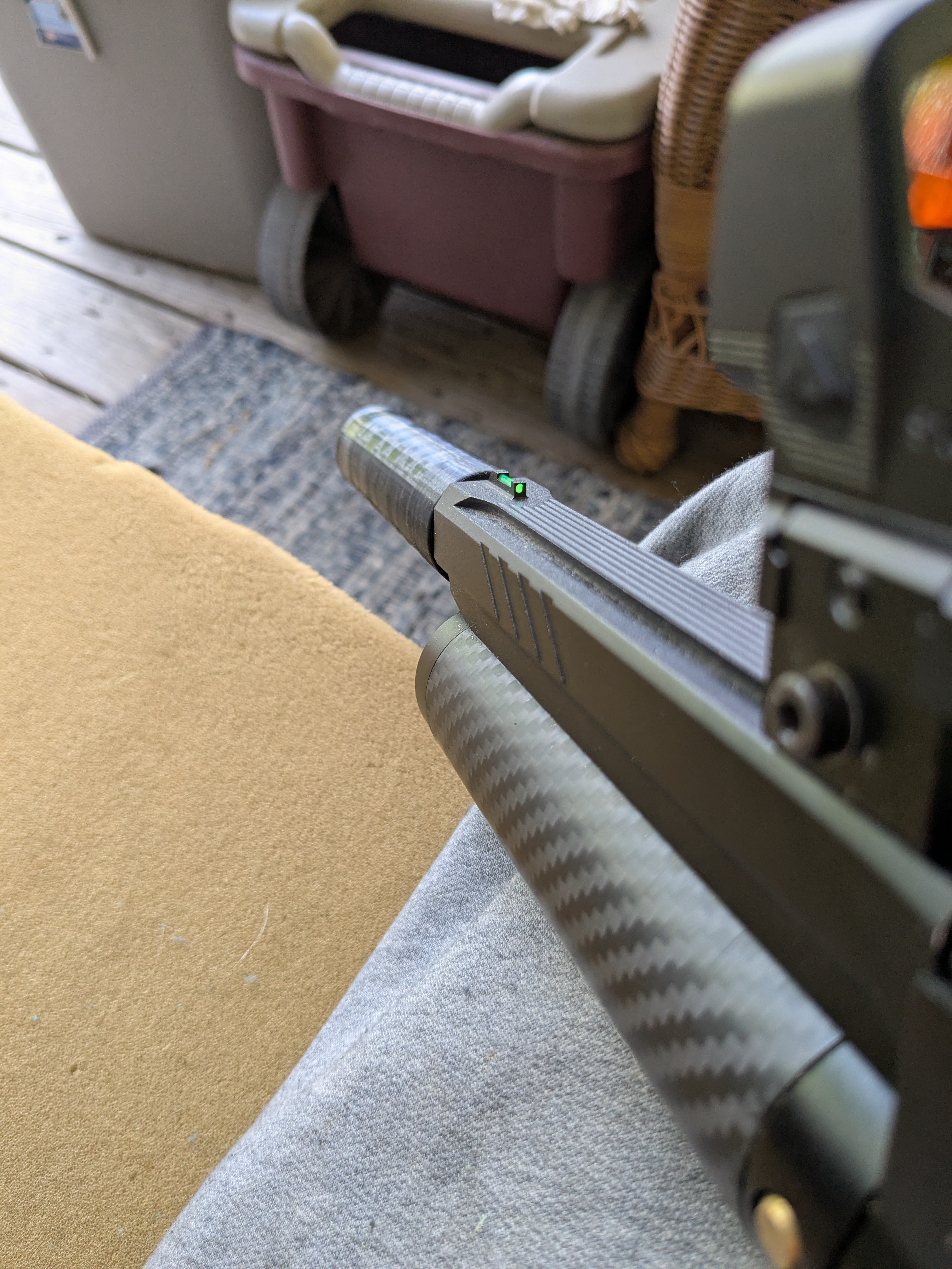

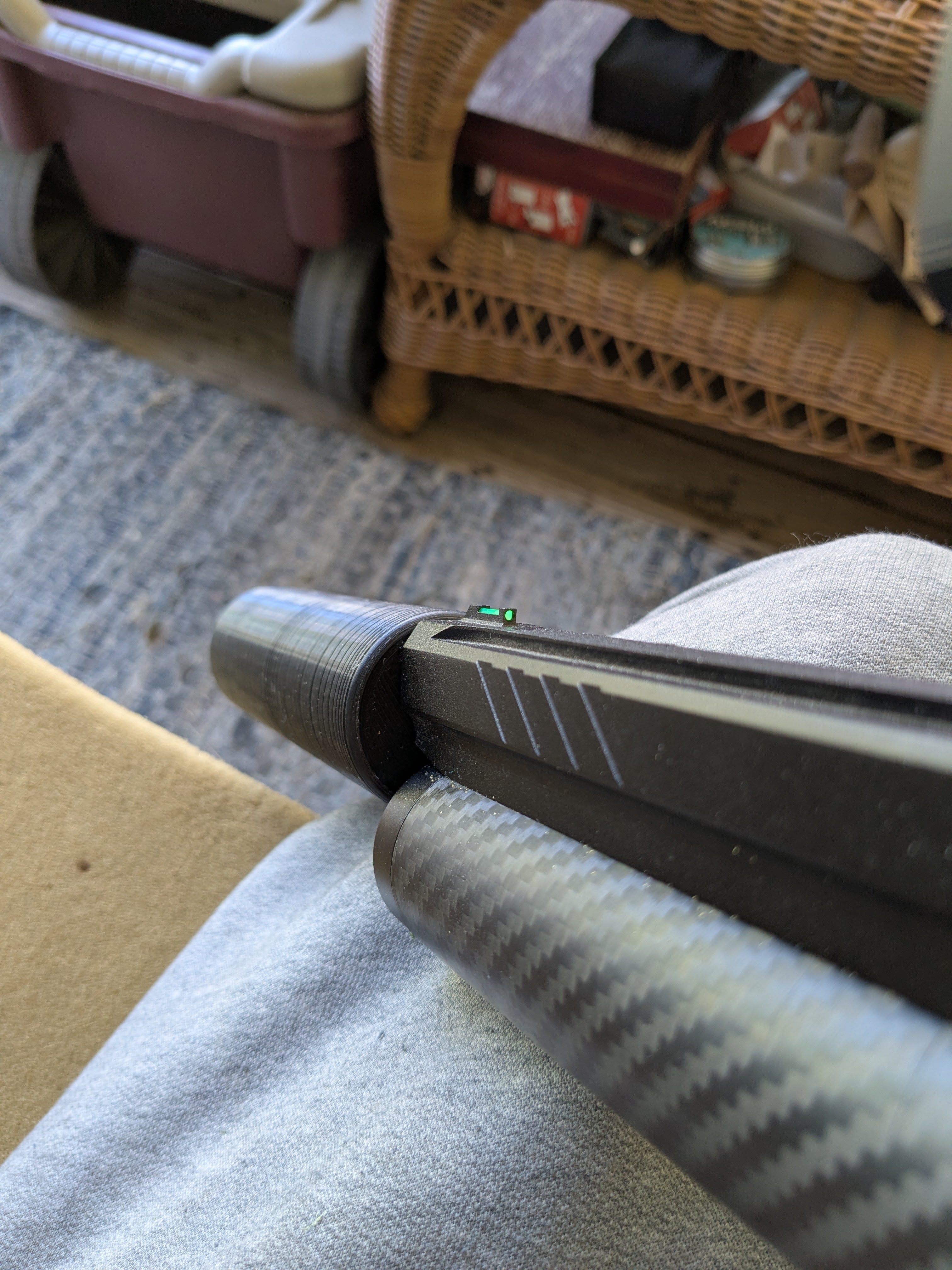

There was a 3-D printed design from a member here, "subscriber" that handled the problem with the front sight by being asymmetrical, with a larger volume below the centerline. Baffles were designed in such a way as to minimize asymmetrical airflow experienced by the pellet, a pretty well thought out design. It must be in one of the GK one threads here, I will look for it and if I find it post back here later. Perhaps @subscriber will be online here and chime in. There was another member who was printing these designs for a fee. Reports on their performance were all very positive, and they are available in several different lengths.

I have printed many moderators from mono, to all sorts of baffle designs for my air guns. Petg is best with 4-5 walls and 40% infill. I will be printing “subscribers” and excited to see their capabilities.
From the reports, these are better than what I have tried and that is fantastic.

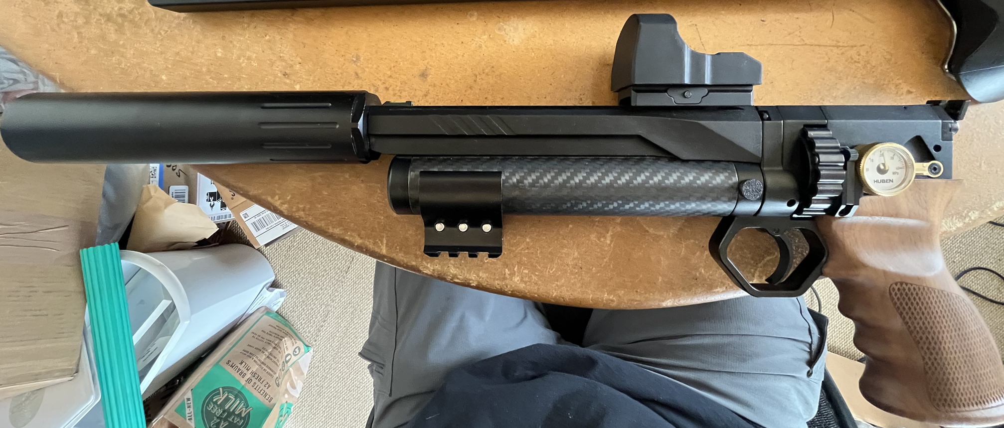

For now, The impulse air 350 is the best I have used but requires a dif sight. I am using holosun 507c so no biggie. If you want to tame it further you can add an extra baffle or two. My DonnyFL tanto and fatboy 2.0 are nowhere near as good as the ia350.
