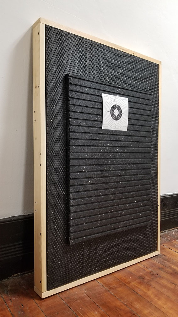

For my backstops, I use something called "Stall Mat"
It's 3/4" thick rubber, but, I've only seen it come in Big sheets..
Tractor Central Supply is where I get mine..
A 'spinner' could easily be made by using little chunks of this stuff..
Thread it onto a rod, bolt it onto an existing metal target, etc.
It takes some Serious abuse, and it's relatively quiet when impacted.
I whack the stuff with .22 cal non stop and have gone up to .25 cal
I used to double it up, so in that frame, there's 2 layers.
Then after blowing through it with .25 cal,
I add a 3rd layer now - Just to be 'safe'. lol
